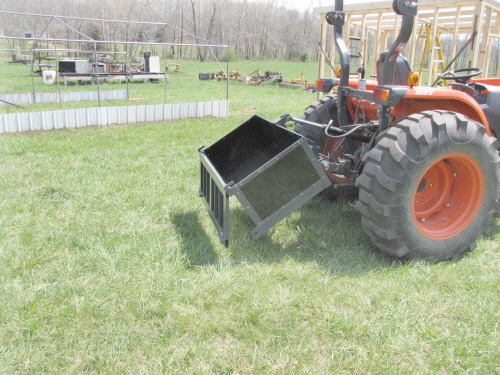

I have the 2X16 and it works good. Look at the picture and you can see on the front of the box there is a kicker sticking out. The cyl just hits that when dumped all the way. If they made a 2X14 it would of been just right. My top link pin hole is at 16" and it should of been 17", that would of made it not to hit and give me a little more tilt in.
