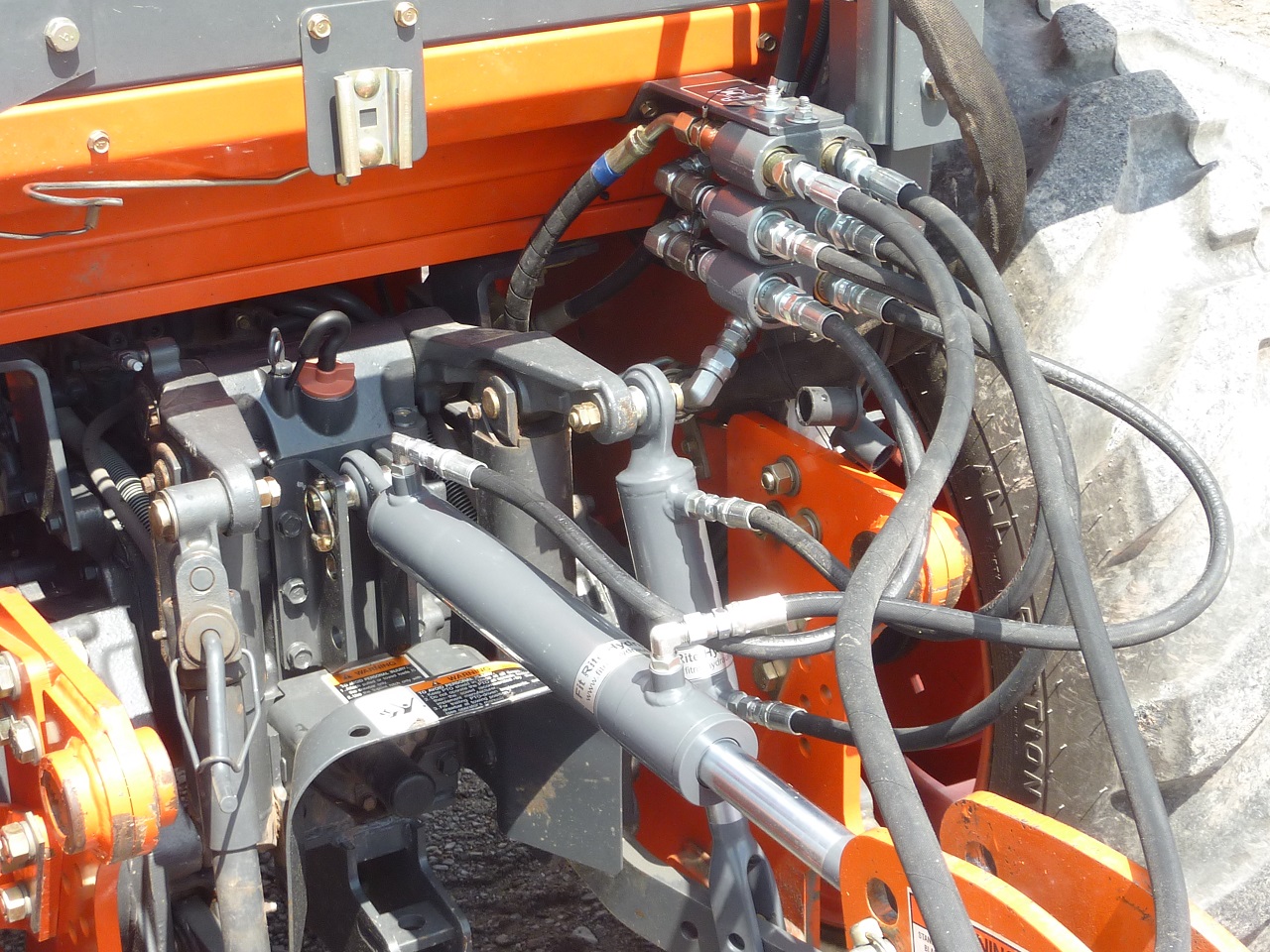

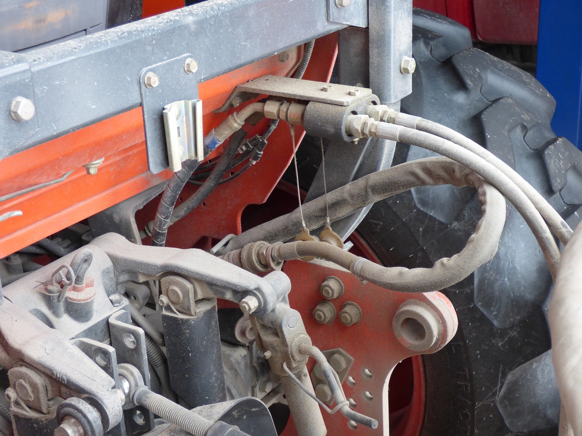

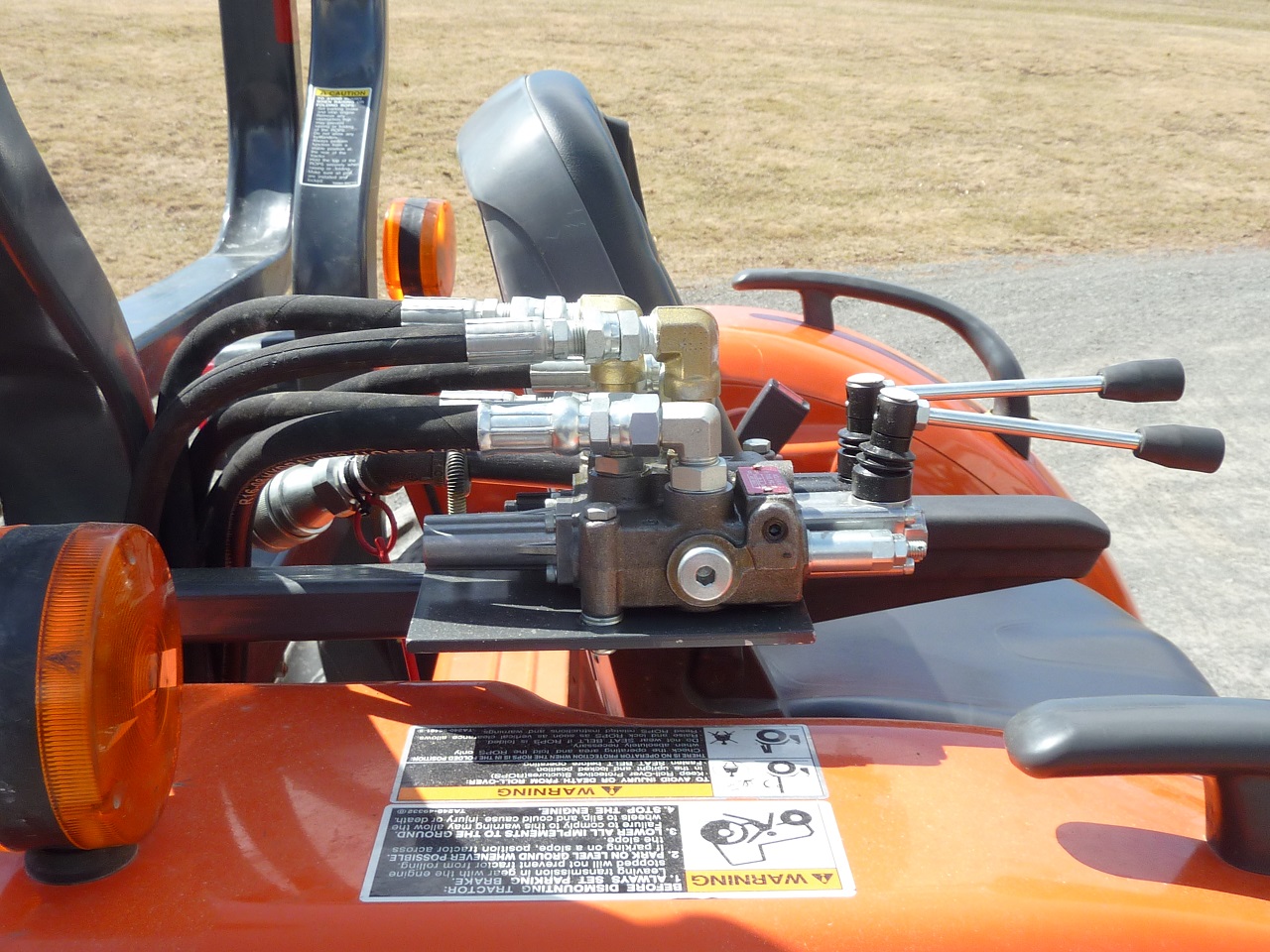

I had a L3430, similar to your L3830, with backhoe and one rear remote.
I added 2 more remotes for a T&T kit by connecting to the backhoe hydraulic circuit using a Prince FEL valve and OEM connectors. I mounted the valve over the right fender on a bracket bolted to the ROPS.
View attachment 543461 View attachment 543462
The valve and QR connector project cost around $500. I got the T&T kit from Fit Rite Hydraulics.
