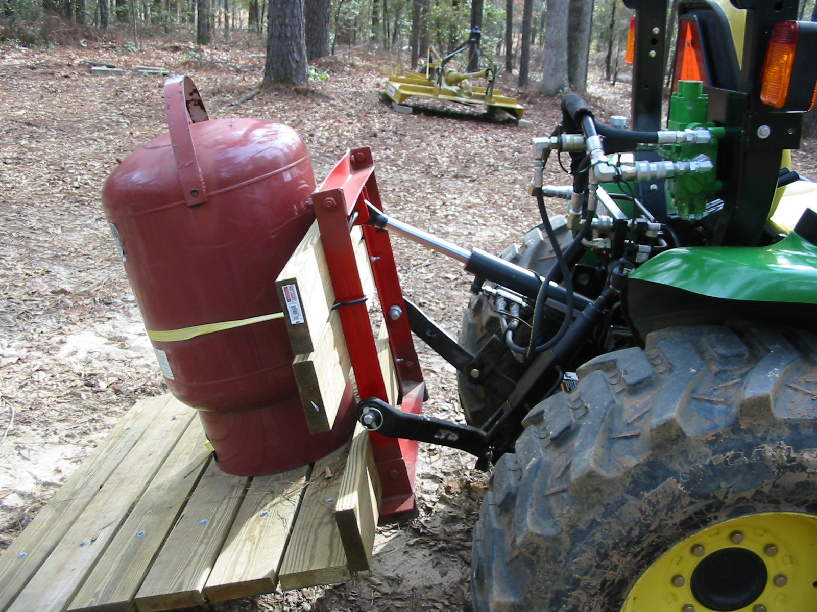

Attached is the max dump angle I can get with my HTL and the carry-all. It tilts enough to assist with dumping most stuff, but would not clean the deck so to speak.
My HTL does not extend to the OEM specs, and with my particular cheap eBay carry-all I believe I could extend it several more inches without hazard to any equipment. So you just got to look at your particular setup.
