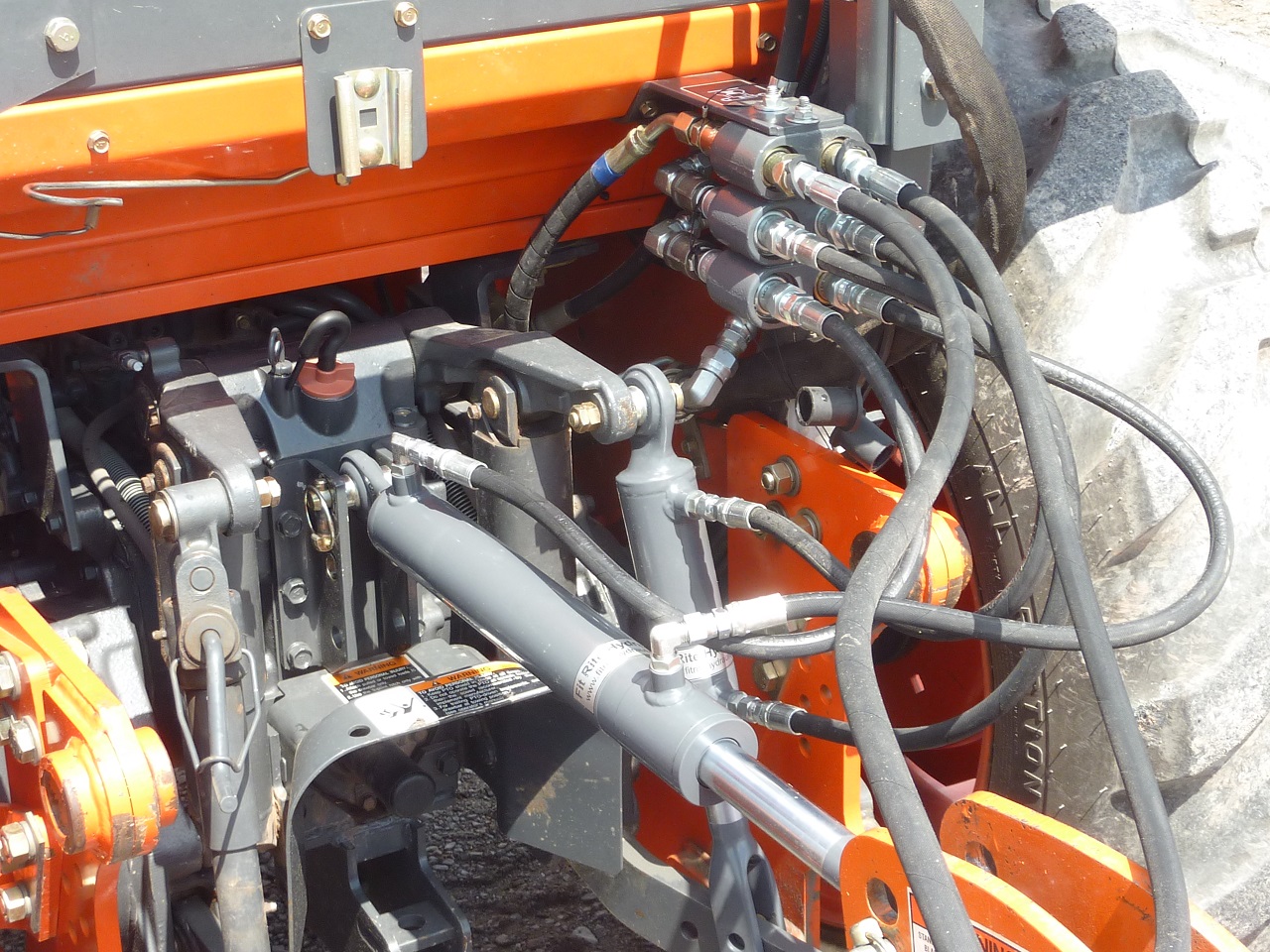

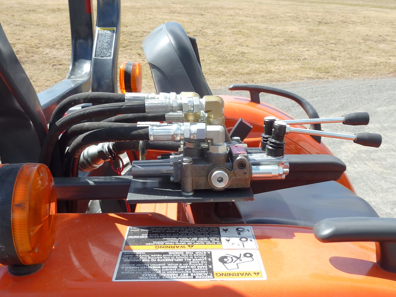

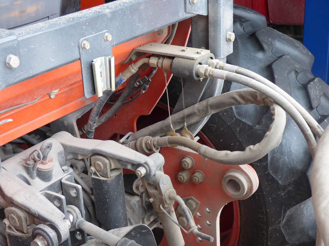

I had a L3430, similar to your L3830, with backhoe and one rear remote.
I added 2 more remotes for a T&T kit by connecting to the backhoe hydraulic circuit using a Prince FEL valve and OEM connectors. I mounted the valve over the right fender on a bracket bolted to the ROPS.
The valve and QR connector project cost around $500. I got the T&T kit from Fit Rite Hydraulics.

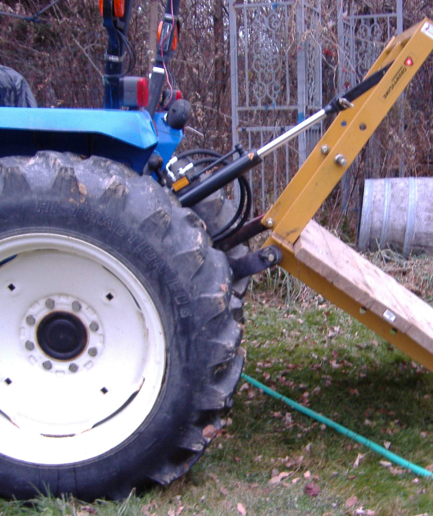

I made my carryall into a dumping carryall by lowering the lift arm connect pins to the bottom corner (drilled 2 holes). I purchased the longest top cylinder I could find, and I made some bracket extensions for it to increase the reach. It works well.

I just looked online for a cylinder. I was pretty clueless, and read a lot. This cylinder is close to what I got. 11" reach. They give you a measurement of it closed and open. The reach is the difference of the two measurements. The closed measurement is what you use to check if you have enough space to mount the toplink between your tractor and implement.
With it fully extended you measure to your implement to see how long the brackets have to be to close the final distance. I used 2 paralell 1/4" X 1 1/2" flat stock pieces drilled for the pins. Chain would work too, but I had the stock. The brackets always have tension on them, but they can rotate around the pins. I take the brackets off when I am using other implements besides the carryall. The hydraulic link is always on - use it with hiller, tiller, etc..
The hydraulic coupler to put on the hoses had me stymied. All new to me. I measured what I had and looked at pictures.
When I went to attach everything, I couldn't get the couplers to seat, until I disconnected the hoses from the cylinder (relieved pressure?), then I reattached the hoses to the cylinder.

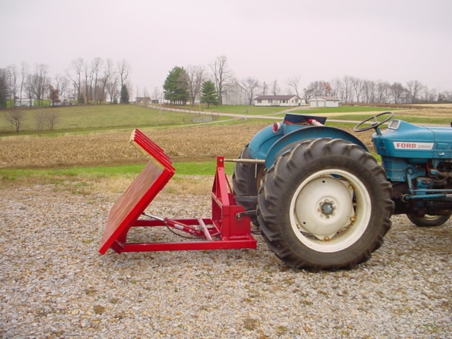

   / Hydraulic dump for Carry-All?? #38

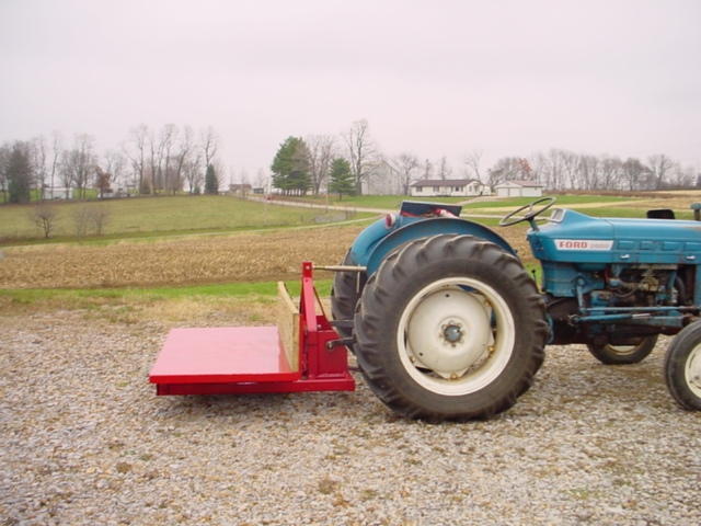

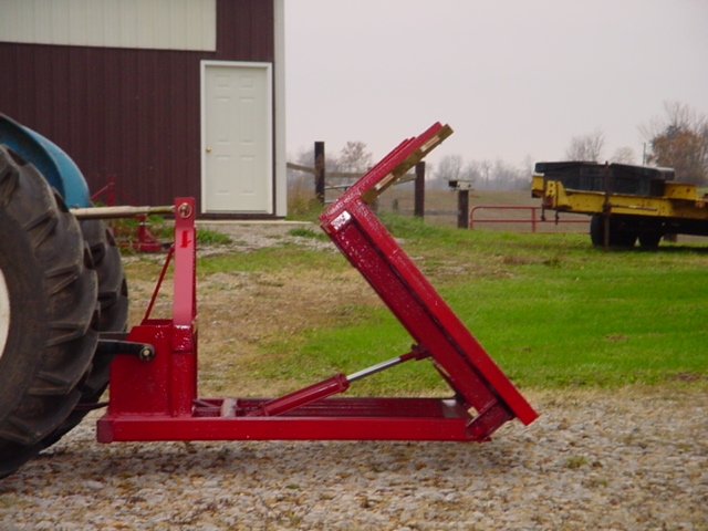

I built this one I'm thinking 10-12 years ago. Still use it every now and then. It's been a handy piece to have. I used it a lot more, than what I intended it for. Deck is 3' X 6', pretty sure it's a 2" cylinder. I got my measurements for placing the cylinder attachment points, by measuring the cylinder points on my 1 ton dump truck, and downsized to match.
The heaviest load I ever had on it was bankrun sand & gravel. I used it on the back of my Massey 180 for weight, when rolling the pad for my buildings. Just backed my dumptruck up to it, and dumped part of a load on it. Whatever stayed on, is how much was on there. Guessing near 1500 lbs. When I was finished, I dumped it off, and it dumped at an idle on the tractor. I have a cylinder for the top link tilt, so a tractor needs to have dual remotes for this to work. Nice to pitch it ahead at times to keep what your hauling, from dribbling off. Anything from firewood, spot cleaning horse stalls, and rocks out of the field. I didn't put any end sideboards on it, because I also used to haul fence posts, when building fence.
If I shovel on a load of dirt, or manure, it's time for a break anyway. A person could modify one, to suit their own needs.

http://www.tractorbynet.com/forums/customization/392162-earth-mover-ballast-box-dump.html
This links to the pictures. The box is 4' x 3' x 1' and made of 3/16" steel.
