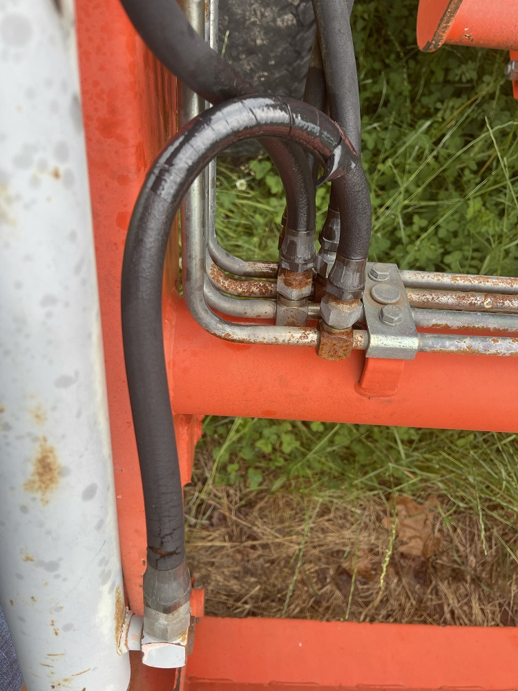

My old man has a B7800 a lot of the hydraulic hoses are dry rotted on the front end loader one is leaking pretty bad are they very hard to replace? Does anyone know the size of them 3/8 maybe?
The ones at tractor supply look like they have a different fitting and i'm not sure how much the length matters, like if you replace one that is 2ft but use a 3ft.

Remove them and take them to a tractor dealer, auto parts house or hydraulic shop where they make hoses. Hand them to the guy and tell him you want new hoses. They will make them to length with the correct fittings.
This. My local NAPA does hydraulic hoses for the same, or cheaper, than you can order them usually.

Yes, take them to hydraulic shop.
FWIW, heavy truck and equipment dealers make their own in house. They also have a plethora of fittings too.

I replaced mine from surplus center and they are JIC ends. Was very good price. Napa around here is about 3 times the price.

Perhaps not the best choice for someone that doesn’t know what size or style of hose or fitting he is looking at. Half price hoses are full price the second time around after double the wait. Most local suppliers build hoses while you wait. Incorrect custom ordered hoses will be the buyer’s to keep.

This sounds like the best option. Wonder what kind of price range they will be in? Couldn't they use the original connector to save a little cash.

All good recommendations for taking the old hoses to a shop, and requesting new ones. Rob 80's thoughts about re-using the old ends won't fly. Keep every fitting you can remove with wrenches, but beyond that you will need new. Any time I have suggested a shop retain an existing component, the response is the same you would get if you went to an oil changing place with your own oil. It is OK to be frugal, but given the life-span of a hydraulic hose that is not damaged, even expensive ones are a good investment.

The hoses I have got from Napa and auto parts stores are nowhere near the quality from surplus center or hydraulic shops. Basic hydraulic hose vs tuffguard gates hoses that last longer in a tractor environment. Some of my Kubotas have had special ends including British pipe thread.
Replacing hoses is not all that complicated and op might learn new experience and skills to be the next expert.

You just need the hoses. they are made with threaded ends. You can reuse your old connectors. BTW connectors arnt that much more though.
