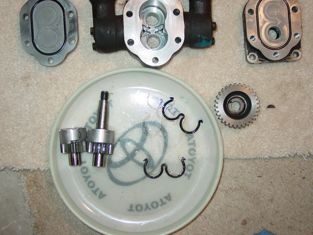

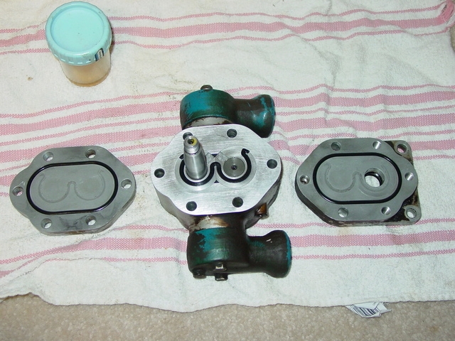

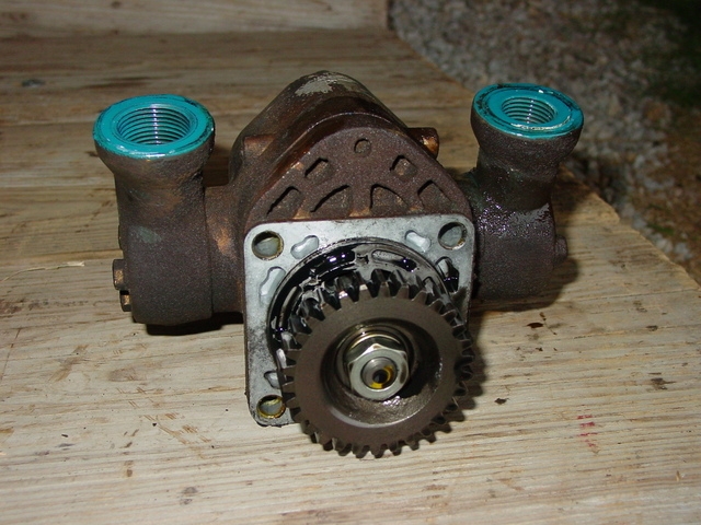

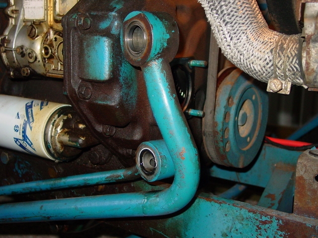

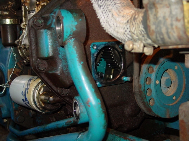

No. It is pretty easy but you need to be careful and not rough with removal. I have a few pics below FYSA. For just shaft seal replacement you do not need to do pump disassembly but you do need to remove the pump. You need to remove the nut on the shaft while holding on to the gear in a vice sandwiched between couple of pieces of wood to avoid damage to the gear. The shaft seal has a snap ring that seats in an internal groove. Need to use a pick and remove the shaft seal, that will destroy the oil seal completely. Clean the shaft and the groove well. Use a deep socket that fits the dia of the new seal, lube the shaft and seal and slowly but firmly drive the new seal. This is a one time deal.Make sure the seal is nice and square to the shaft. After that put the spring loaded retainer ring and make sure it is fully seated in the groove and then put the pump back.
