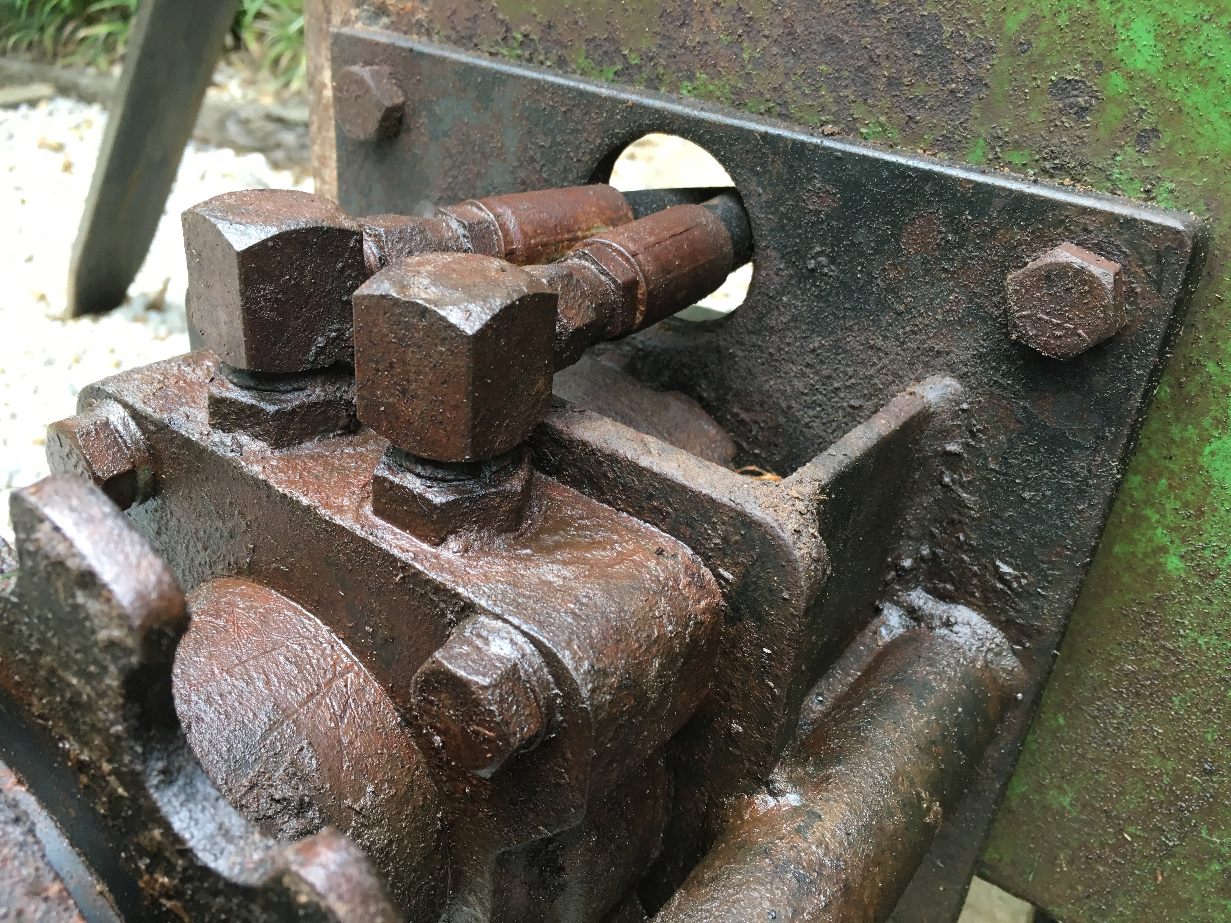

Hi Guys,
Got the wheel motor off today. Even with the bolts broken loose, it was really, really hard to turn them. Until now I never encountered anything like it. It was a real workout (for me anyway!)
After rereading Terry's instructions I am confused. Quote:Terry said "remove motor mount (4 bolts), pull out motor, replace motor mount on machine."
What I have now is a 50 lb hunk of metal that includes the notched brake wheel in the picture. It looks like there are some more bolts to remove to get inside. At this point the 4 bolts are out and the whole 50 lb thing has been removed. Do I need to remove the bolts on what I have now to get at the wheel motor? (I'm not sure at this point what "wheel motor" means!)
On a different topic I have another question. I want to start the engine and do some work on it. It looks like I have 3 choices:1) put caps on the two hydraulic lines in the picture 2) attach a shunt between the two lines so the hydraulic oil can flow 3) don't do anything. What do you think?
Again, I am most appreciative of the rapid an good advice I have gotten so far.
Ken

   / hydraulic oil leak near left front wheel #46
I'm thinking you're gonna have to cap those hoses when you remove them from the wheel motor to lessen the chance of your hydraulic oil draining out on the floor overnight and to prevent dirt from getting in to them. I, personally, wouldn't run the engine while those hoses are disconnected, capped or shunted together. Why? Because I'm chicken! :D
   / hydraulic oil leak near left front wheel #47
I can't help you on the motor removal. Mine is 2001 model year and different mounting system, I think.
74199d1176334971-new-mod-mossroadwheelmotor07-jpg
   / hydraulic oil leak near left front wheel #48
It looks like you have the wheel mount/wheel motor combination removed and now you need to separate them.
Ken
   / hydraulic oil leak near left front wheel #49
I'm guessing that if you remove those 4 bolts, the entire motor will slide out of a hole in the mounting plate? I base that on this overhead picture of your motor.
538540d1517780778-hydraulic-oil-leak-near-left-img_1526-jpg
   / hydraulic oil leak near left front wheel #50
The four bolts I'm referring to are the ones just behind the brake star disk, around that round housing the shaft is coming through.
