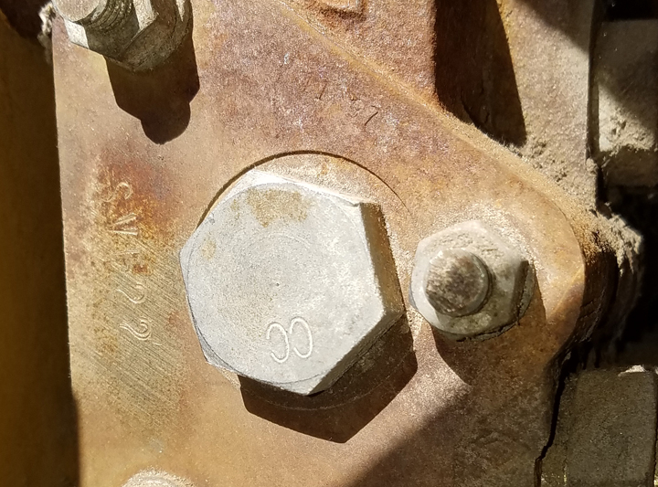

Update. The end plate on the six spool valve bank has SVE22 which the doc oldnslo referenced says is "SVE22 Power Beyond Outlet w/ #8 SAE Beyond Port #10 SAE ORB (7/8-14 THD"
Does power beyond imply open???
The nine spool valve has SVE21 "SVE21 Open Center Outlet w/ Conversion Plug #10 SAE ORB (7/8-14 THD)"
Now to figure out if the single valve controlling the carriage travel is open?
If all the valves turn out to be open could they be put in series somehow is the new question I have now.
   / Hydraulic Pump Noise... but not always. #32
RD,
On the SV document page V29 shows what the power beyond plug looks like. It should have a #8 SAE ORB port which is 3/4-16 threads. You would then connect this port to the next valve down stream to get your series circuit.
My concern is that from your earlier posts your valves are set up as closed center again on page V29 it states the closed center plug should be stamped CC. If your plug is stamped CC it would explain what you are seeing and confirm that at present your valve is closed center.
The good news is it should be convertible at a minimal cost and minimal effort Vs having to replace the complete valve stack.
I certainly hope what I am stating makes sense.

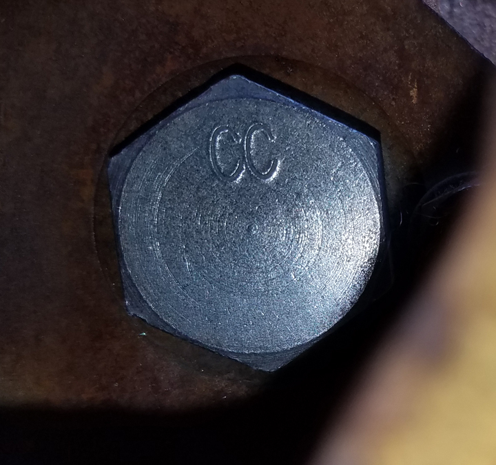

:) I must admit this is very confusing to me right now guys.
I did look at the ends of both valves banks. Six spool "SVE22 Power Beyond Outlet w/ #8 SAE Beyond Port #10 SAE ORB (7/8-14 THD" and
The nine spool valve with SVE21 "SVE21 Open Center Outlet w/ Conversion Plug #10 SAE ORB (7/8-14 THD)" I realize I'm repeating myself.
Yes, both had plugs with the "CC"
Can I get one of the different plugs to make everything open?
Please don't get tired with/of me guys.

RD,
I believe that yes you could purchase a P/n 660280001 power beyond cartridge. This item is listed on page V24 under outlet cartridges.
From your description the SVE22 is the only valve that originally had the power beyond option installed. SVE21 was an open center assembly.
Now the big question is how do you want these valves plumbed together. Based on model codes the valve assembly with SVE22 was the first valve from pump and it fed valves down stream.

RD
According to the model codes those valves were originally open center and could have been one or two pumps.
Looking at what you have today I believe the valves were converted to closed center at some point in time.
