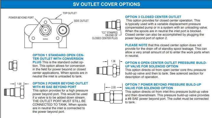

Supplier is checking to see if valves can be changed to open circuit.
oldnslo pointed out the issue of the "CC" plugs.
I have to ask Prince support one more question. They gave me a part number but I'm not convinced yet they understood what I was looking for.
Support says option 2 will fit my bill. They are probably right but I'd sure appreciate other's opinions. Remember, if possible I want to take the outlet hose for the first valve stack and connect it to the inlet of the second valve stack making all open circuit.
Now I see oldnslo agrees with support and the part number... sorry about that oldnslo. I'm not clear though if you think it will be needed on both valve stacks. Or which one.

I believe that Power beyond fitting would work in either valve stack. You will have to convert both valve stacks to open center and or power beyond. First stack will require power beyond fitting to feed second valve stack. Does the second valve stack need to feed anything else? If yes you will need a power beyond fitting for second valve stack. If no you will need to remove the CC plug and either cut the nose off that CC plug or obtain a #10 SAE plug to install in that hole. By removing the CC plug you have now connected the power beyond flow path to the tank flow path in the valve which makes it an open center valve without power beyond.
NOTE: You will still require a the separate tank line on the power beyond valve stack so do NOT remove that.
