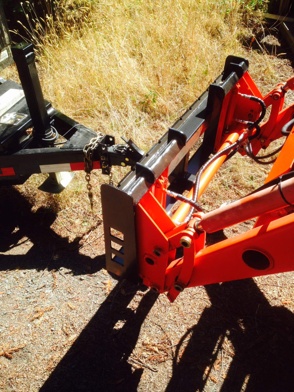

The longer qa cylinder hoses arrived and are now installed. Everything works as planned. I will update on any operational issues after a few weeks.

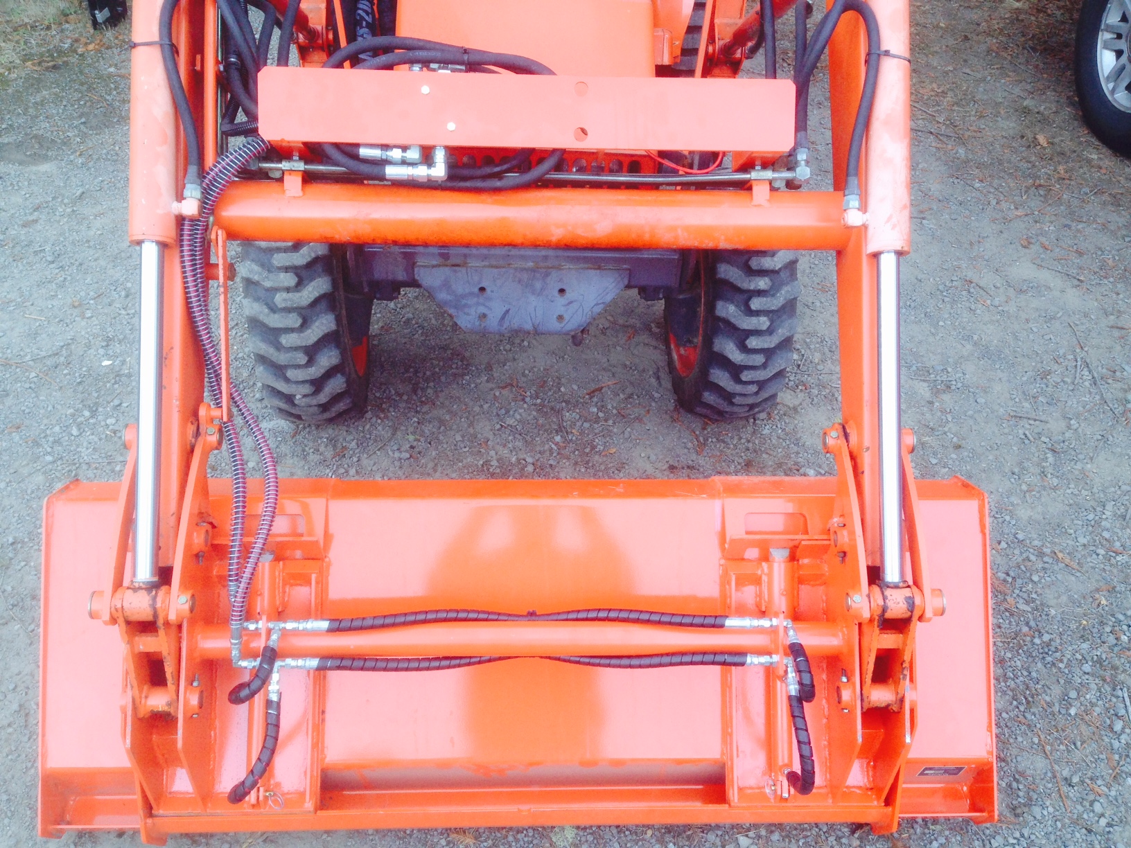

Costs came out higher than I would have liked.
Metal plate, angle, bar, etc - 51 lbs @ $1/lb at surplus yard = $51
Torque tube 48" DOM 2"x.25" = $41
Mount pin bushings DOM 1.5" x .25" = $12
Pin tubes 7" DOM 1.75"x.25" = $7
Cylinders 2 ea @ $70 = $140
Diverter valve = $160 (could have saved $50 if bought from Mountainviewranch)
Hoses (8 ea various lengths) = $140
Fittings = $36
Wiring (fuseblock, wire, loom, switch) = $55
Total $642 materials.
Time = huge.

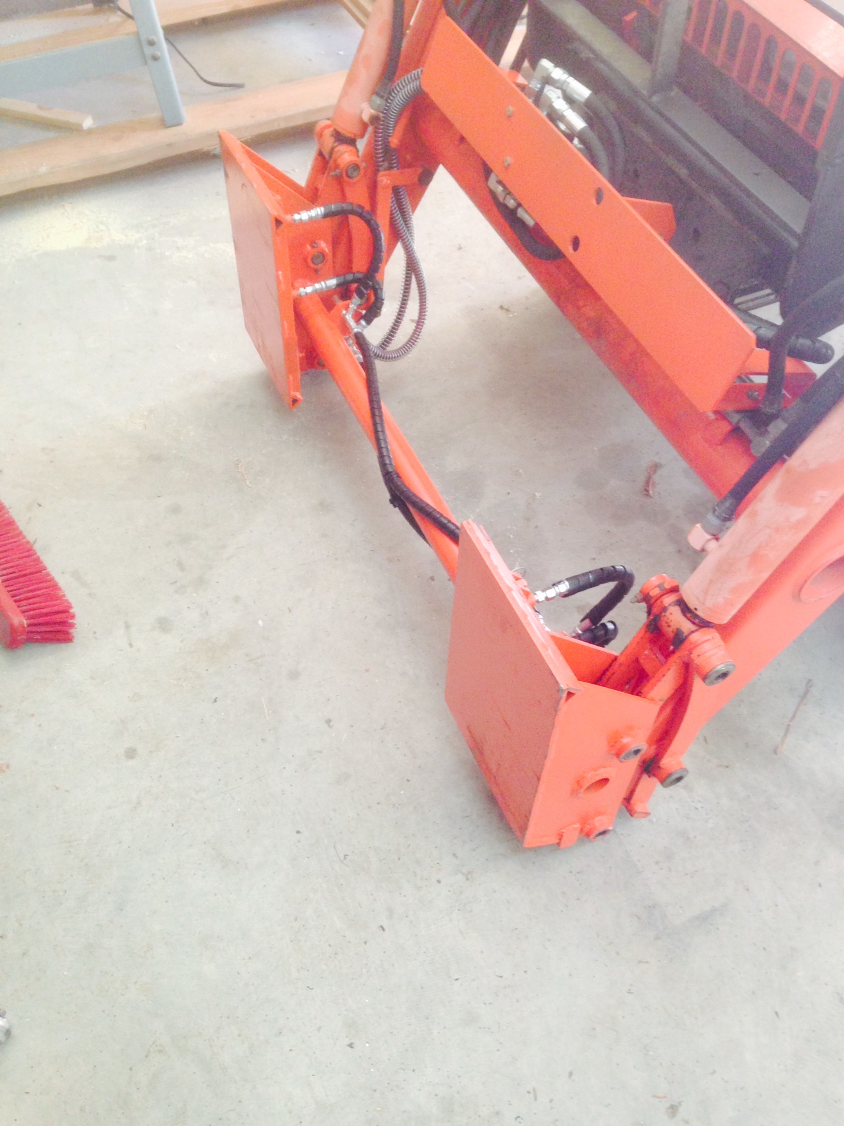

Satisfaction is also huge, for sure! After just a few days of using it, I realize I should have installed a QA long ago. So having the QA is a huge plus. Then, the second thing is how to actuate. With over-center crank arms, with a linear actuator, or hydraulic. Making the hydraulic option work is very satisfying.
Making it to the SSQA standard is also part of the satisfaction. The first thing I did was buy a set of forks. Extremely handy. I still think the Euro-Global design is easier to fabricate and also better suited to hydraulic actuation. But the widespread availability of SSQA attachments is hard to beat.

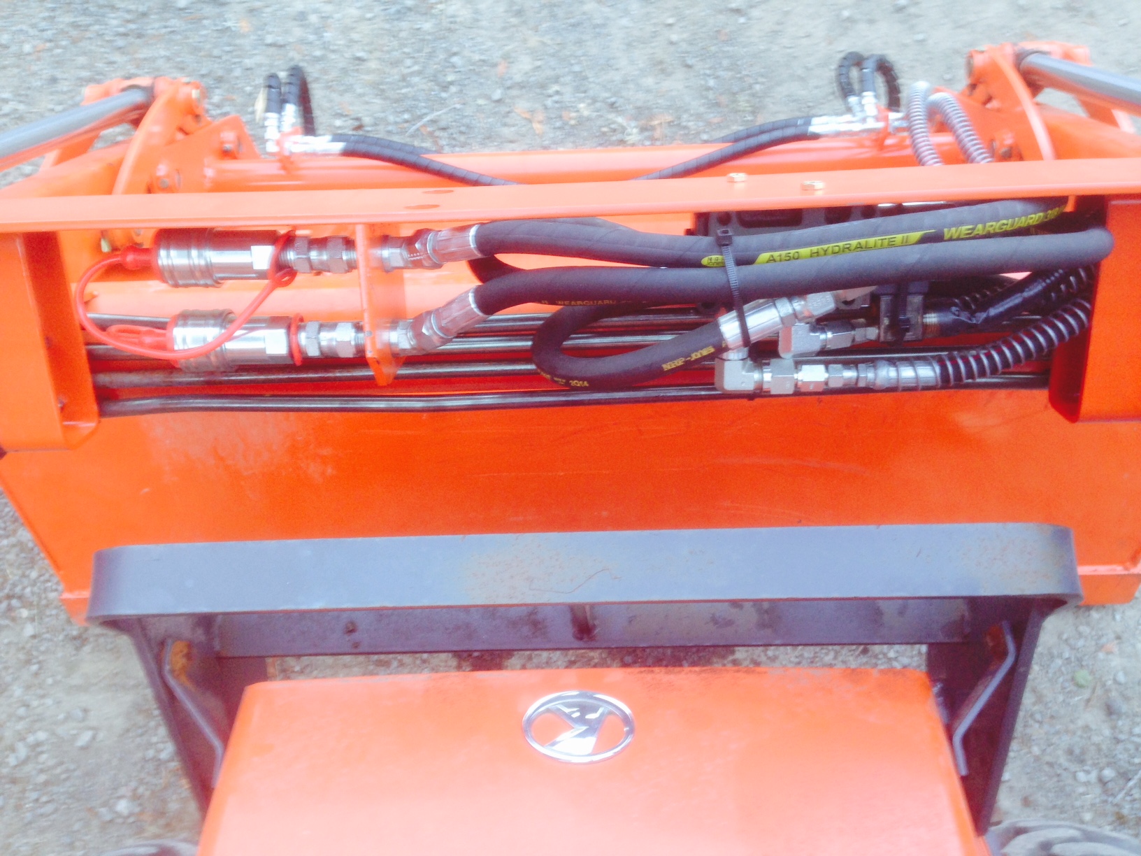

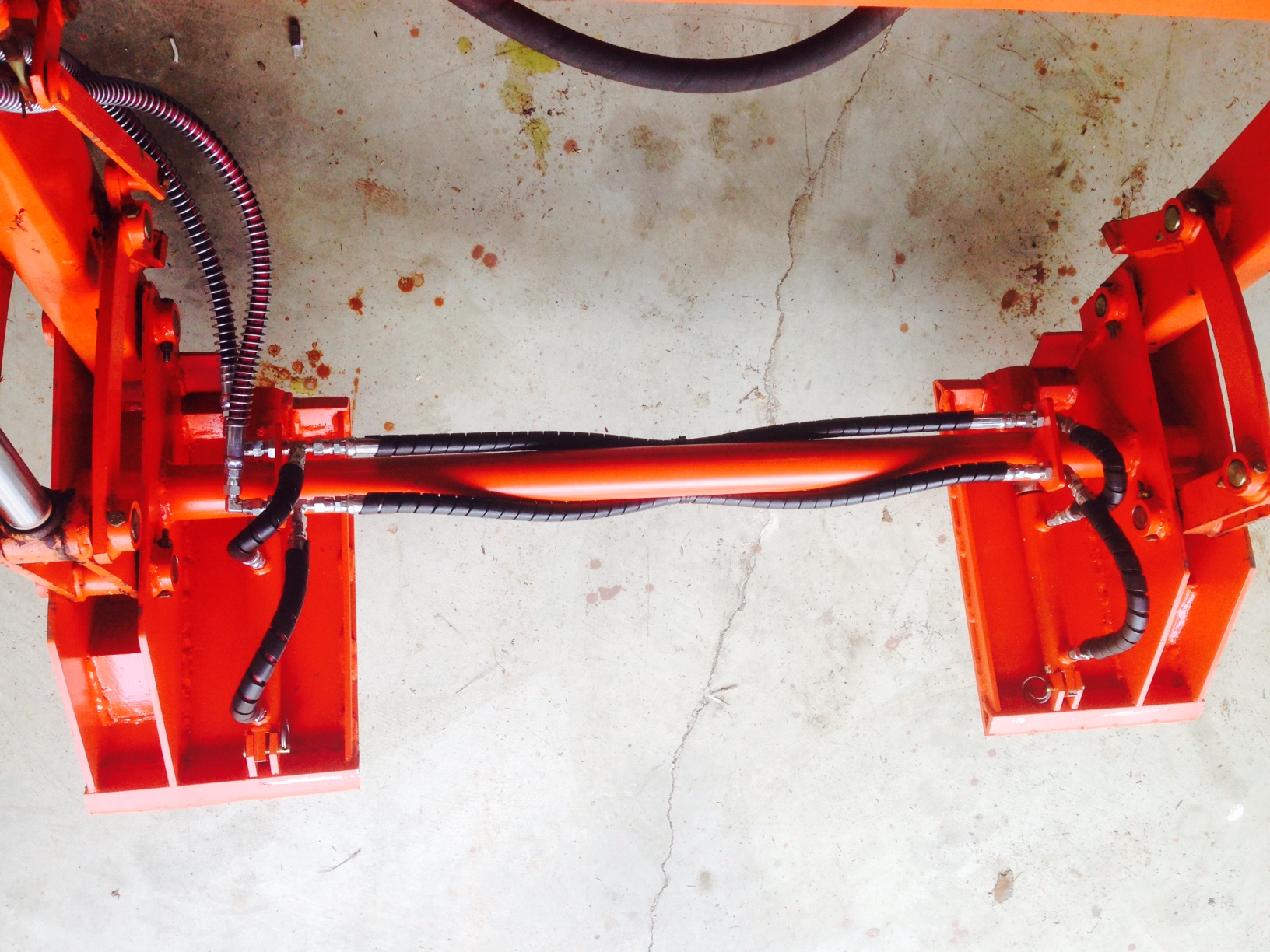

Just to wrap up. I have used it for 5-6 weeks. The locking pins sometimes loosen a bit overnight, I make it a habit to give them a push when starting up. I might add a plate to provide more protection for the valve fittings and hoses. Can't think of any other issues.
Grapple plumbing is complete, that is what I am working on now.

A holding valve would fix this if it's a big deal, no?
   / Hydraulic Quick Attach
#80
Yep I think so. Not a big deal for me. I am used to stuff sagging overnight. The routine before was raise the backhoe off the ground, tuck in the outriggers. Now the third thing is a quick push on the QA lever. If it ever becomes a functional issue I will put in a check valve.
