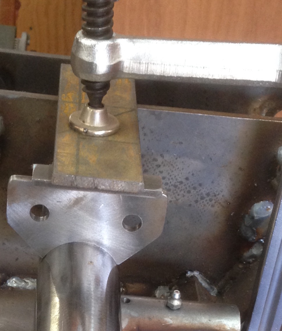

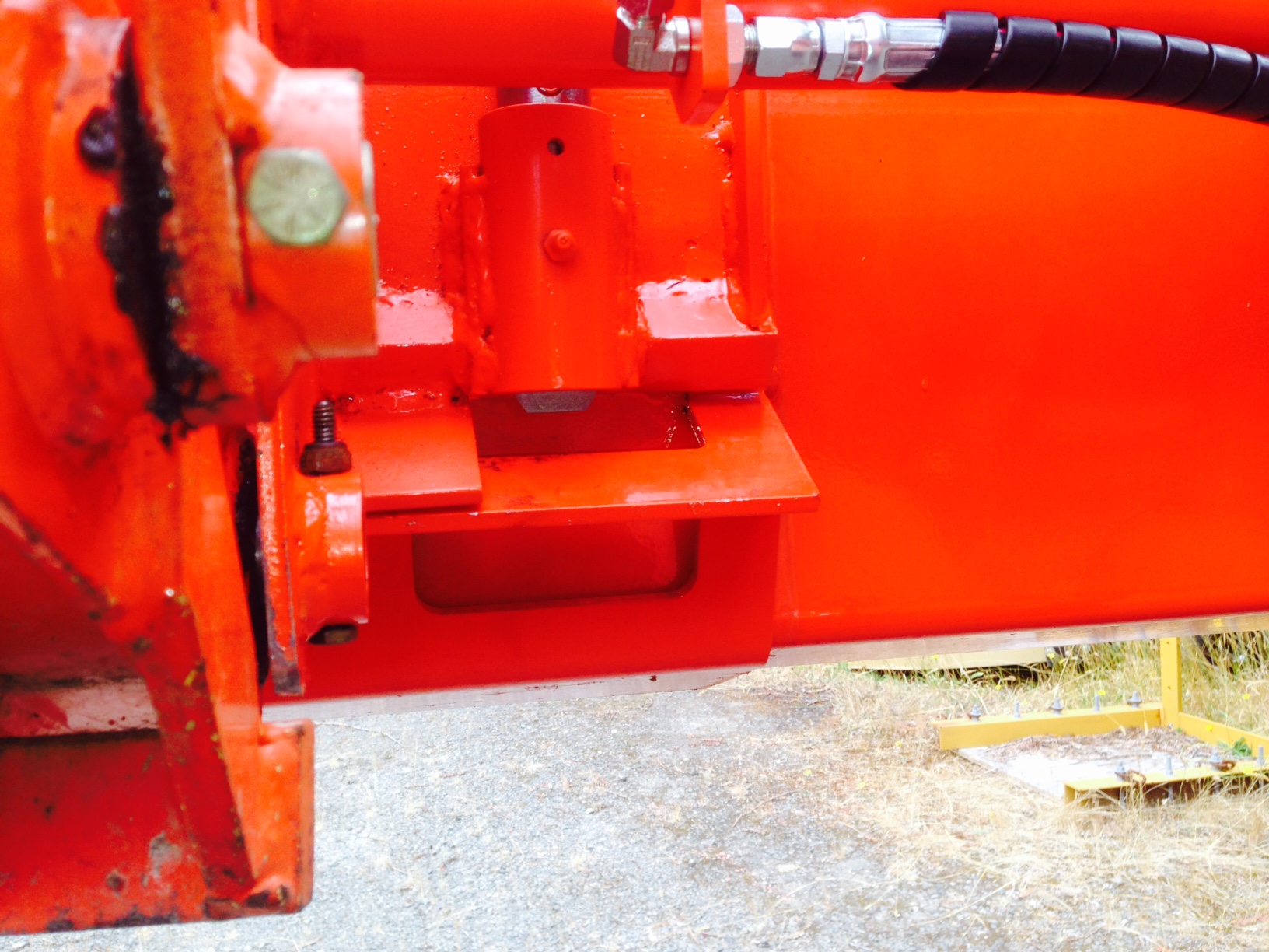

Here is the last thing to be welded. I don't much like welding so glad that is done. I do enjoy the fitting and jigging part.
Next steps, order the hoses now that I have the lengths, and finish the electrical hookup for the diverter solenoid.

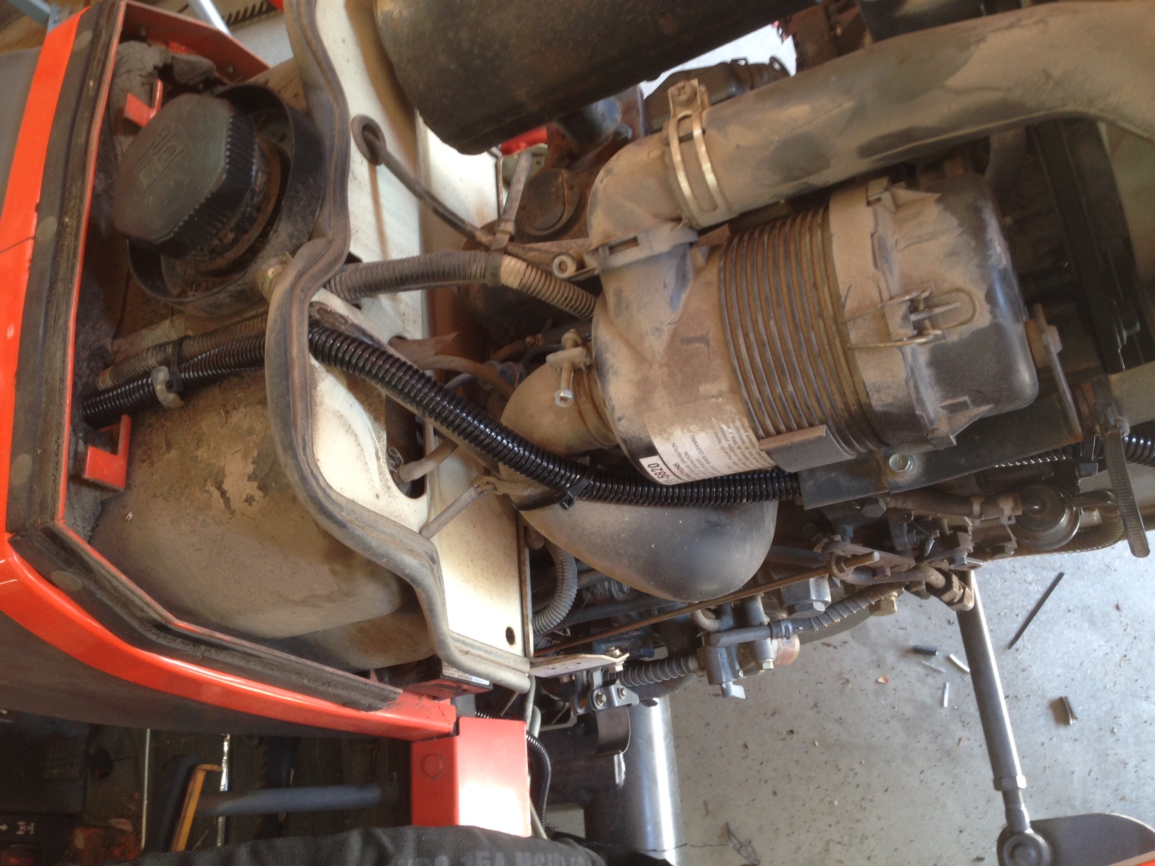

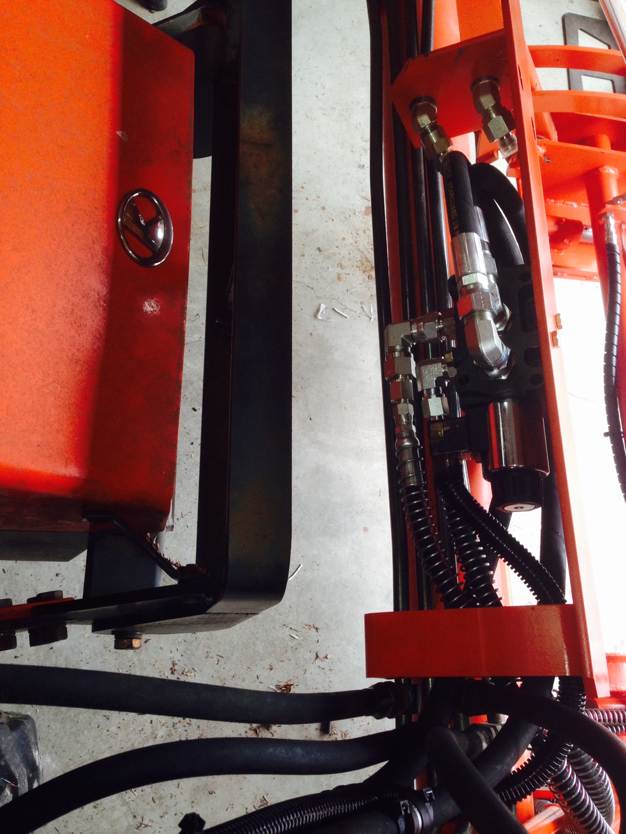

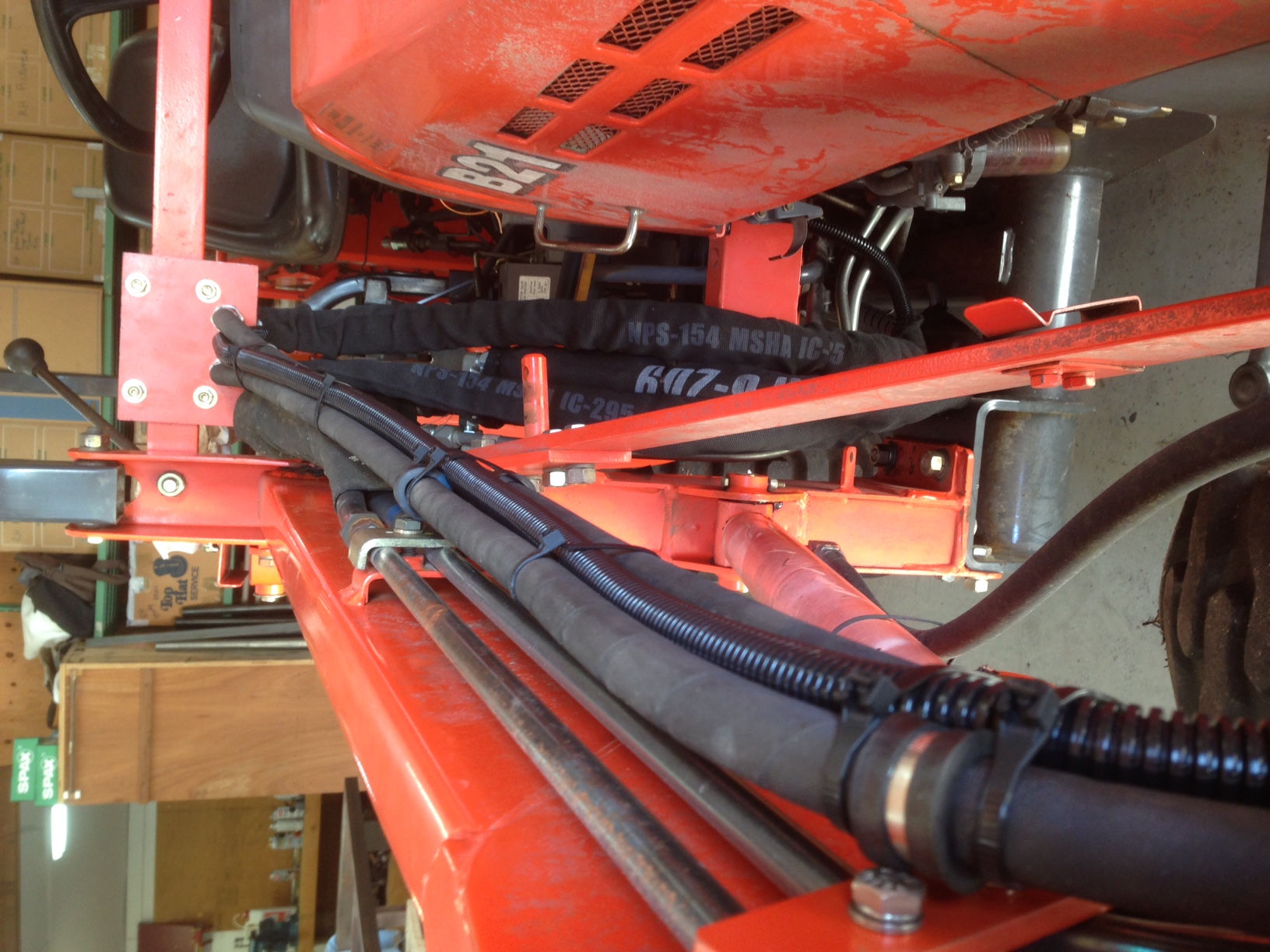

Slow progress - my 95 year old father in law broke his hip, so now taking care of the old gent. That is why we moved here from Virginia, knowing something was bound to happen.

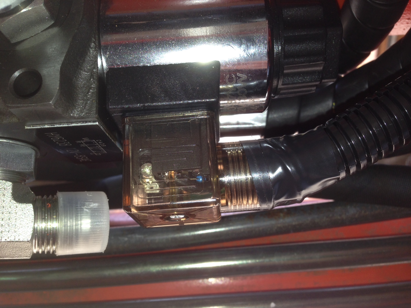

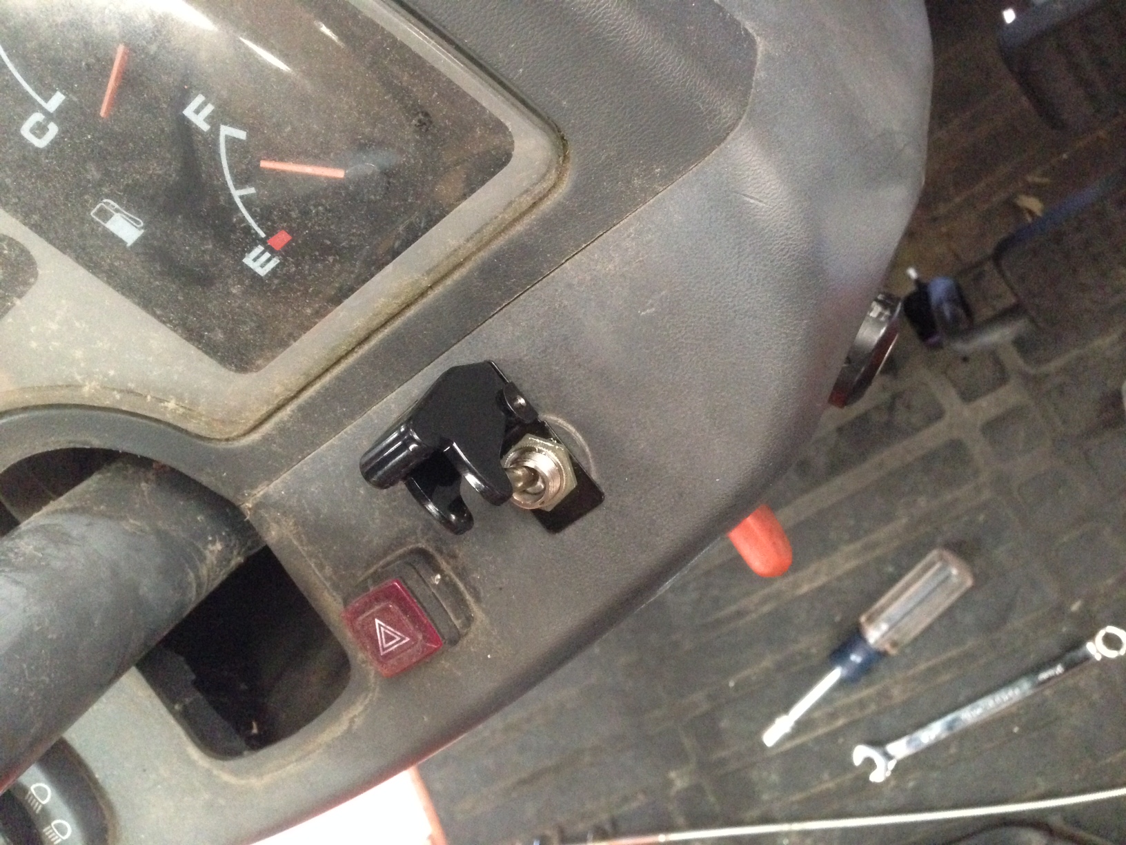

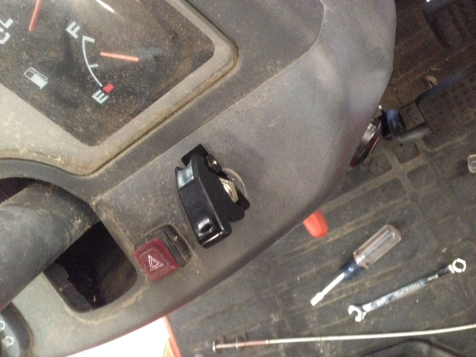

Anyway I got time to finish the electrical wiring for the diverter valve.

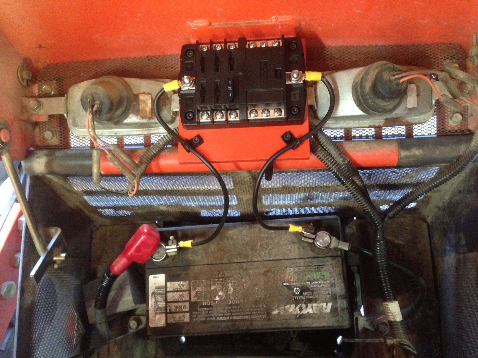

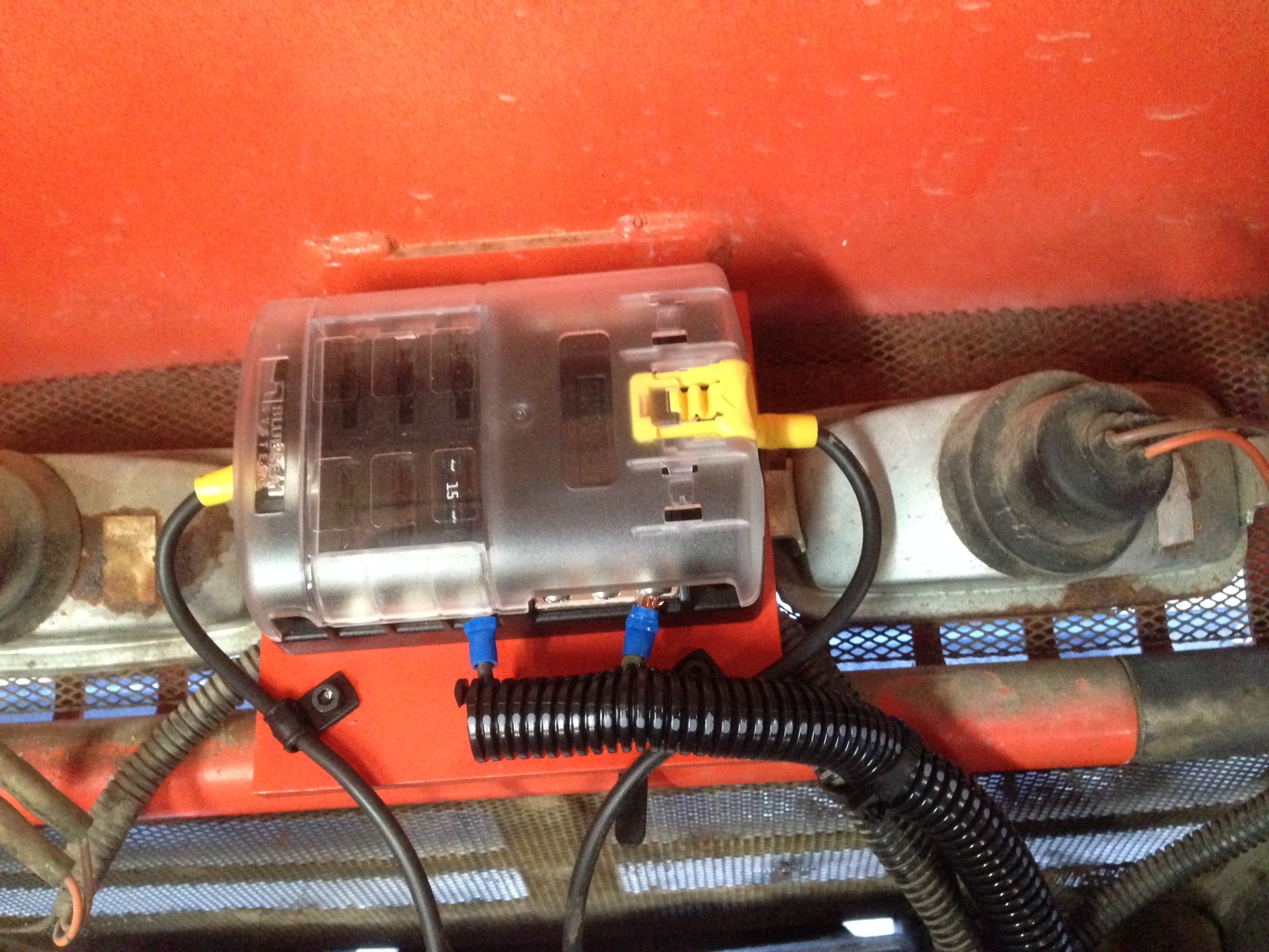

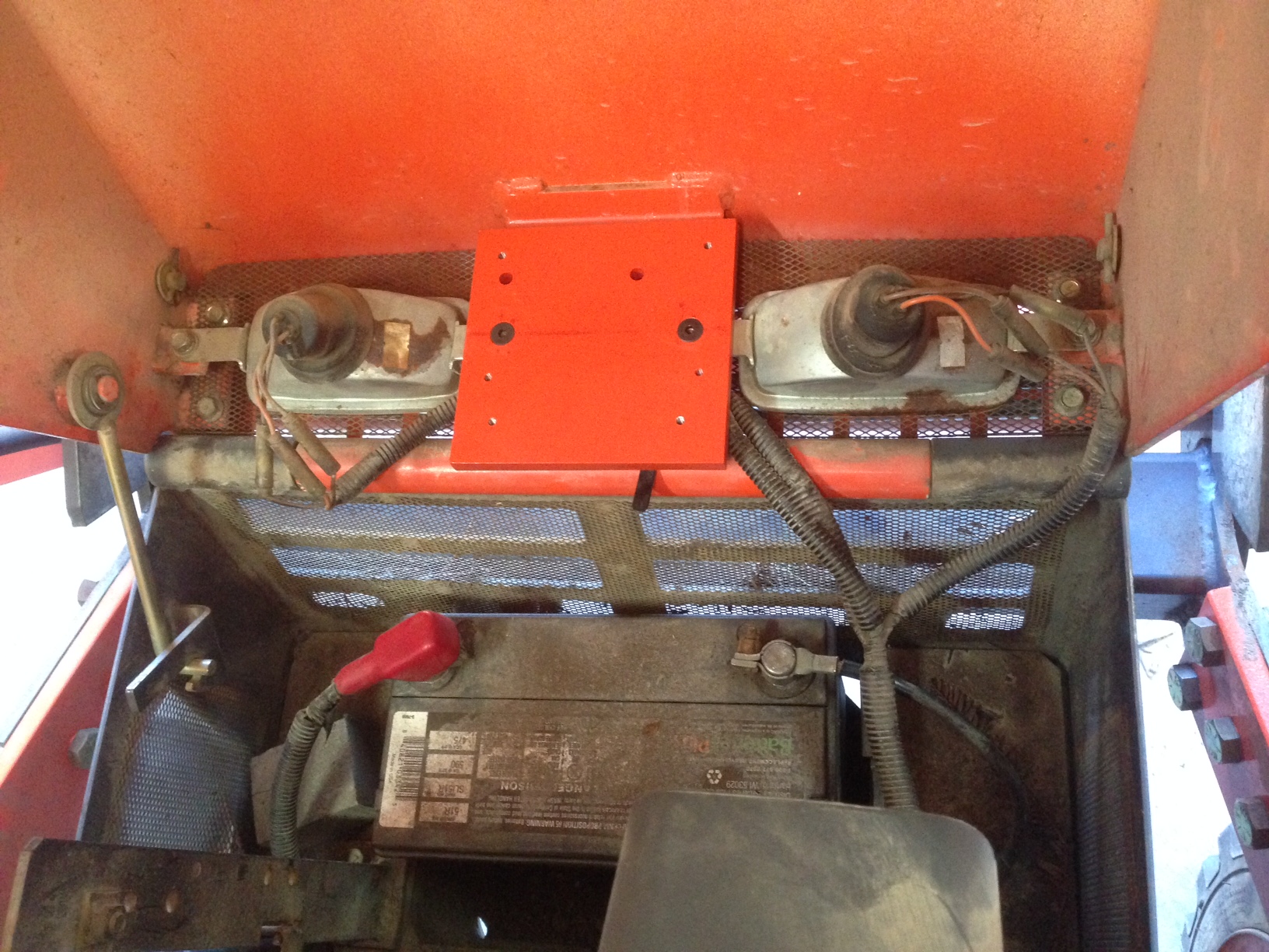

Photo 1 - Mounting plate for the aux fuse block attaches to the headlight bracket.
Photo 2 - The fuse block has positive and negative busses, makes for a clean installation. Wire from battery is 10ga.
Photo 3 - Wire to switch and diverter is 14ga.
Photo 4 - Loom goes through engine compartment and through firewall alongside factory loom.
Photo 5/6 - Switch is SPST with a snap cover. In the up (on) position power goes to the solenoid and fluid flows to the QA cylinders. In the down (off) position no power to solenoid and fluid flows to the grapple cylinders. This setup makes it all but impossible to unintentionally cycle the QA. The switch is in an unused factory mounting hole.
Photo 7 - From the switch, the wire goes down, under the floorboard, and tucks into the hydraulic hose sheath. From there it comes up to the ROPS hose bracket, then follows the hoses along the loader arm to the diverter.
Photo 8 - Diverter has a dust and water resistant industrial connector. With an LED that shows red when the solenoid is energized.

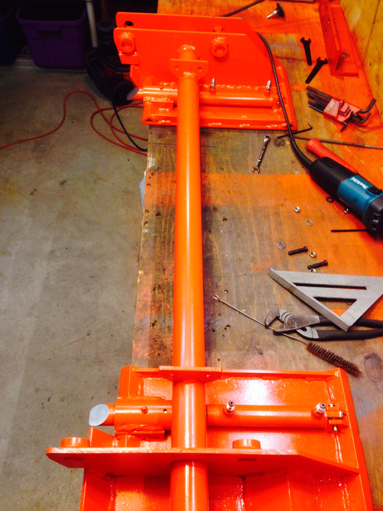

Got the assembly cleaned and painted. Last thing needed was cut pins to length. The tractor is located 4 hrs drive from here so need a couple days free from father in law support to get there and install. Maybe next week.

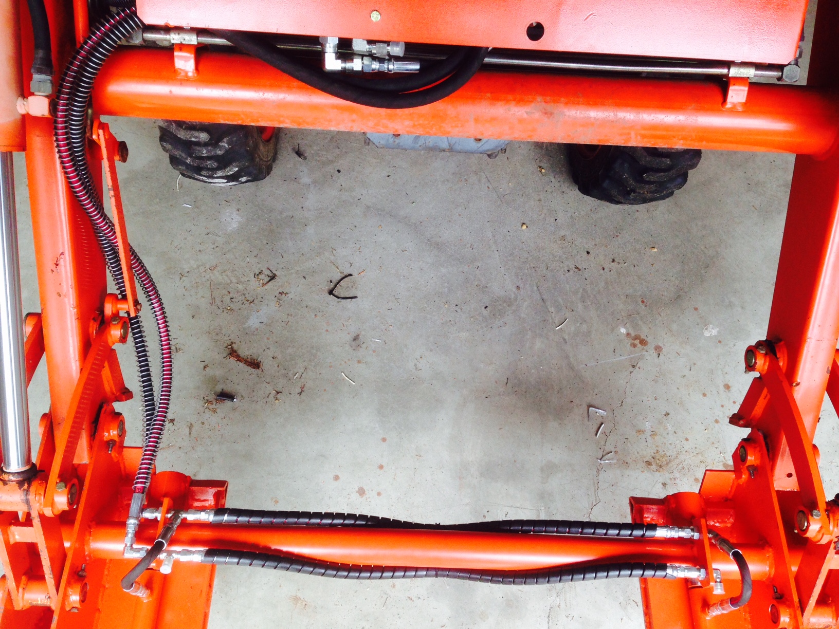

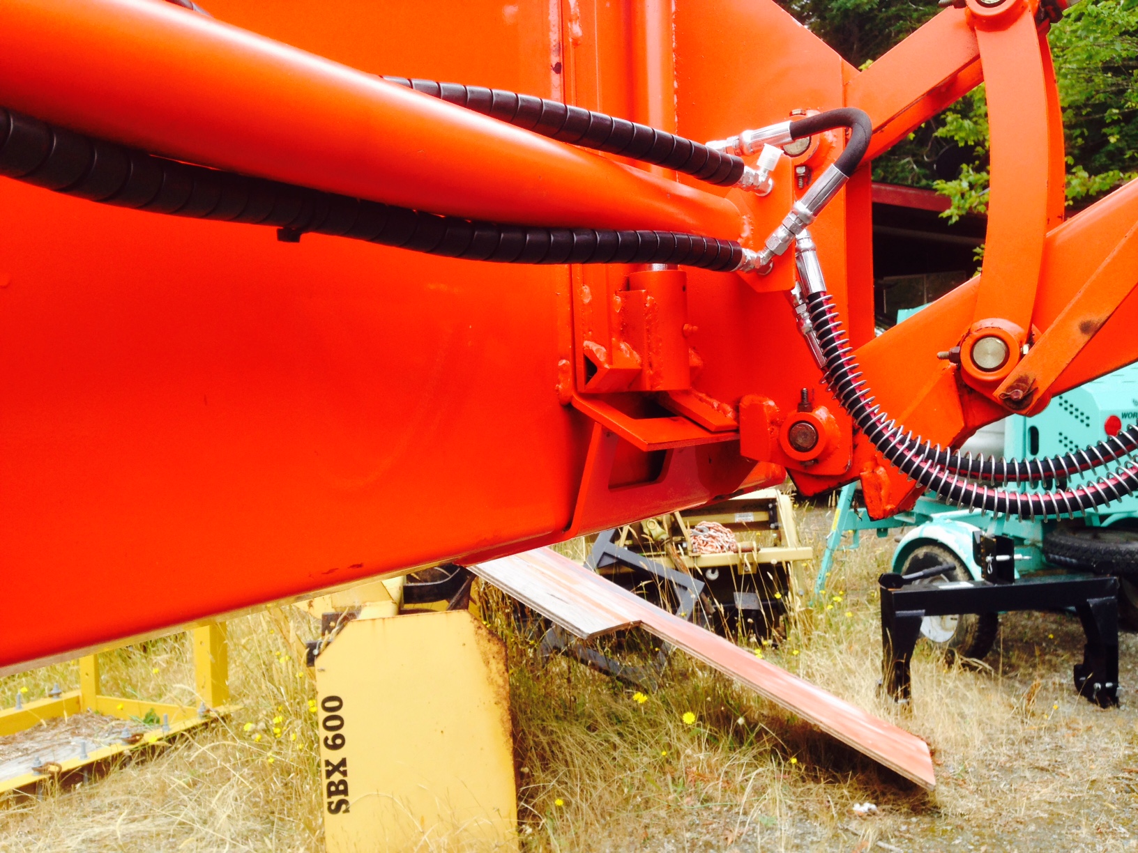

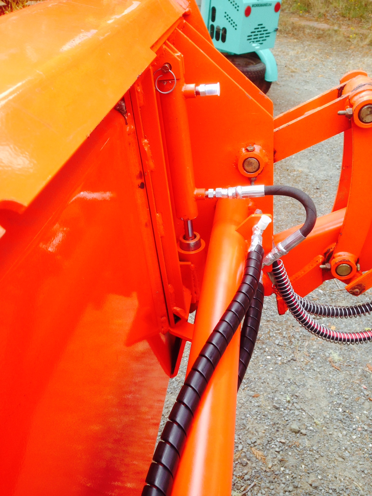

Installed the qa this morning. Not quite done because somehow I ordered two of the hoses 2" short. But everything else is OK.

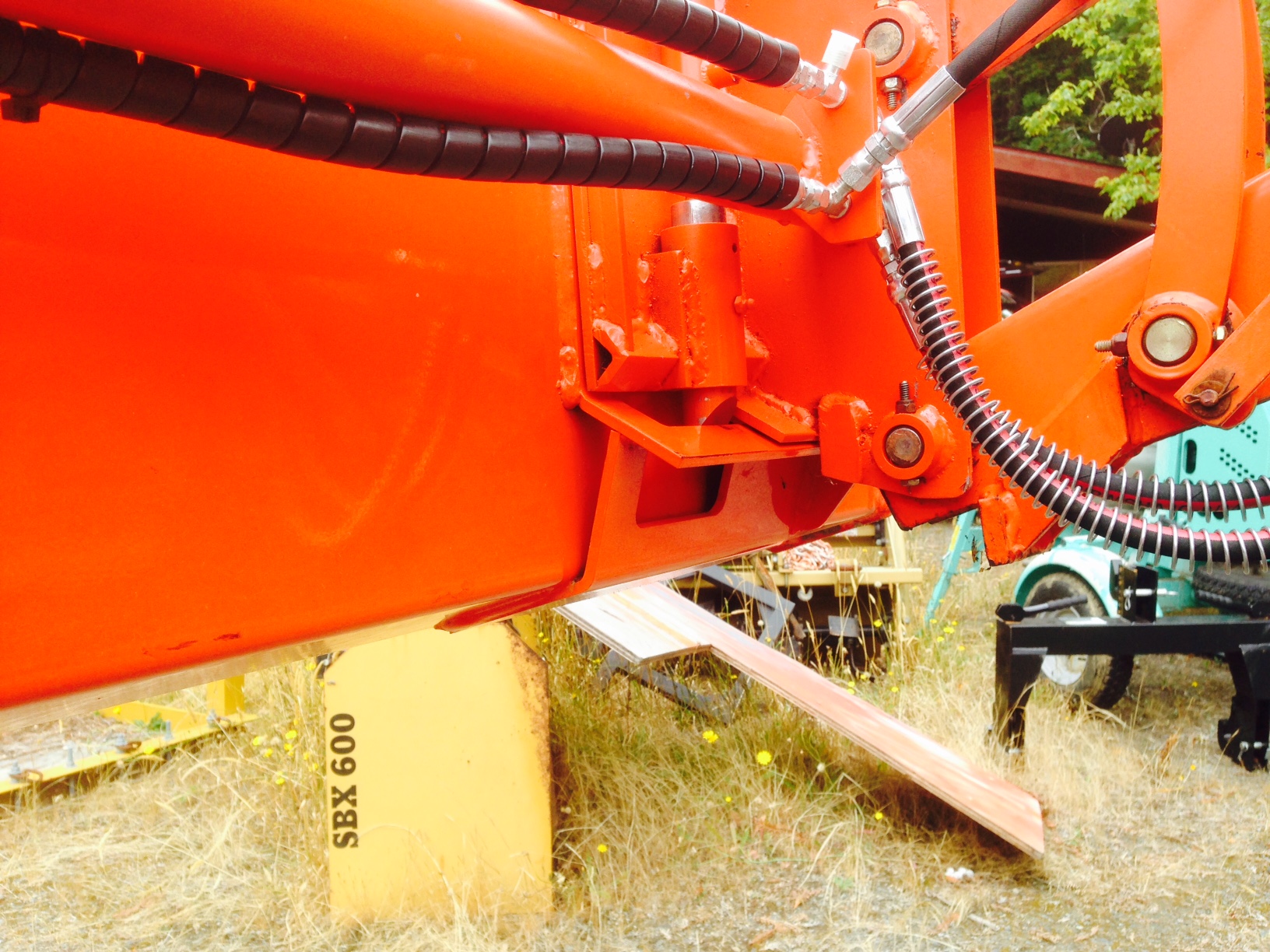

Photo 1: Hose installation on qa. Hose protectors were left over from the hydraulic thumb project.
Photo 2: Hoses on diverter. As planned the hoses pass through the 2x6 tubing bracket which keeps them in place. A bit tight but workable.
Photo 3: QA fits the Kubota bucket perfectly on top.
Photo 4,5: And also on bottom.
Photo 6: The pin or wedge contacts the bucket bracket about half way down which is what I had in mind.

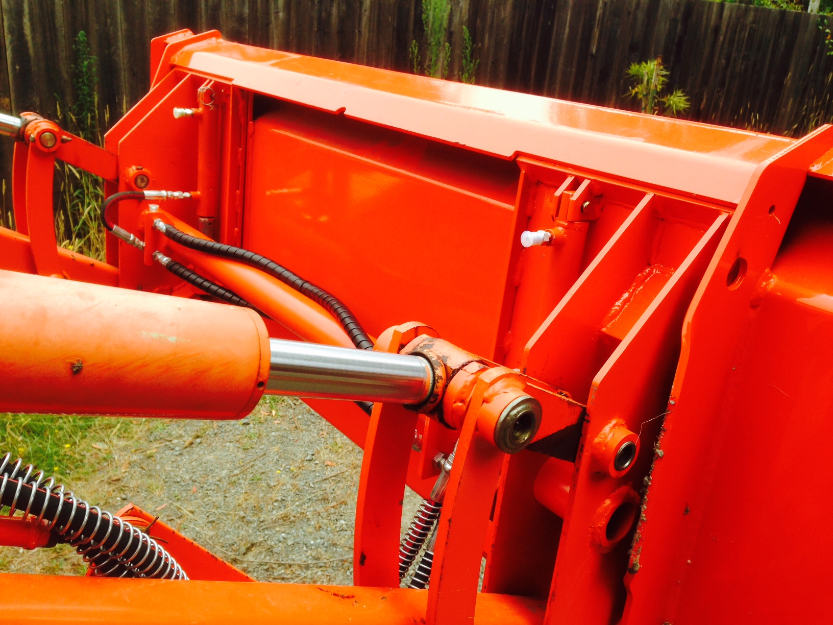

Photo 7: Showing the cylinder extended.
Once I get the correct hoses the last hookup should just take a few minutes. Considering I started out to make a grapple, this has been the mother of all side tracks. But interesting.

/ Hydraulic Quick Attach #56
Incredible job. Will you be able to dump the bucket completely forward? Seems like you would need a LOT more inches of hose than that.
Where did you get the tiny cylinders? :)
#58
Ishiboo thanks for the note. And thanks for your earlier comment, that made me re-think my plan and in the end go for the ssqa standard design. Hoses are long enough. The cylinders come from Surplus Center. Perfect for this application.
