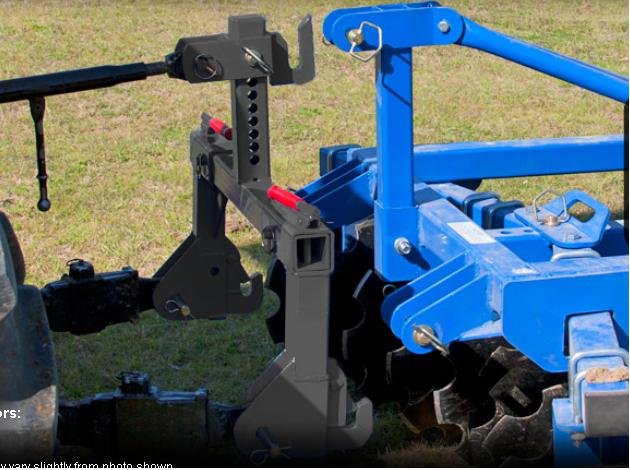

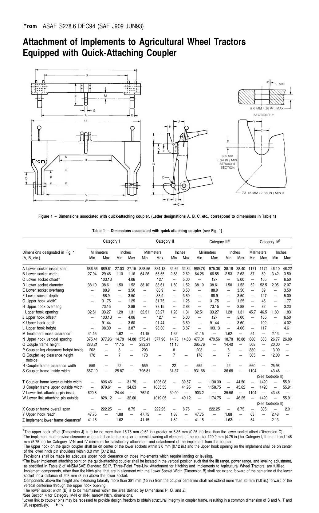

I'm at the dealer. Can somebody measure their Cat 2 Quick Hitch? I couldn't measure my own because my tractor is stashed up in northern Minnesota.

What it is SUPPOSED to be:

Great what are v and w in inches? I'm on a phone.
   / Hydraulic scarifiers: various designs #54
V is 30" min, no max - W is 40" max, no min. listed. Check your email if you can :=) Steve

BTW, I think I posted another pic of a (now apparently discontinued) QH from Priefert - I'm strongly leaning toward either starting over or modding my HF QH for this. I'll post it if it's aready in my pics, stay tuned - PriefertMod2HFQH.JPG
Yup, it wuz already there :D...Steve

I cannot attach photos right now, but running a tape measure across the two bottom lugs, the Cat 2 lug is 0-3.5" and 35-38.5" on the box blade.
I've got my sister on a mission to measure my quick hitch up north so I can find out if this will work.
   / Hydraulic scarifiers: various designs #58
I think you need dimension A, where it hooks to the BB. 32.6 to 32.8 inches.
B is 2.53 to 2.62 inches
N vertical spacing is 14.78 to 14.88 inches
V= 30 W=40
