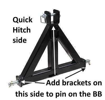

Here is a Steve's Gannon Hitch Mod diagram.
Steve, if you've got a dxf file you're willing to share, we can get that attached to this thread too.
   / Hydraulic scarifiers: various designs #66
Thought most of the text from the email I sent you would be pertinent here too - here 'tiz
A word of warning - even with this mod, the top pin on mine is a bit tricky to get lined up - TnT is a must on that and other implements.
Also, mine's set up for Cat1, altho even the older Gannons have lower ears for both 1 and 2. So you may need to alter the amount of offset.
I beveled both the old ears and the new pieces (both 5/8" thick) til there was only about 1/8" left, then welded it up with 7018. To keep things from pulling out of position, I took some 3/4" allthread and cut pieces about 1/8" shorter than the spacing between ears, then ran 2 nuts onto the allthread, slid the "baby jack" between ears and ran the nuts out to maintain spread.
Two more longer pieces of allthread and 4 nuts per piece, and I'd locked the width down thru the pin holes. It was a ***** getting to the insides to weld, but not impossible. Whoever does the welds better be fairly good at OOP welding though :=)
Actually, that drawing originated in WinDoze Paint (yeah, I've used it a fair amount :=) - the only CAD pgm I'm fluent in is an ancient (DOS only) thing called Generic Cadd - been using it since the '80's, then Autodesk (who had bought it in self defense) finally stopped supporting it when Windoze took over. I have their older "QuickCad", which combination allows me to draw in one I'm used to, convert it to DXF, import that to QuickCad, fiddle with it a bit and print it. Neither pgm will take a bitmap and convert it to vector though. (Besides, once it's a bit map there's no point, other than markups maybe??)
Even thought I'm retired, I have more I wanna do than I EVER got paid to do :laughing: and all the monkey motion to print something out is getting even older than me :confused: sooo, about a week ago I dnl 3 or 4 of the higher recommended free cad pgms, haven't gotten around to trying any but Qcad's "teaser" pdf sounded logical to me (knocking on wood - why do I have a headache??!?:rolleyes:)
Hopefully one of those CAD's will "click" with me and I can do drawings fast enough to beat using a flat board and charcoal :D
If anyone has other questions I missed, about this mod or any other problems with the QH/Gannon combo, feel free... Steve

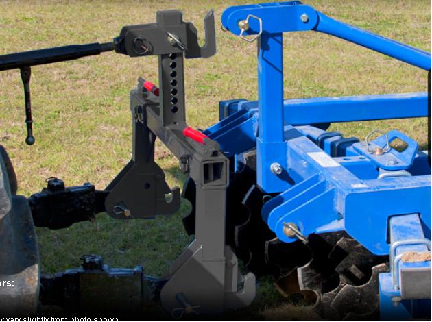

BTW, I think I posted another pic of a (now apparently discontinued) QH from Priefert - I'm strongly leaning toward either starting over or modding my HF QH for this. I'll post it if it's aready in my pics, stay tuned - View attachment 412362
Yup, it wuz already there :D...Steve
Bukit, I have one of those. If you need any measurements, let me know.

Pappy, thanks for the offer - mainly I'd like to hear your opinion/reasons on that hitch - it appears they don't offer ANYTHING related to implements any more, other than "high speed chicken scratch stirrers" - makes me wonder how I'm gonna get my "lifetime guaranteed against breakage" tiller tines replaced :confused:
I grabbed that pic off their site when it was still available, thought I'd borrow the toplink scheme - my Caroni flail has Cat 1 spacing on the drawpins, and (approximately) Cat 2 spacing on tower height :rolleyes: I fabbed up a couple flat bars with holes in 'em short term, but simply pulling a pin and instantly adjusting top hook height seems 'way more "civilized".
