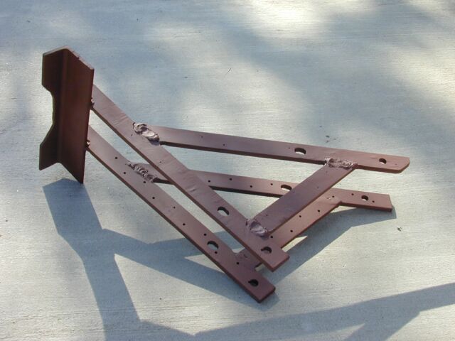

Do some research on here for thumbs (if you already haven't). I really think you'll be surprised how well a mechanical thumb will work for you.
A hydraulic thumb will definitely "cost" the BX. They really excel when you need to be extra gentle (say with old rocks that you don't want to damage making a stone wall) or you want to get underneath something and be able to pluck it from its location when your machine is at its max reach. I'm sure there are a few other examples, but I honestly think you'll really enjoy a mechanical thumb. I'm going to get one for my hoe soon.
Here's a picture somebody posted a few months back of a thumb they made themselves if you do any fabrication work yourself. /forums/images/graemlins/cool.gif I tried to find the original post, but can't. Somebody will know.....

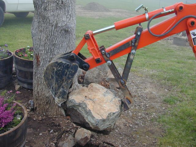

   / Hydraulic thumb for BX23 BH #15
Here's a link to my original thread $0.50 thumb .
I used it all winter and early spring for rocks an logs. Finally got it cleaned up and primed this week.
Cheers!
