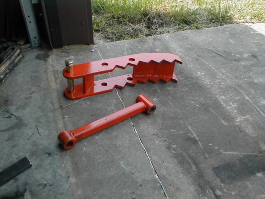

Here is what u are looking for. I made it out of 1/2" * 3" flat stock. It will take you about 4 hrs to build and about 8 hours for the paint to dry! /forums/images/graemlins/grin.gif Total cost is around $35 bucks.
I dont know what the reach is for a BX23 BH but my kubota is short and I was not going to spend $1000 for something I could build. I think it is 6.5ft so the dipper arm is about 21" to mount the thumb.
Hope this helps. /forums/images/graemlins/smirk.gif

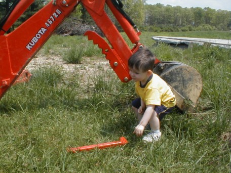

The picture is for the Thumb...Not my son!!!..LOL. /forums/images/graemlins/smirk.gif
