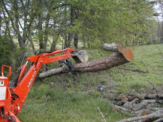

Last ...In Action! /forums/images/graemlins/grin.gif /forums/images/graemlins/grin.gif

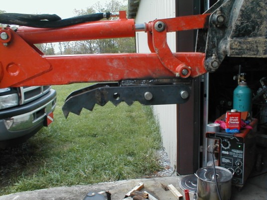

Oh...I forgot. Its a weld on unit. I wanted to build a bolt on unit but there's not really enough room because of the dipper cylinder.

Nice Job and you can not beat the price. I'll bet you could sell quite a few of those here on the forum.
