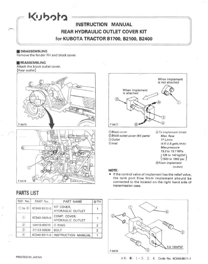

Re: Hydraulic Tip \'N Tilt
OK, I'm going to try again to attach the "instruction manual" (one page) for the optional rear hydraulic outlet that some models of Kubotas have available. The sheet shows for B1700, B2100, B2400, but of course, it's also for at least the B2710 and I don't know how many others.
Bird

<font color=blue>6C040-9510-0 Hydraulic Outlet Kit $68.95</font color=blue> for that??
The document is almost useless (as you said /w3tcompact/icons/frown.gif), but it looks to me like the "Outlet Kit" is simply an extension, with a right angle.
Now that it is all together you may not remember, but were the ports exposed by removing the cover the same as the ports on the new block (<font color=blue>1/4-18 NPSF</font color=blue>)? If so, could you have run your hoses directly to the side of the tractor and not purchased the Kubota part? If you did that, you would have wanted right angle connetions for the tractor, but I bet that would have been a lot less than $70

Nope, Mark, the holes in the tractor are not threaded. The little plate that you remove has one longer O-ring (convoluted?) that seals around a channel that lets the oil flow through it, then the new outlet comes with the two O-rings so the oil has to flow out and back in through that outlet and whatever hoses you attach to it. I'm curious as to how many different model Kubotas have this outlet. And, yep, that price sure seems high to me, but then so does anything I buy nowadays./w3tcompact/icons/frown.gif
Bird

With the JD790, the kit comes with the parts for a tractor with the SCV and for without the SCV (SCV means FEL valve setup /w3tcompact/icons/smile.gif).
The rear outlets kit has metal pipes that go from the tractor to a metal mounting plate out the back - underneath the seat - and then returns to the main valve. Then a hose connects the Out to the In so the circuit is completed for the open centered system. No connection for the tank because the system has a relief and is designed to flow right within the 3PH valving when no pressure is needed by either of the auxilliary valves. That all costs $160-$170 /w3tcompact/icons/frown.gif. I think it is the rigid piping that is bent specifically for my application that drives up the price.
On the other hand, I can get a "kit" that sends the FEL valves to the back; really, just a couple of long hoses with male quick connect on one end and female on the other, then a another mounting bracket that goes in the same place. That kit is $145, and you'd need 2 for top and tilt /w3tcompact/icons/shocked.gif/w3tcompact/icons/shocked.gif. I figured the rear outlets was ok, but I couldn't believe what they wanted for the extender kit!

Well Bird looks like the end is in sight. Great work. I looked at the sheet you scanned. Tells you just enough to get into trouble. What is the part about if your valve has a relief valve to go to the side of the trans, return line?
What you might want to do is a search on ebay I've seen alot of flow restrictors and reducers go pretty cheap. Just an idea.
