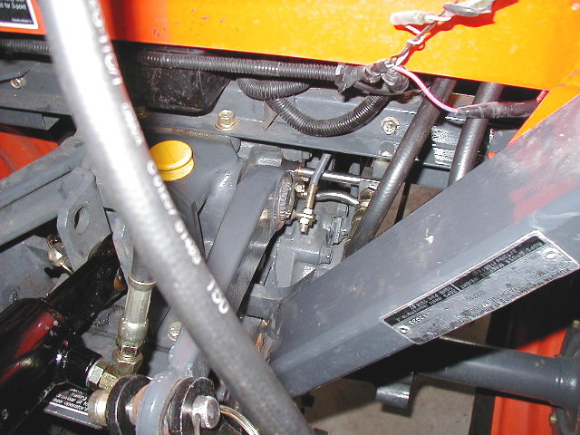

Getting a picture of that rear hydraulic outlet (through the hoses and other obstructions) was a little more difficult, but we'll see how it looks. It's under the brace called a fender stay, so you can't immediately put a 90 degree elbow coming up, and if you attach straight hoses, you have to bend them up pretty quickly or you're back to ROPS

Bird, great pictures! You mentioned earlier you had to bend one of the points of attachment of the cylinder so things wouldn't bind- is that the end on the right lower 3 ph arm ? Did that tend to misalighn the holes? I'm getting the itch to do this to my FORD 1910. I'm wondering if there is a smaller valve setup available, especially since you are putting in flow restrictors anyway?

RCH, the top of the side cylinder was straight instead of being offset, so I bolted on a couple of offset pieces of steel to attach the top end of that cylinder to the lift arm. Everything is too strong to do any bending (unless you heated it with a torch and maybe do some serious damage).
If you look between the hoses to the side link cylinder, and just above where the top hose connects, you can see the shiny bolt. The pieces I bolted on were some that I had on hand and were already painted black just like the cylinders.

Bird, I see what you are refering to. So does this added 2" or so of length to that cylinder? Could this mess up the geometry if it was a tighter situation; or prevent the lower arms from being adjusted higher? I have a tree planter with a 22" coulter and I have to adjust the lower arms as high as possible to get that coulter to clear the ground when I lift it up. I do this by attaching the vertical lift arm( or in this case the 'tilt' cylinder) to a hole furthest out on the 2 horizontal arms that have the cat. 1 pin recievers. Put another way is the whole tilt assembly when retracted as short as the adjustable link on the other side when it is fully retracted ?

RCH, let's see if I can explain this. Originally, the "fixed" link on the left side was 17" long, and the manually adjustable link on the right side was about 17" when it was centered, so it could go up or down from there. Now I've moved that adjustable link to the left, and put the hydraulic link on the right. The hydraulic link was 13" collapsed, if I remember right, with a 3.5" stroke. The extra pieces I bolted onto it actually lengthened it about 3", which I felt made it about the right length anyway. So what I've done right now (may change later after I use it awhile) is to set the hydraulic cylinder right in the middle of its stroke, then adjusted the left link to the same height so they're level. So now I can hydraulically raise or lower the right arm only about 1.75" from level. Of course, 1.75" at the arm makes the ends of the box blade move up and down considerably more than that, and I can tilt the blade both directions. And of course, if I need more than that, I can always re-adjust that manual link on the left and really get a drastic tilt in either direction.
So, I guess the answer to your question is, "No, the hydraulic link will not retract as short as the manually adjustable link, but it will retract as short, or shorter, than the fixed link that was originally on the left side."
