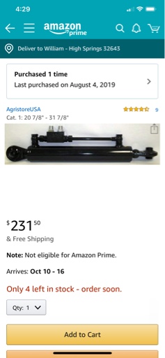

Gunny, which model Agristore hydraulic top link did you get from Amazon? Did you have to grind down the ball end to to be able to mount it to your tractor? That's one of the things that I don't get about the RK24. It lists as having a Cat 1 three point hitch, which I would expect to be able to use any Cat 1 top link, but it doesn't as the mount on the tractor is too narrow. I finally found a reference to it being a Cat 1 (N) link, but so far I've been unable to find any such animal anywhere.
Thanks!

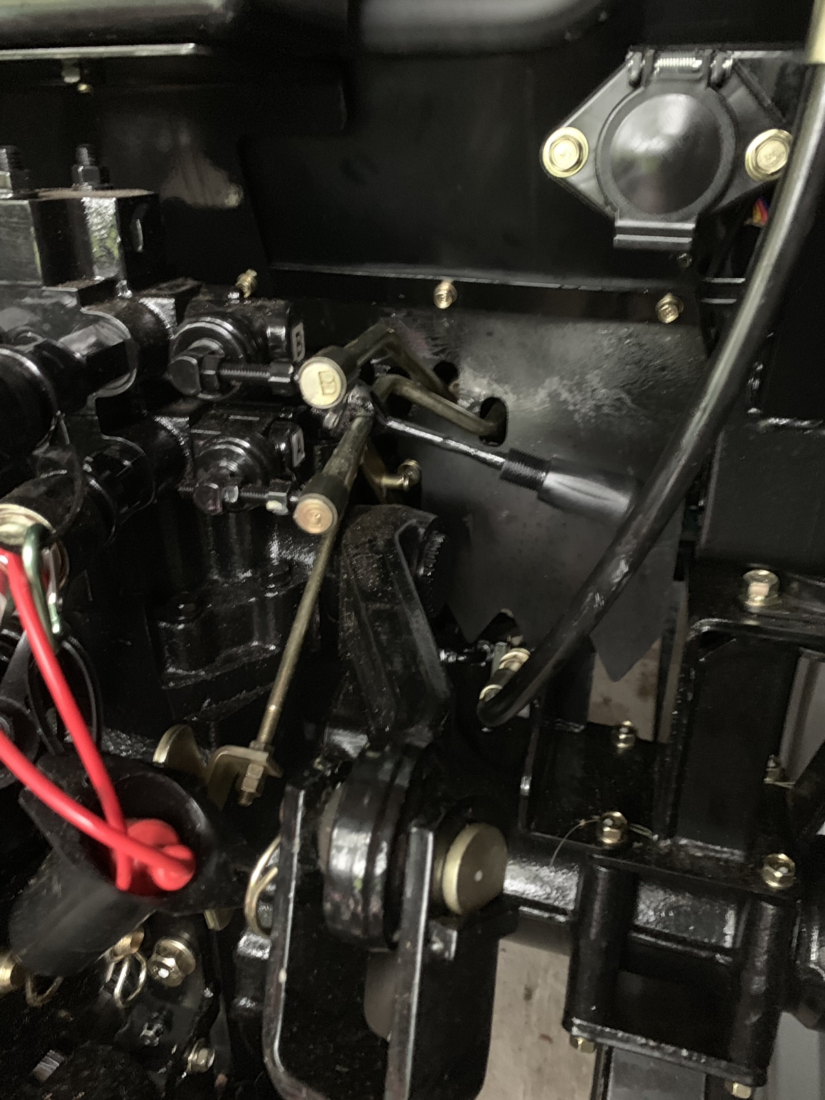

You’ll be glad you did. It’s a great price and makes things so easy. I actually made a lever for the outside on the back so I could move it in and out when hooking implements up.

I put a picture somewhere. I’ll see if I can find it.
/ Hydraulic Top Link
#39
Scroll up the pic is in an earlier reply. It looks like a screwdriver. I actually welded a piece of round pipe that I cut a slit in to a nut driver.
