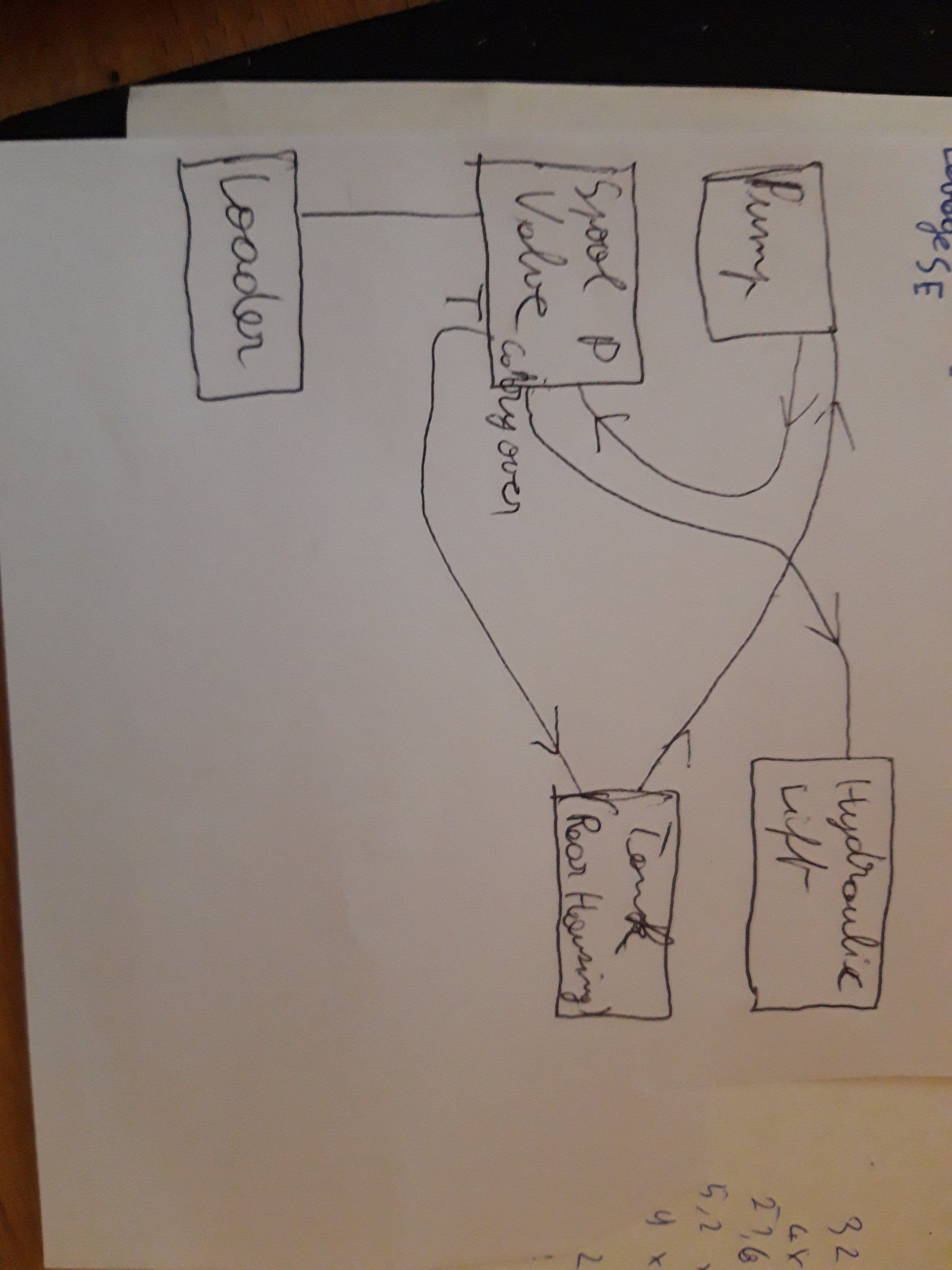

Hello
I'm French and I own a 69' Ford 3000 tractor made in Belgium. I've recently mounted a Quicke 2200E front loader on it.
The hydraulic spool valve has a remote joystick. From the beginning, I've been having a weird problem, at idle, the loader works normally but is quite slow (30 sec from down to up), and if you press the pedal a little to increase the RPMs, the loader stops working but the lift operates normally. Last Saturday, I borrowed a hydraulic pressure tester to check if the "security valve" was opening at the right pressure. It was a little low, it is now set to approximately 165 bars (2400 psi).
Every time I increase the RPMs a little, the loader stops working but the lift operates normally.
Hydraulic oil was drained 10 hours ago, the return filter has been changed, and the spool valve is brand new and is manufactured by Badestnost. On the right side of the tractor, there are 2 hoses, the little one was cut when the clutch was replaced. The closest to the pump end goes to the Pressure plug, the other end goes to the carry-over plug. A return line was installed.
Please tell me if I'm correct, If the RPMs are higher, there should be more flow and so the loader should operate faster.
Do you have any idea about what is going on?

Your diagram as drawn looks like it SHOULD work. However, in the photos I can't see the three lines from the loader valve to the tractor. The "carry over" line you mentioned. Is that a power beyond fitting mounted in the N port of the valve? Second question. I only see one work port being used on the first spool of the loader valve. Is that because that circuit has only single acting cylinders? If so, the valve is no doubt set for double acting cylinders and only using one port will cause problems. Another question. The relief valve you adjusted (assuming that's what you called a security valve). Was that the one on the loader valve or the one in the tractor?

The photo is old and at that moment i missed a fitting. Now the 3 lines are connected to the valve. I do have a spécial fitting for the Carry over, which i bought with the valve. The cylinders which go up and down are single acting. The "thing" in the valve was changed for a simple acting one.
It is the one on the valve. It has a little orange cap on the photo.

Your math all seems correct on calculated lift times. But if I am understanding correctly you still cannot raise the loader with engine RPM above idle. Is that correct?
If yes can you install your pressure gauge in the pressure line to the loader valve. Watch the gauge as you raise the loader with engine at idle and then with increased engine RPM.
Doing this will let you you know if something is suddenly flow shifting and blocking flow to the loader.
Try same test with curl dump to see if they operate in similar fashion.
