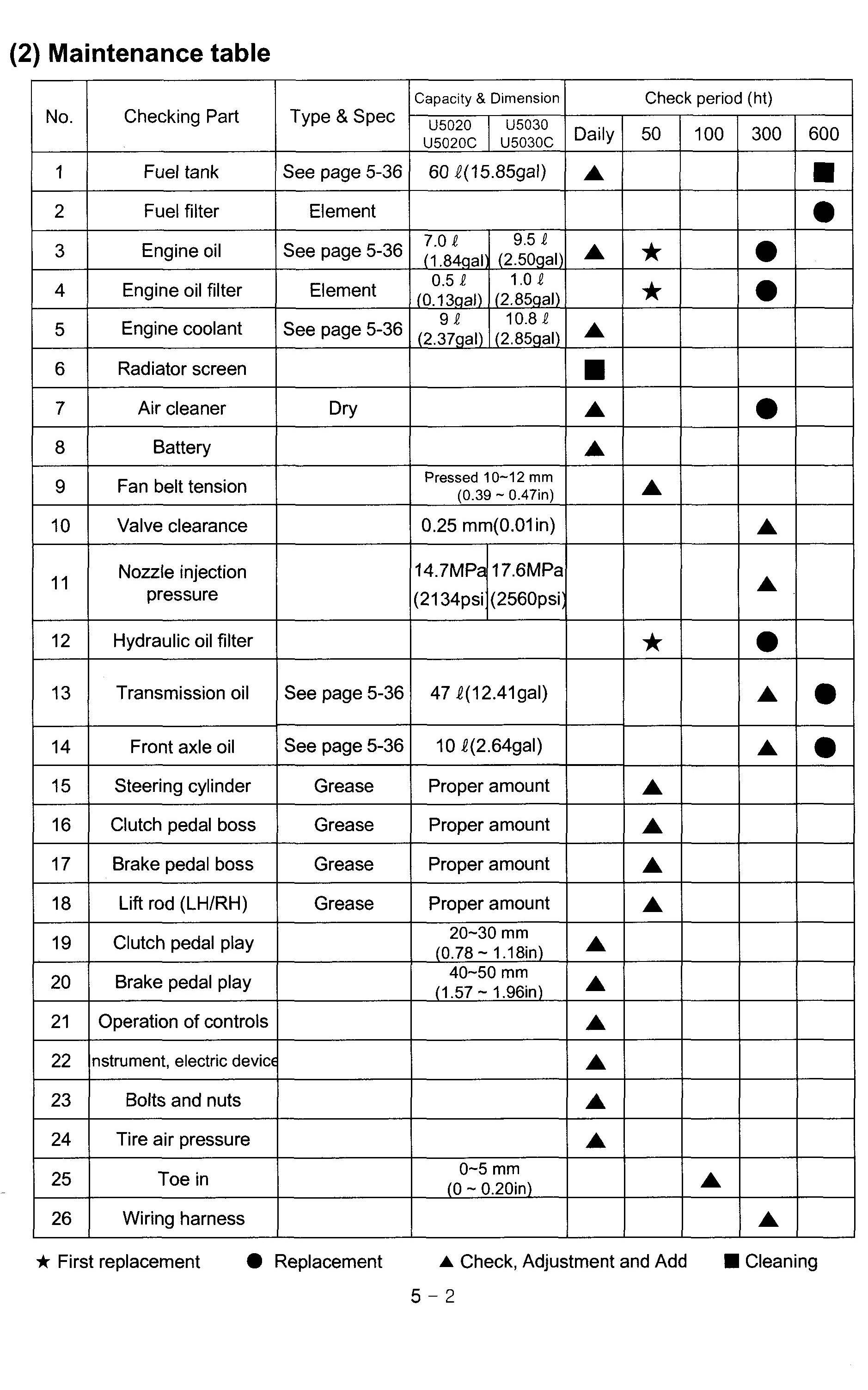

I have had some short PM conversation on this topic with ShortGame and find it hard to believe that each of our LS tractors has such varied lubrication change intervals. My P7010 manual says to change engine oil, transmission/hydraulic oil and even front axle oil at 50 hours (includes filters as needed). Then every 200 hours on engine and every 400 hours on hydraulic. My hydraulic needs nearly 15 gallons and 2.3 gallons for the engine so I guess I will have lots of fire starting oil.
Here is a copy from my manual for a U5030C with the date of 07-30-2009 and it is a geared model

/ hydro fluid comparison #17
That chart has only the engine oil first replacement at 50 hours. My R4010g chart does not. All oil filters first change at 50 hours.
/ hydro fluid comparison #18
I read it as
Engine Oil
Engine Oil Filter and
Hydraulic Oil Filter
/ hydro fluid comparison #19
What I don't see on that chart is hydraulic oil at all. ??? You never have to change it?
/ hydro fluid comparison #20
I would say changing the 12.41 gal of oil in the Transmission at 600 HR counts.
