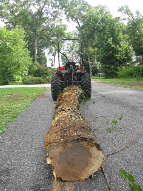

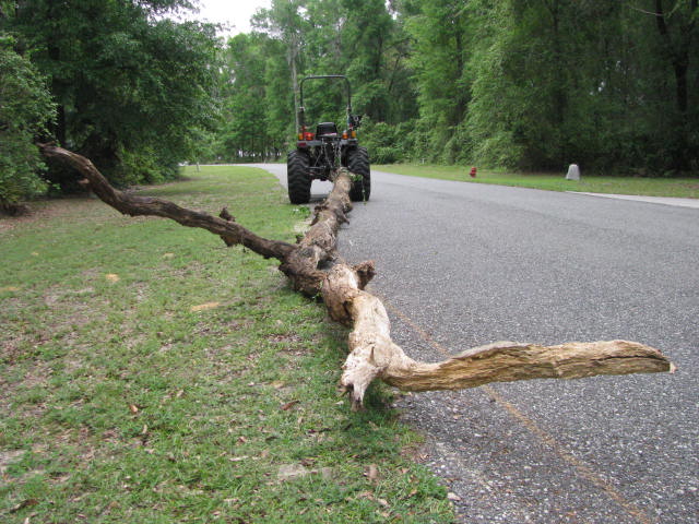

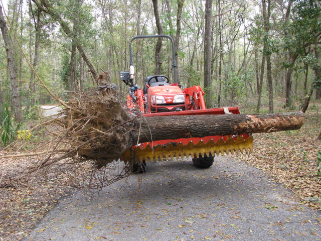

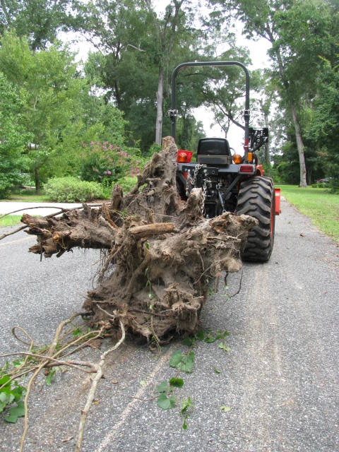

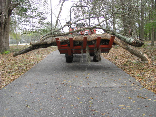

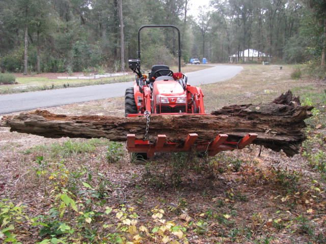

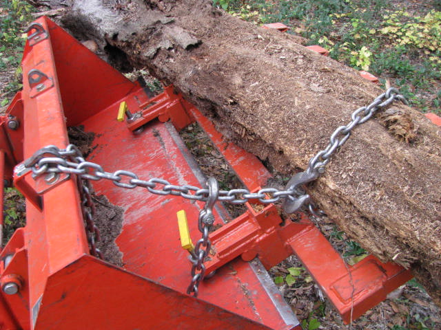

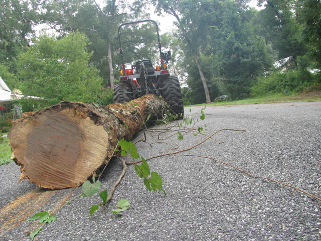

Photos are of my former Kubota B3300SU / HST, just about equivalent to JD3038E. Buy more tractor weight if you can afford to. My heavier Kubota L3560 / HST is more capable in every respect than the B3300SU / HST.
