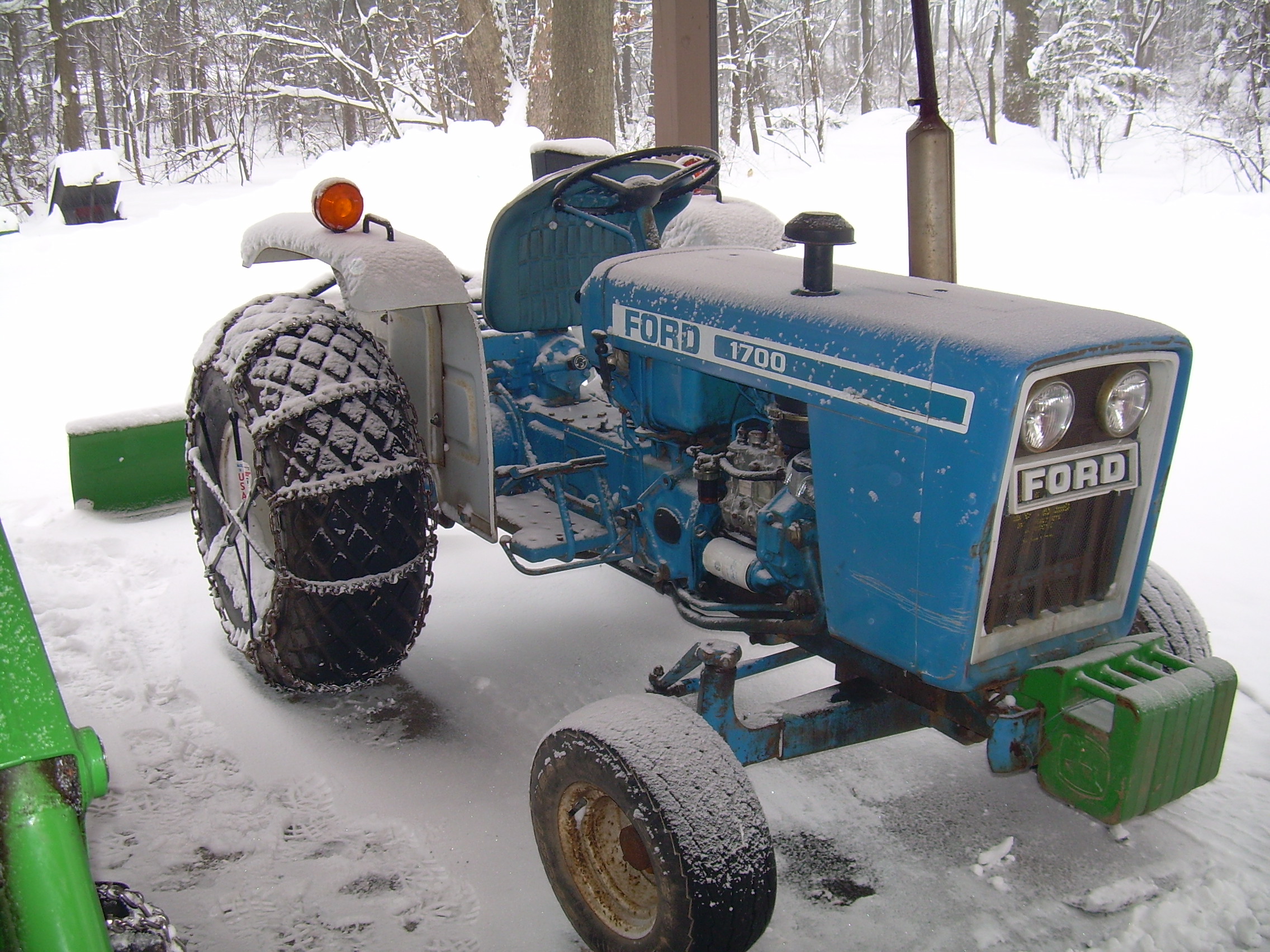

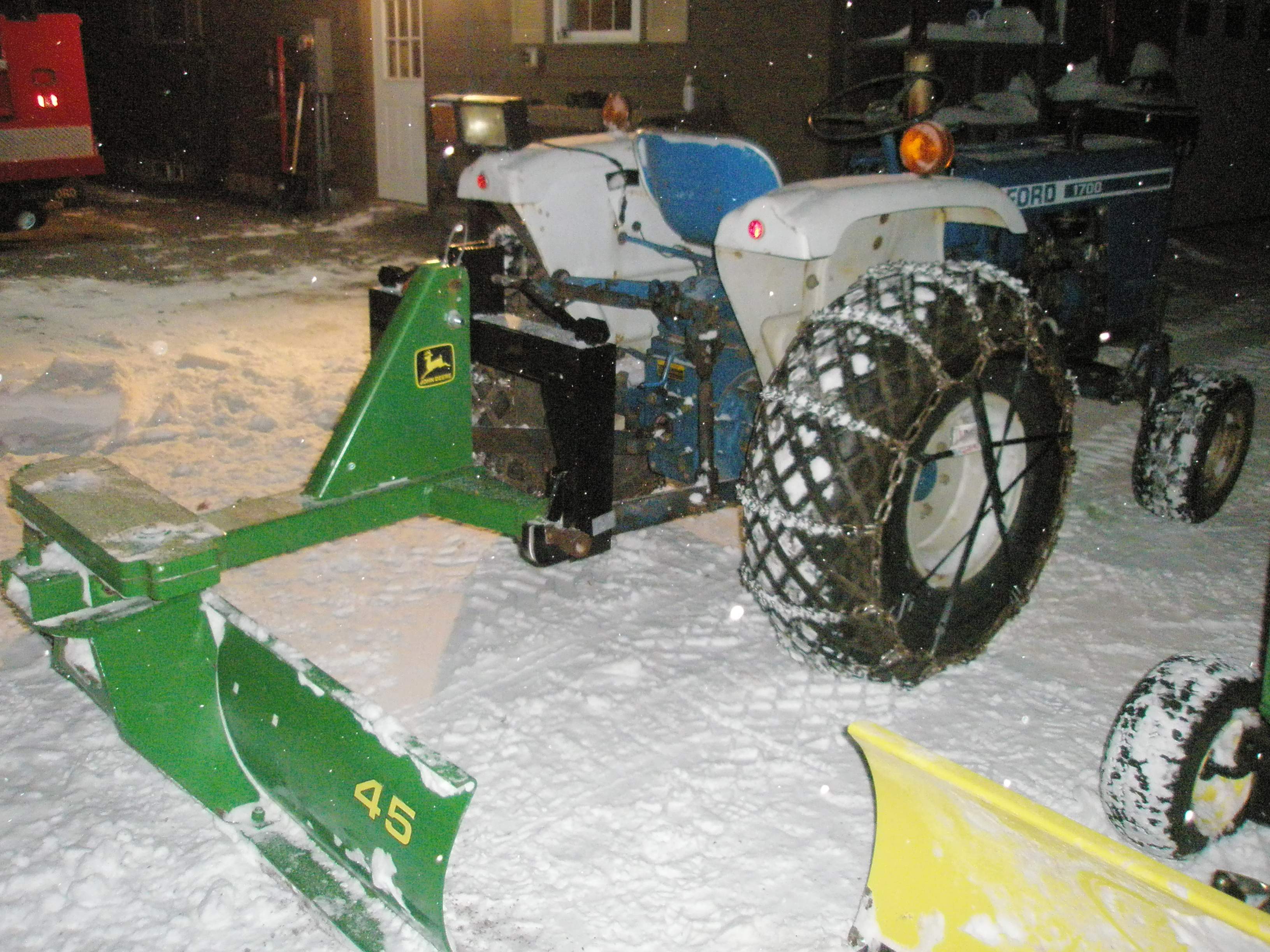

JB4310 what are you thinking mixing blue and green you need to get that blade painted asap or take your pics in black and white.:D:D:D Talking about getting things stirred up start mixing tractor colors.
   / Hydro's and brake pedals #133
You must have a good eye, I edited those picture so much so the tracks in the snow would be more visible, I thought it killed the color already.
You think this would rub people the wrong way :) Ya, we're a mixed up house here.
