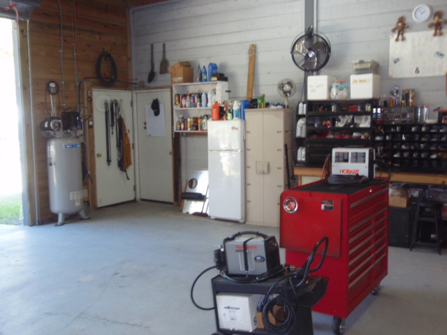

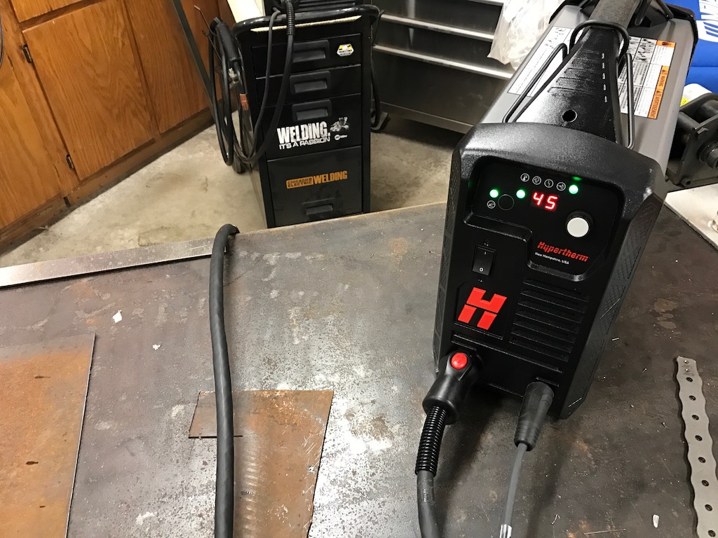

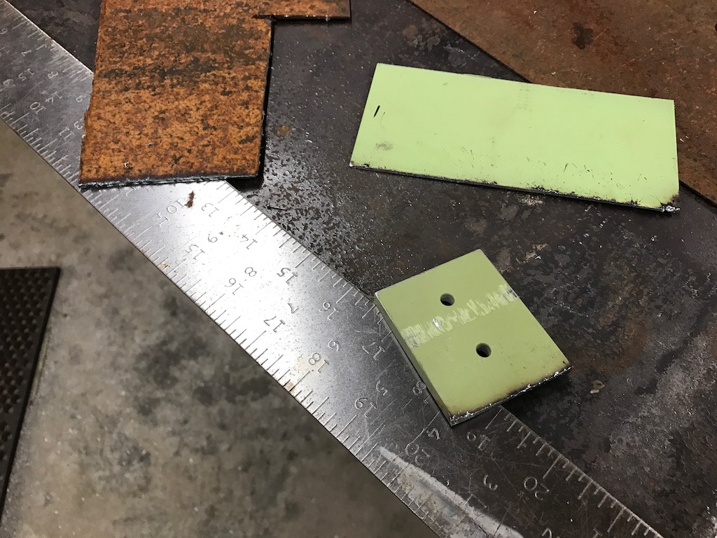

Well Happy, I couldn't hold off. I braved the cold and assembled the 45xp and made my first cuts. Dang fun. Free handed and straight edged a few pieces. 12g mild steel, .080 and 1/4in aluminum. I hope I can someday do this thing justice.

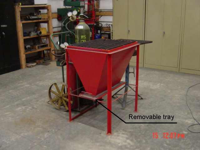

Burning over water is the best way to go!:thumbsup:
What about copying my burning table, and use a shop vac to suck up the smoke? Or incorporate a water tray just under the grate.

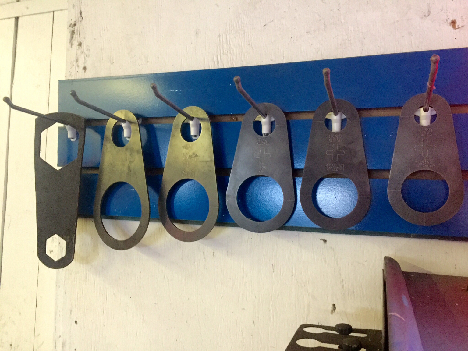

I like to keep a variety of different diameter round (or other) items around for templates. Even an assortment of old fry pans are nice to use for radiuses. (Plus they have handles )

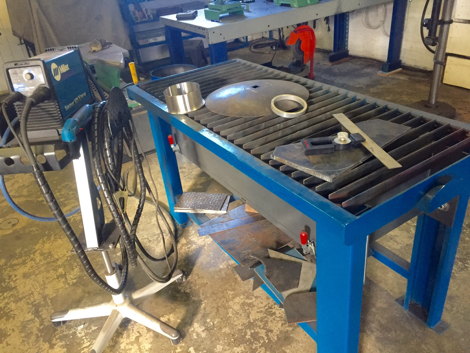

I use a Miller fume extractor with my (manual) cutting table for plaz and O/A.
Hole templates purchased off eBay

I might just do that! Thanks... what are the dimensions of your table? Gonna need something until I invest in a plasma cam system. Time to head over to Pacific Welding Supply for more steel :licking:

Exactly what I wanted to do first is make some templates. I did see those templates on eBay and those might be a quick and easy way for smaller holes. Have to find that link again. Those fume extractors must be good... they want a pretty penny for them! I will need a MacGvyer version for now.

Terry, can you post that eBay link? I thought you posted it earlier but I'm not finding them on eBay.

The grate / top is:
24" X 30"
Top of grate to floor is:
42"
Top of funnel is:
23 1/2" X 31 1/2"
Funnel is 23" tall. Bottom of funnel is 6"
Here's their website. They also have grates to place over your own water barrel. Prolly cheaper than one could make for themselves..
Welcome to 911 Motorsports -

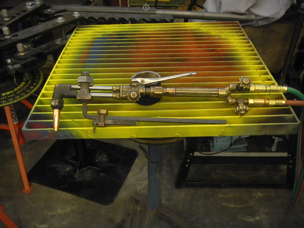

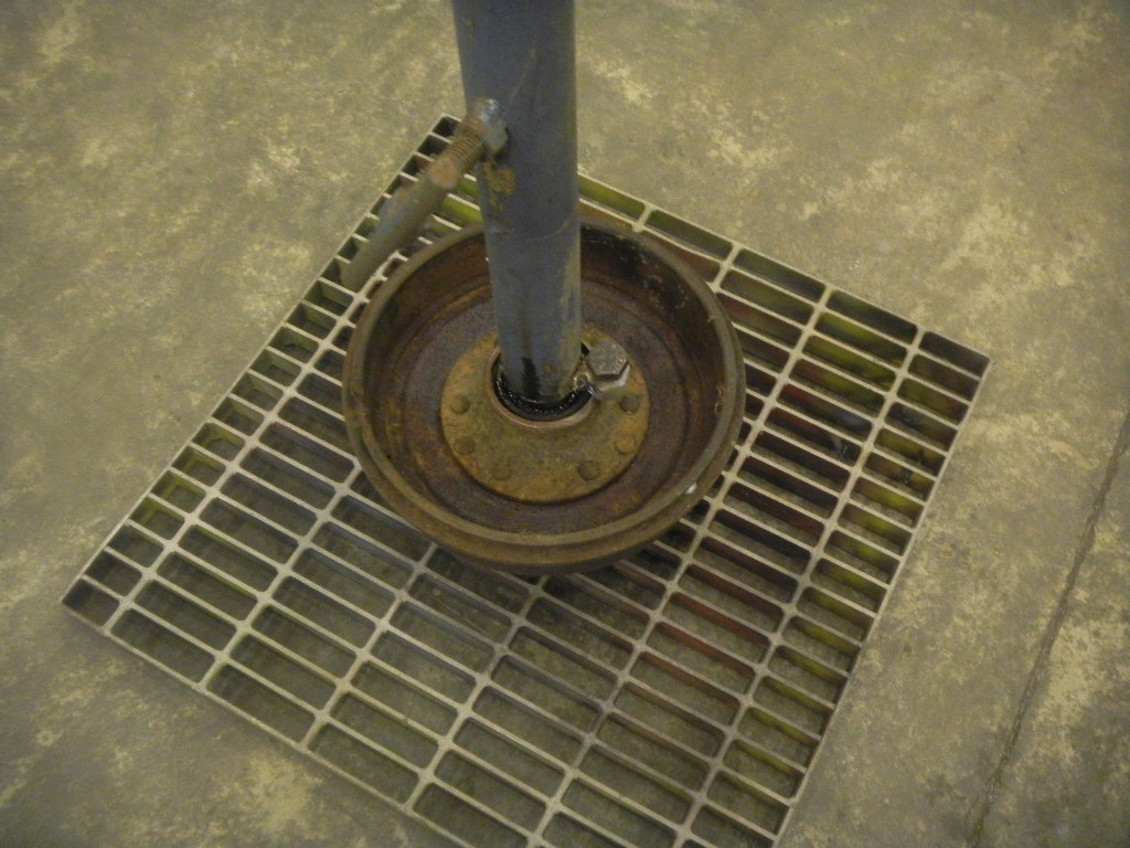

Shield Arc also has a cool ROTATING cutting table. Maybe he can be persuaded to post a pic.
Sure thing!
It works great for burning holes.

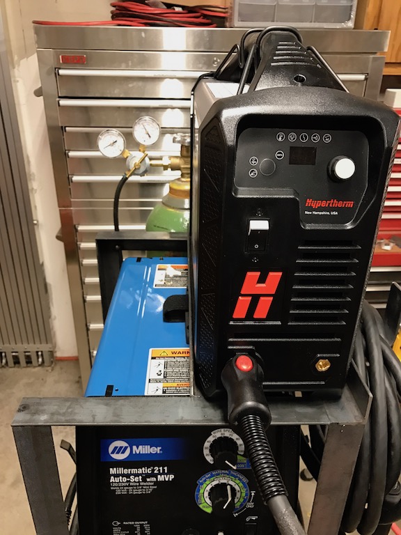

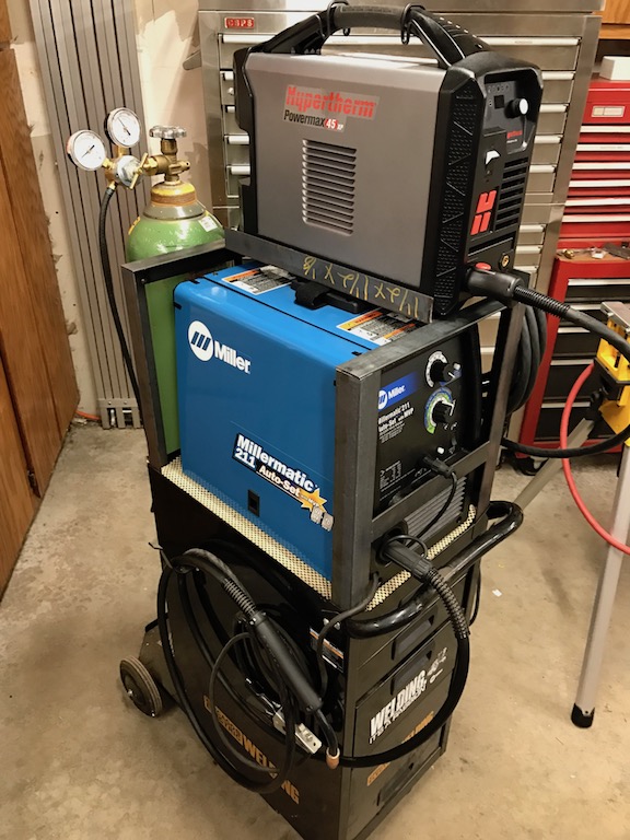

Speaking of tight spaces... while I ponder the table question, tonight I built a rack that sits on top of my Harbor Freight welding cart to hold my new cutter. Got it all tacked together and fitted. Still need to finish welding, blast and paint. It fits the cutter snugly, Allows for the MIG side door to open and stay propped, and preserves the view of the gauges from the front.
Just realized though, my Miller canvas cover is now useless! :banghead: Oh well. Maybe I can get my wife to sew me a custom cover?
It's been a few years since I took welding in high school ag shop, but we were taught to keep all gauges (and regulators) facing upward. Is that still the saftey consensus today, or are today's gauges more reliable? I never thought about that using high pressure nitrogen around our aircraft.

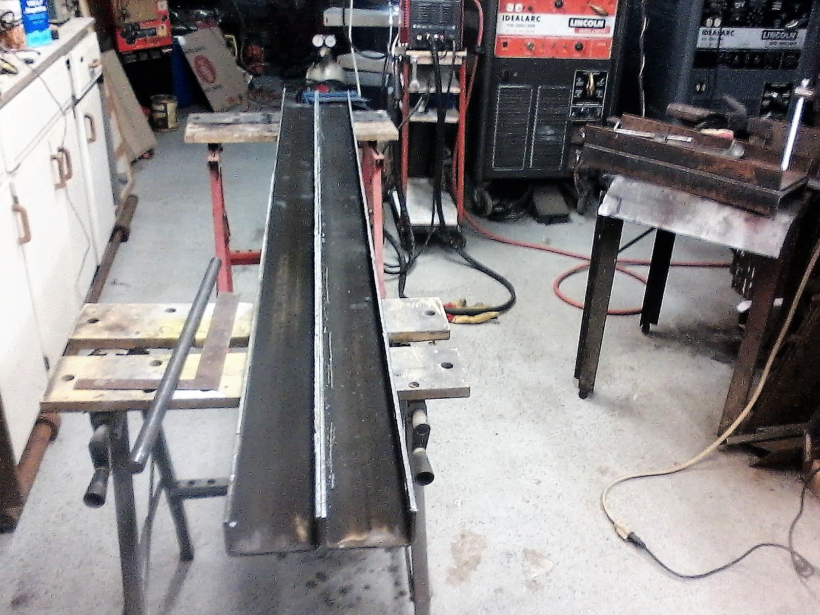

:laughing: Me to ( waiting for the temp to warm up that is)
have been wanting to build a press out of some new and old steel and just couldn't wait either.

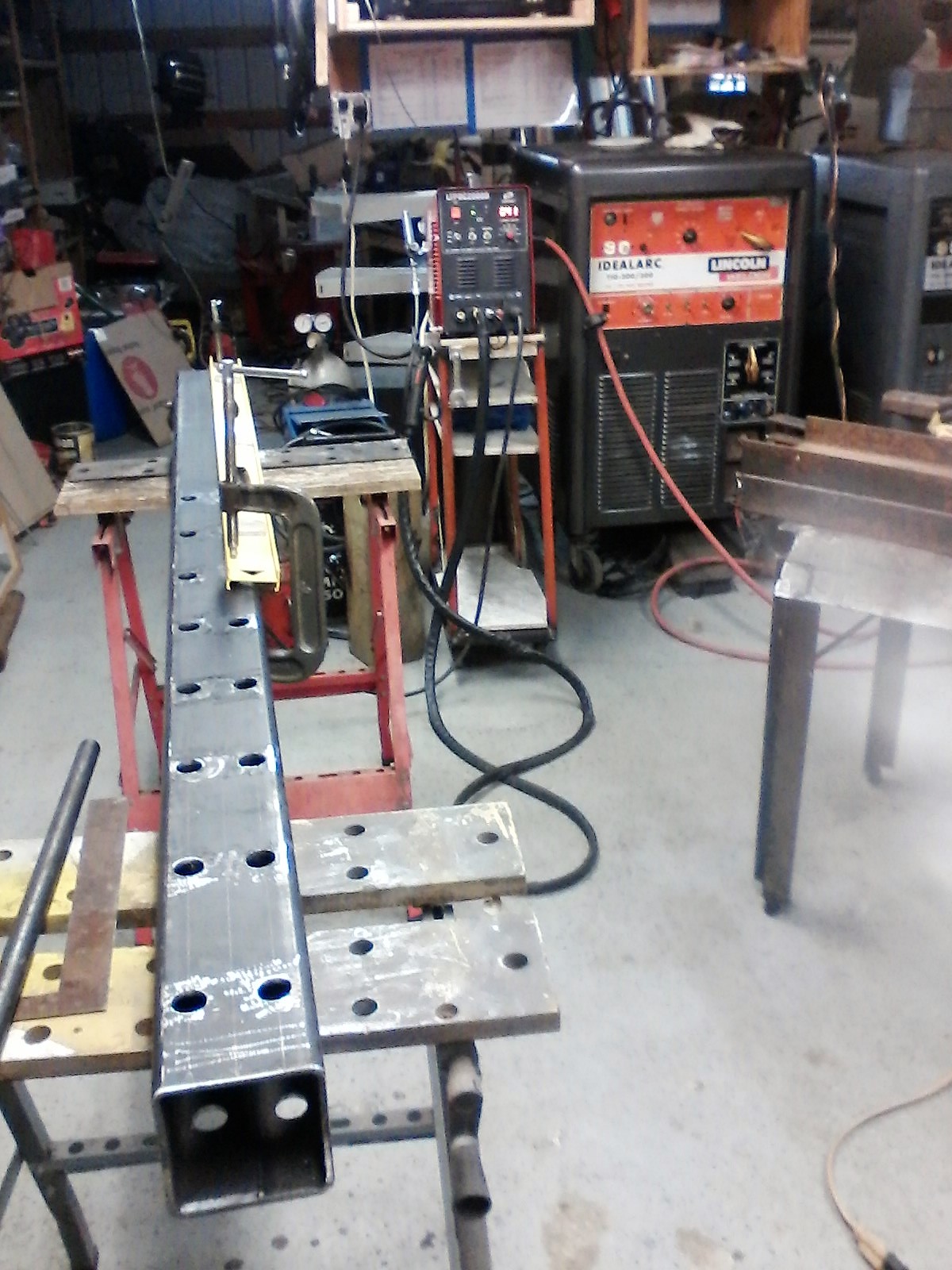

1st drilled some 7/8 holes for pins- and once my uninsulated shop warmed up to a balmy 26* garage temp.jpg went at it with my 3 in 1 plasma cutter/welder press build 1.jpg
press build 2.jpg and split a 6 1/2 foot 4 x 4 square tube for the uprights and also cut some 4" x 8" inch I beams into pieces i could use. It was cold -but worth it to get started on a new project.
