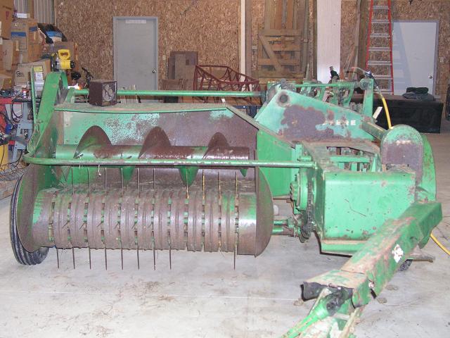

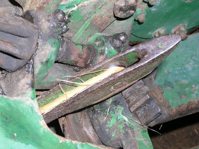

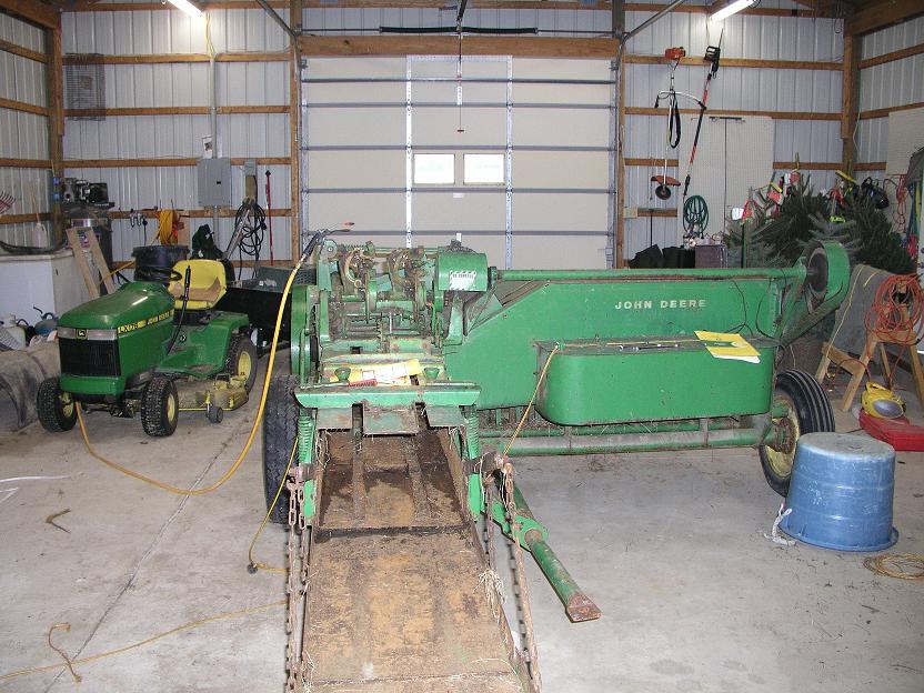

I think I have it know. I was wondering if some one could walk me threw loading twine. And if you are not runnning hay and hand turning what you might think would happen?

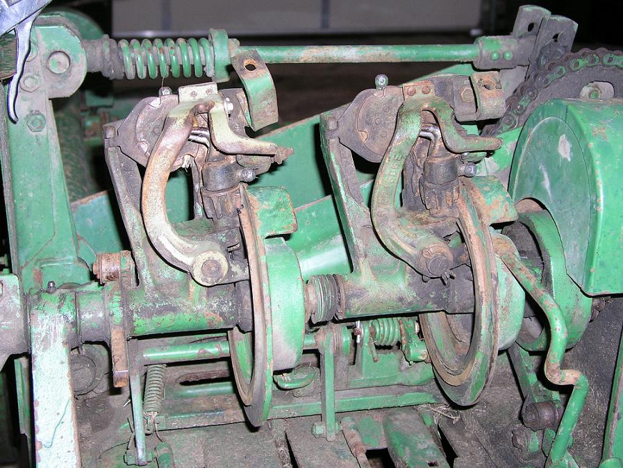

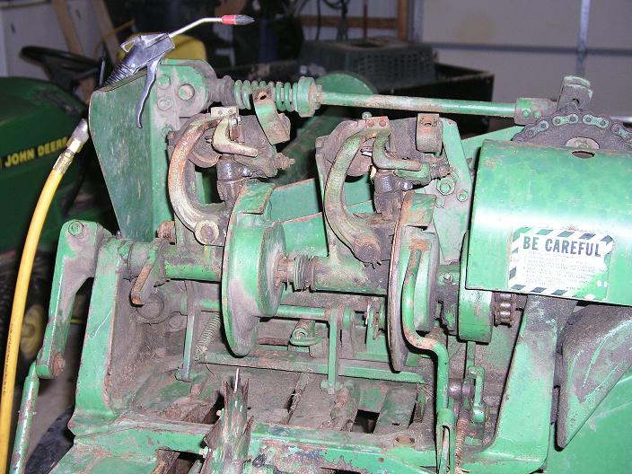

OK, looks like you have the knotter frames pulled up for inspection. Need a picture of the "tucker fingers" (see manual, page 28). You can flop them over free hand by pushing the cam follower on the tucker finger pull shaft. One common problem is that this shaft has gotten bent and one of the fingers is "late" or "early". Its just soft steel. You can bend it to make them run together. Adjust the pull rods as necessary to get them working in parallel. When the knotter is loaded and ready to begin tieing, there should be twine captured in each of the twine disk holders.
Like I said earlier, before I loaded twine into the machine, I would walk it all thru by very small flywheel angle changes to watch the needles pick up and slide across the twine disks, tucker fingers syncronized together to pull in, the bill hooks open and rotate and the wiper arms get punched across the billhooks.
Getting two knotters working is easy once you have one getting the job done. They both play exactly together. See which one is not reading the music correctly. The possibility of weak or broken springs is strong. I see you are using sisal. Was this originally in the machine or was it plastic?

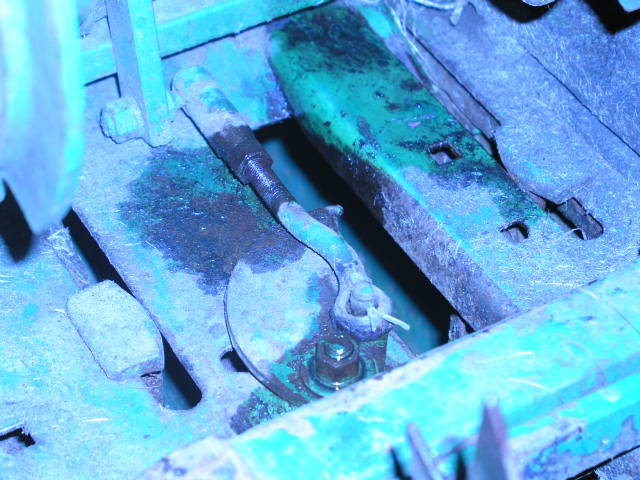

As I further study your pix, It looks to me like the tucker finger drive shaft (parts book page 15 item 3, has been twisted such that the two rectangular arms that come off it are not parallel. Make them parallel: block one with a piece of wood and put a pipe wrench on the other and "adjust" it . You may have to loosen all the stuff there to change the pull rod lengths if you have to bend it and the base mounting position of one of them to get it all back square. Get some grease on some of these parts, too. Looks to be a bit dry as in degreaser + power washer was used.
The two different wiper arms are the result of a rebuild on the left side. Sometime in a previous life the thing got broke and was repaired. If its not all rusty, that means to me that it never worked right after the rebuild and now its yours to fix. The original bust may have caused a jam that twisted the tucker finger shaft. (hope that's it).

I was told this baler was last used in july and worked fine. Thats what I was told. It also had bales of hay that where in it so I had to clean those bales out.
Lets back up a bit. If I hand turn the flywheel, should both knotters go threw a series and ty knots in the string? (without any hay being run threw?) what will happen if I just keep turnin the fly wheel over without any material going threw?
I am not sure I have problem yet. Only because I dont knbow what should happen if I have no material and turning it by hand.

I would not trip the knotter while twine was loaded without hay being packed because nothing will draw the twine through to make a bale loop. This can result in bale loops being caught in the bill hooks. If too many loops are caught in the billhooks and they try to open, then the hook closer will fracture.
Get the thing working without hay and twine. Set the needle lift so that they slide by the twine disks just touching (as the manual says). Get the tucker fingers to draw together (same displacement and angle). Get good flyback action on them (springs). Adjust the wiper arms so that they scrape the billhooks. Get the cutoff knives to be razor sharp with no pits or dings in them. Looks like your knives are riveted in. Buy some new knives, pull the pins on the wiper arms, yank them out and change the knives. Replace rivets with bolts. Test the needle brake to make sure they don't bounce back from home position.
Check twine pull tension with a fish scale at the bale box and the twine disks.
Then consentrate on the plunger stops in the bottom of the bale chute. Clean out their tracks and make susre they have good spring tension. They should snap back into home position when you tweak them.

The tucker fingers should not touch the needles. In fact, the tierods on them had worn swivels which I replaced with rod ends from Home Depot. Remove them for inspection and see if the pins they ride on are worn. If they are their swing motion will be erratic and cause a missed tie. If you can weld, fill in the worn metal with some rod and grind it smooth.
I'll get some pic of my own for you to compare. Note that you can swing the tucker fingers yourself just by moving the cam follower. This action should be fairly stiff. If not, replace the springs on it.
I believe the manual states that the needles should lightly touch the knotter frame as they come up. This is probably to prevent them from getting skewed as they rise.
The baler probably did sort of work, just not reliably. That's what doomed it. Mine had a bent tucker finger shaft, worn billhook tooth, a chipped twine knife and a missing spring on the plunger stop. It only tied on one side. The guy had his 10 year old kid hand tie the missing string.

I have the knotter assembly in the up position
Looking at the shaft drive for the finger assembly arm A and B are not parrellel and should these arms stop against bar c behind them.
when I move the tucker fingers by hand, rotating the shaft drive they (finger tucker both move at the same time. Took a couple more pics of this assembly.
