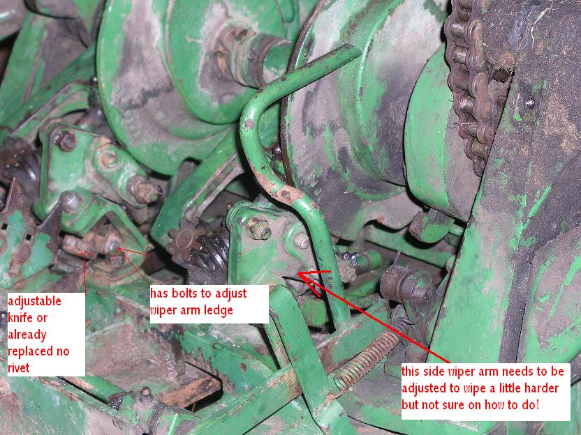

that being said I have 2 questions: 1.) As the wiper arm came across the bottom bill it didnt wipe the knot all the way off the bill. (i do need to check the bill jaw tongue pressure). But also read that bale density to low. I am wondering if my simualtion of a ble didnt acheive bale density. Any Ideas

The wiper arm is supposed to completely clean the knot off the billhook jaw. As it travels across, there is some major friction contact there,. Its not 'close', it's a tough scrape. The wiper arm is soft steel and will wear to conform to the hardened billhook. The manual shows how to "model" the wiper arm to get the job done. "model" = bend. I know it looks like cast iron, but its actually malleable iron = bendable. The working scraper should give you an idea of how much contact pressure is appropriate, but that one may be worn, too. I use 2 large Crescent wrenches to do it. One to hold the wiper and the second one on the first to twist it.

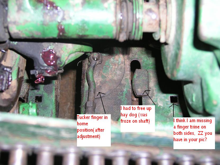

Good thing ZZ said to check the hay dog cause the center one was tied up on its shaft not allowing it too return or move freely. I will get some pics of the things I think I am missing later tonight. O one more thing I thing I am choosing to go with the plastice twine, is their a spec I should get? Tsc had some real thick stuff and thinner stuff not sure on which one to get?\

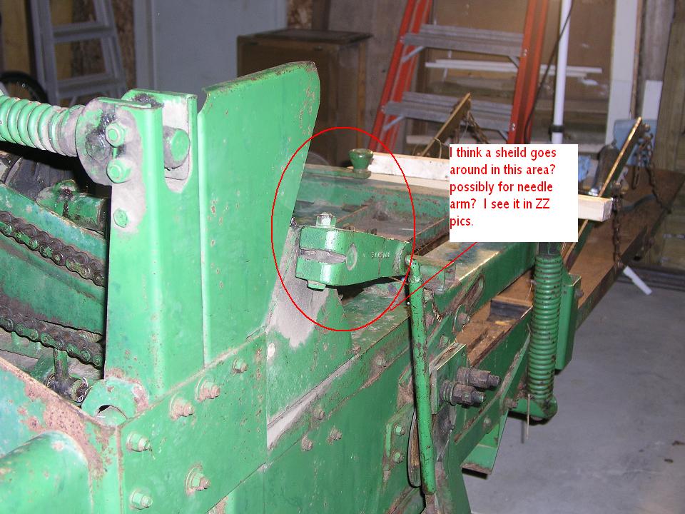

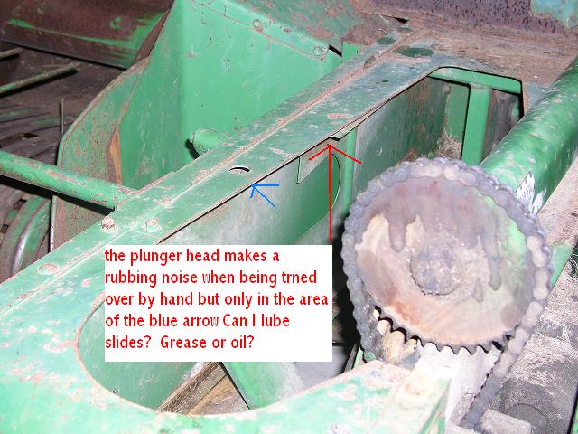

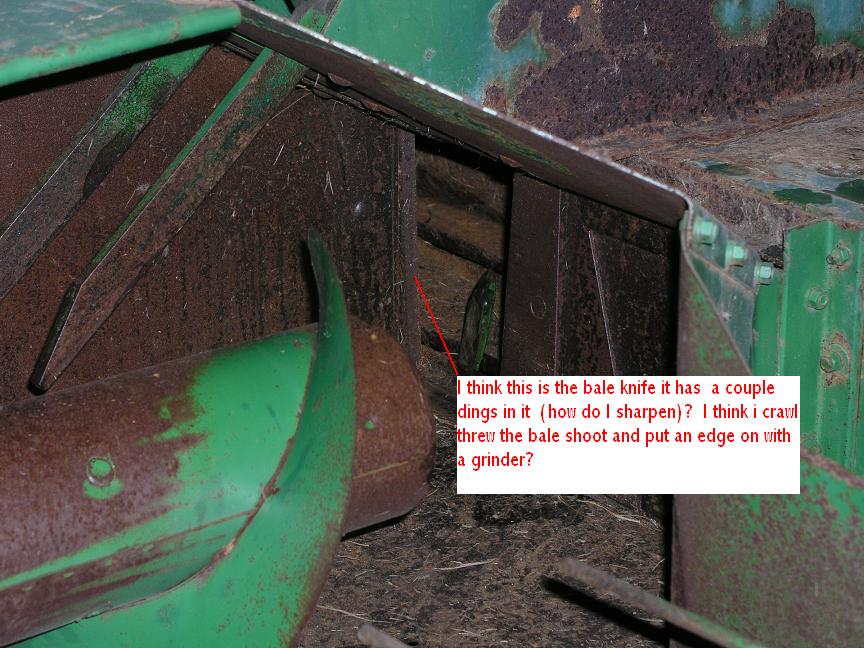

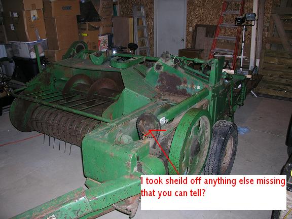

Here are a few pics and questions? :confused: :D
I put down a few questions in the pics: Plus I think I can still order a few parts from JD like twine knifes I think or is their a better place to get parts?

1 If the wipers arms are not of the adjustable type, then you adjust by bending then, As I mentioned previously, use 2 Crescent wrenches: 1 to hold the wiper arm and one to twist the other wrench. Be creative. Or you can pull the Cotter pin and pull out the arm and do it in a vise with several iterations. Watch spacer locations. Getting the arm back in has always been a puzzle for me, like snaking a sewer.

5 You are not missing anything from those square bolt holes. I believe they are for adding extra hay flake holdback shields use when doing very light grass and leaves.
6 Yes you can crawl in there with a grinding wheel and sharpen both cutting knives. There are some flathead screws use to hold them. I never bothered to get them loose. If you have a hammer powered screwdriver, that might work. Need a large one, though.
7 Grease the rubbing parts. Thats what they are there for. Plunger has cast iron rubbing blocks on it to hold the plunger in lateral and vertical position. Newer balers use ball bearing races.
8 Yes a shield was there. If the knotter trips while you are there working on it, the needle lift will chop your arm off on the upstroke. Its a clean cut, so just save the parts and have the Doc sew it back on, especially if its your bathroom wiper arm.

That's my top 10. Get some good hay bales (3 or 4 ). load the twine. Fire it up, toss in some hay and cross you fingers. When operating, the bale case holds 2 or 3 complete bales. Don't adjust the measuring wheel or bale tension (unless you backed the screws completely out) until you have made a round out in the center of the field.
