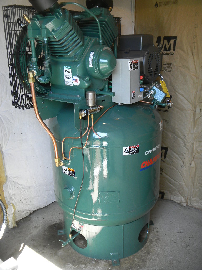

Can you really get 7.5 hp on a single phase line? How many amps would that pull on startup?
I bought that same compressor awhile back. I have it on a 60-AMP breaker, starts and runs fine. Really quiet running compressor. :cool2:
