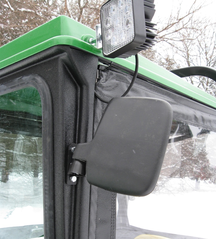

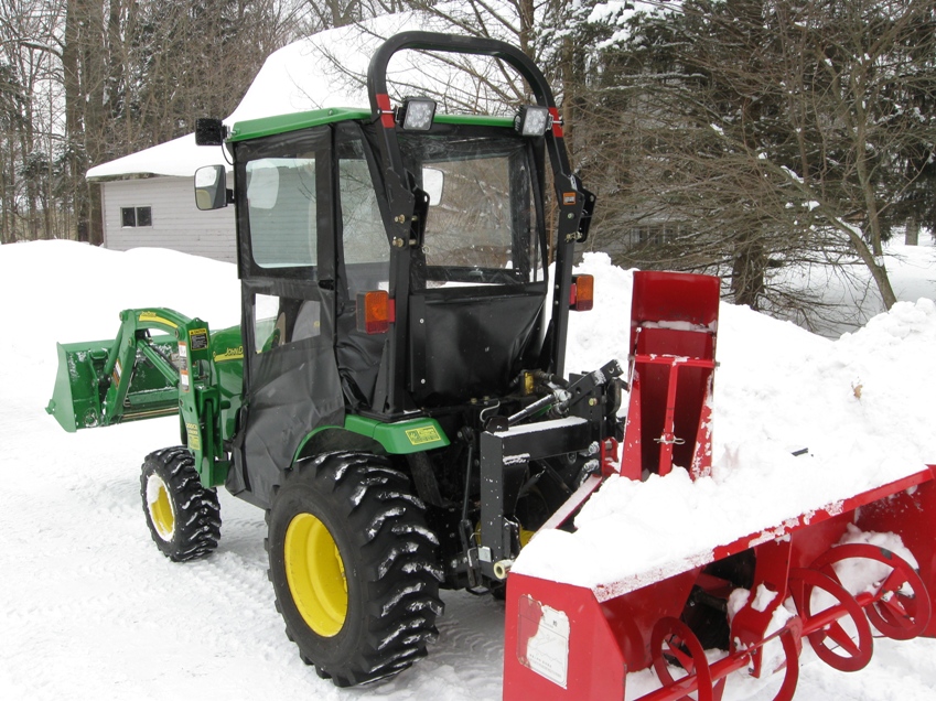

I added the $30 Amazon golf cart mirrors to my 2320 with OTC Hard Top Cab. The windshield frame has a good surface to mount it but it had to be mounted high. The mirrors, as supplied, would not rotate enough to see down to the edge of the snowblower. I fixed this by swapping the mounting brackets between the right and left side mirrors. If I need to fold them, I will fold them forward because they will keep the doors from opening otherwise. Almost no vibration at this location.

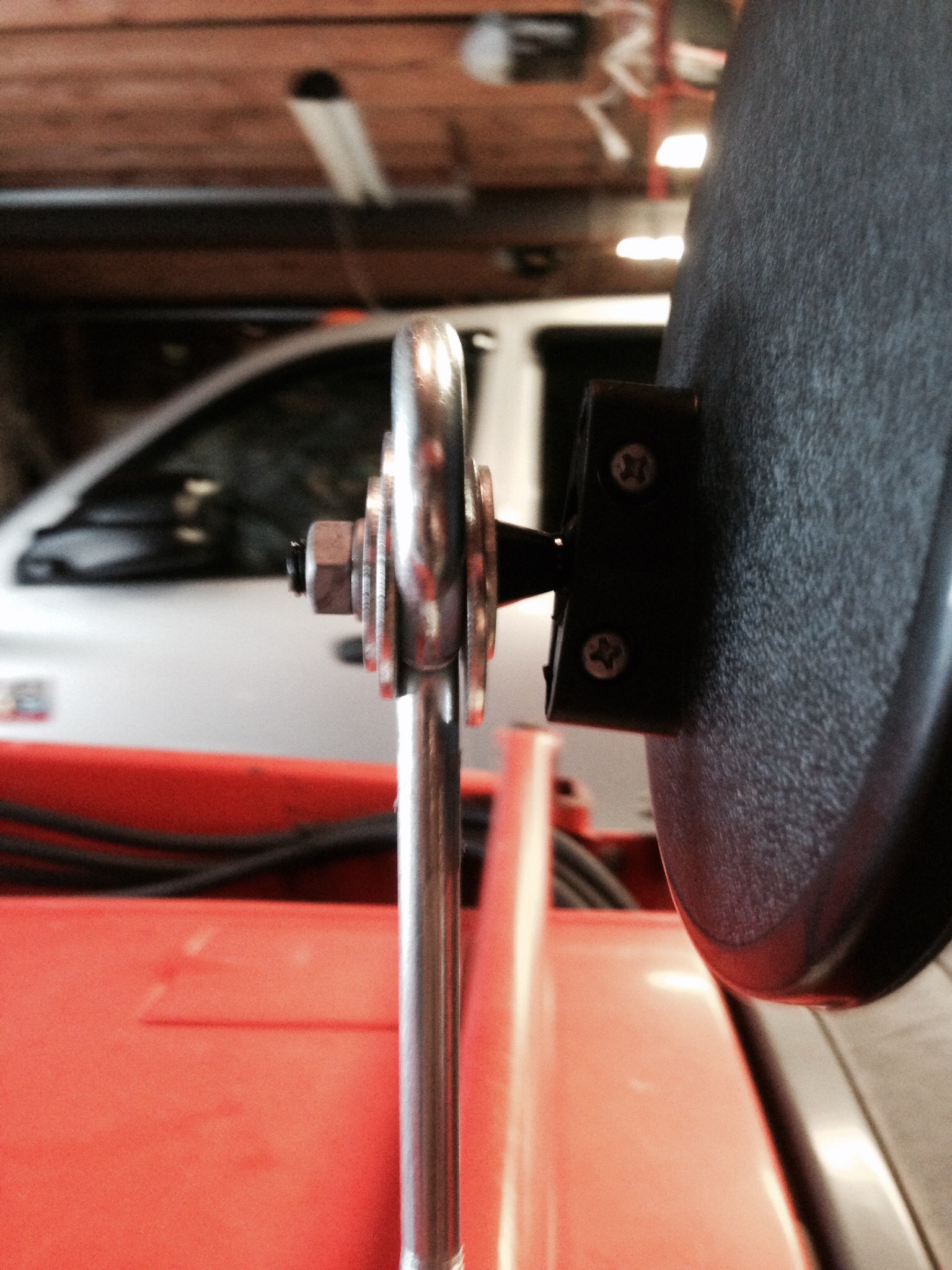

Can you send a photo of the back..would like to see how you attatched the mirror to the bracket.
Is this a $6. Auto Zone CONVEX mirror? Thanks-John
   / I can finally see.... backwards #40
Yes this is the Convex mirror from AutoZone. It was $9.99 where I live.
I think you could improve upon how to mount it compared to how I did, but essentially the "clamp" has a 3/8 thread that you can add a bolt or in my case I used an eye bolt and then a few washers to take up the extra space. See pics attached.

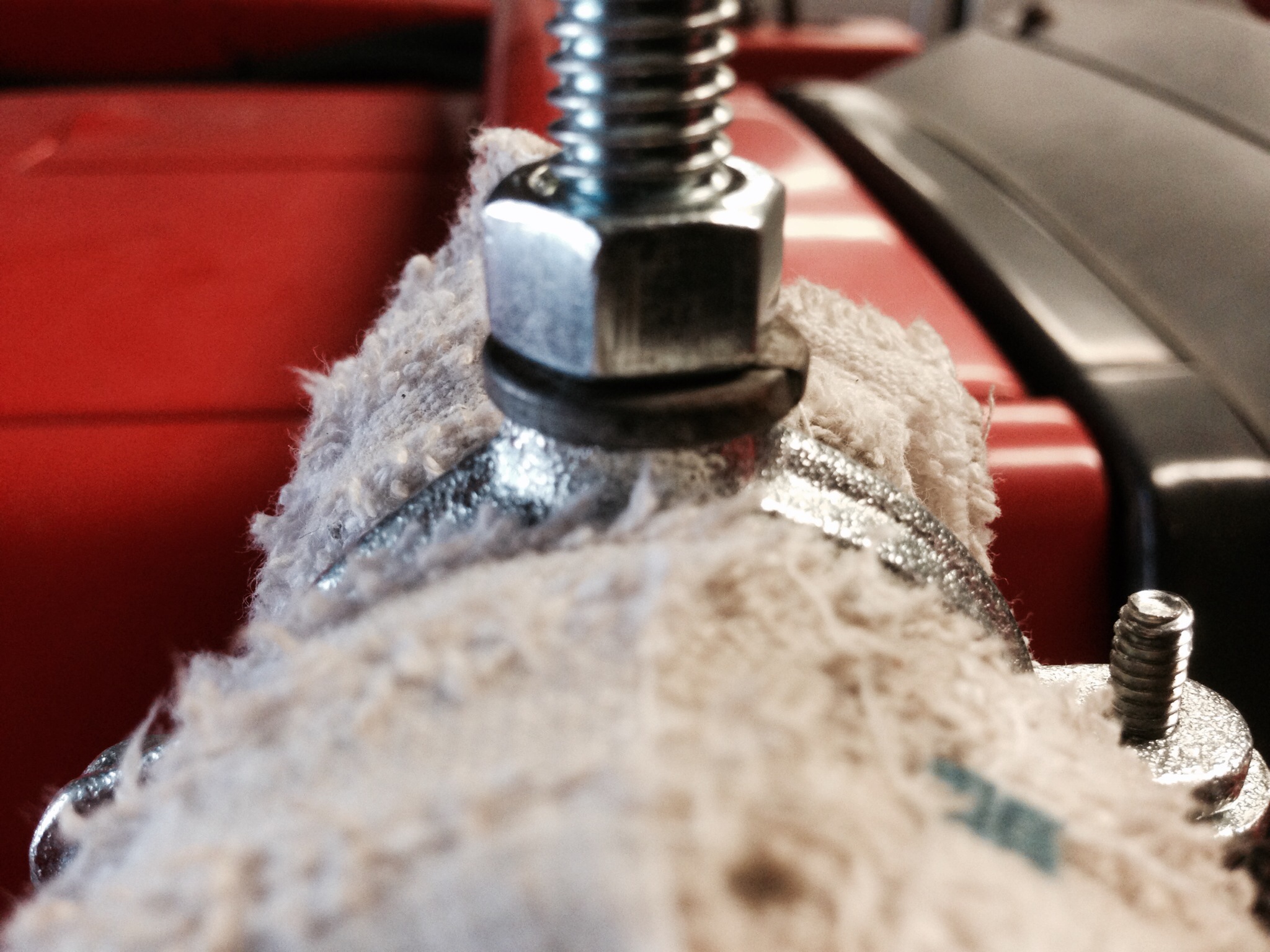

This image shows the 3/8 eye bolt I used. I added a lock washer and a nut to make sure it didn't come loose. This is also a pic of the larger (1 1/4") bracket that I had before I got the right size, but you get the idea...
