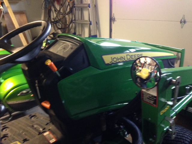

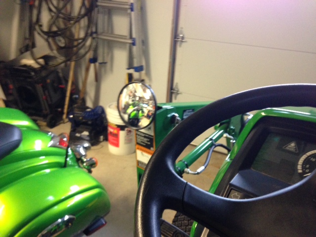

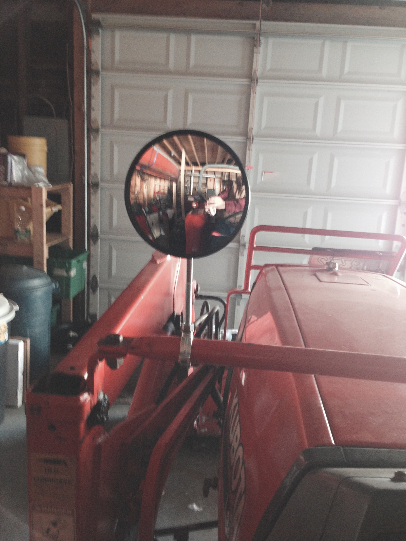

What kind of clamp is that with the threaded hole, and can I find one? Looks like a good design for mounting onto the cross brace. Eye bolt looks good.
Thanks for the photos.
Do you find the convex mirror difficult to use? I mounted mine a few days ago and thought it was difficult to use. Maybe just not used to convex??
I have not started the tractor yet to see how the vibration will be?? I mounted mine with a flat bracket to the bolt securing the cross brace..a few inches from where yours is.

It's called a Split Ring Hanger. You find them in the plumbing section of Lowes, Home Depot etc...
Here is a link to the one I bought at Lowes... Just remember what I learned which is the 1" split ring actually has a 1 1/4" INSIDE diameter which is what the diameter of the cross brace on my tractor is.
Yeah, the convex mirror takes a little getting used to, but for making sure nothing is behind you before you back up, it serves my purpose. That being said, if I found a regular mirror in the same price range, I'd likely change to that. I have very little if any vibration with this setup.
Very cold and snowing like crazy in NH today. 12"-18" of snow between today and tomorrow (Friday) morning. Lots of seat time on the Kubota tomorrow morning! :)

I finally found the right size clamp. The "bar" is 1 1/4" diameter so you would think the 1 1/4" clamp would work. Not so... turned out the 1" clamps inside diameter is actually 1 1/4". Weird, but now I know.
No vibration with this setup either...
That's because those clamps are made for hanging iron pipe, and iron pipe is referred to by its nominal size, so 1" iron pipe is slightly more than 1-1/4" OD (1.315"), and 1-1/4" pipe is roughly 1-5/8" OD (1.660").
