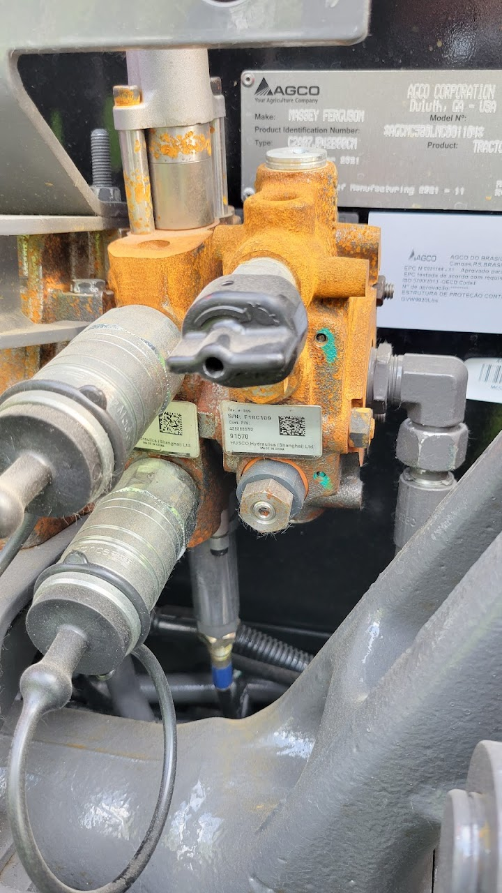

Wire wheel/sane as needed. then buy a POR15 starter kit, which comes with everything you need to prep and coat that valve, and a lot more.
If you don't know about POR15, it is a 2 part coating that when cures, will never crack, chip or peel, and the more moist the environment (just humidity), the better. You can buy it in only a few colors, but it can be painted once cured, if you want something other then what is available.
POR15

Edit, here is a close up of the remote. It feels like they just took something off another tractor - the handle in the cab is different as well. If this is normal then whatever, but I'm not going to pay for an upgrade I didnt get (3rd remote)
View attachment 749067View attachment 749068
:oops: Yeah that is not acceptable. That would not sit well with me either.
Looks like it wasn't painted and whatever they had on it to prevent rust until it was is gone.
Hit it with Ospho convertor and paint it. You can wire brush it first if you want.
Yeah, you would think they would paint it or something - IDK it just feels really cheap to charge 1500 for a remote and its completely surface rusted when it arrives hah. I'm going to be using that POR-15 product people have mentioned.

It's like having a red door on a blue pickup.
The non-painted remote is one thing, but the mis-matched lever in the cab...I'd tell them to order me the correct lever for that year and model.
Pay $60,000 for that. Kind of like ordering your new Super Duty pickup and they put a bumper on from 150.
   / I did it. Roast and discuss my choice. (sharing experience + numbers for others) #100
Wire wheel/sand as needed. then buy a POR15 starter kit, which comes with everything you need to prep and coat that valve, and a lot more.
If you don't know about POR15, it is a 2 part coating that when cures, will never crack, chip or peel, and the more moist the environment (just humidity), the better. You can buy it in only a few colors, but it can be painted once cured, if you want something other then the available color.
POR15
POR 15 requires a top coat of paint if exposed to sunlight.
It can do all of those things you mention it cannot do if not top coated
When it originally came out, it was sold as a single coat solution. Then the stuff started to chip, peel and disintegrate.
It then became a "two coat" solution as a result.
Its great stuff otherwise.
