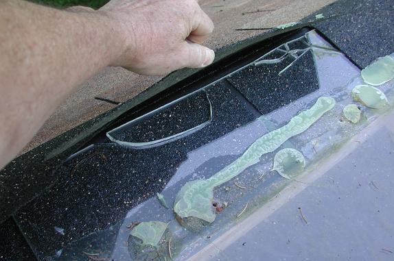

If you do use plexiglas for skylights remember where it is!
I forgot and drove roofing nails into one sheet. Still had no leaking over the years.
That is some silicone rubber calking I put on top of the plastic at the top to help hold the shingles to it.

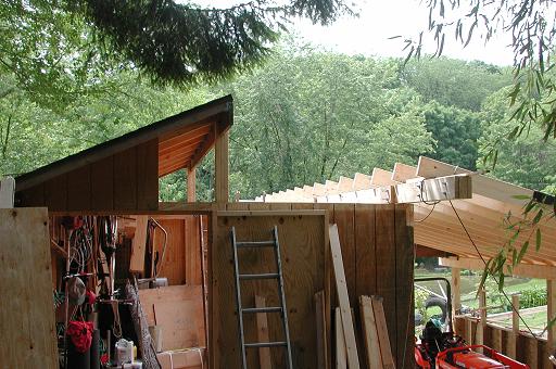

#102
Last shot of what was before ripping off that half of the old shed roof...
Demolition is always twice the work of building new! At least it is for me...

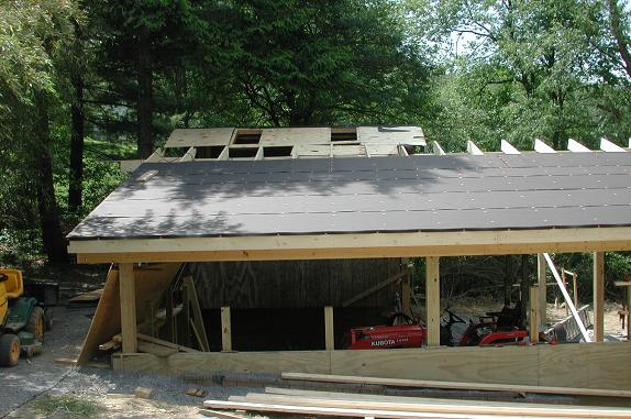

#103
Turned into another LONG, busy day.
Don't even think I took another look at the pond the rest of the day...

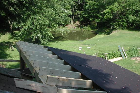

#105
Demolition is done! Yippie!
Now to start putting up the rafters that will bring the new roof slope up to the existing ridge line...

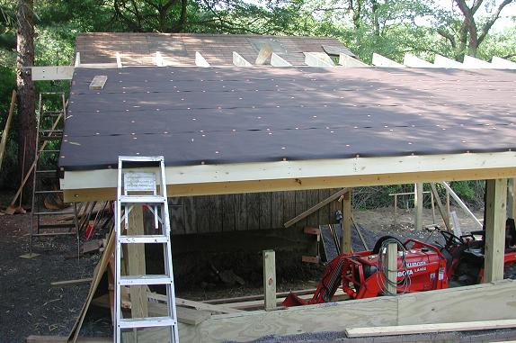

#106
The same shot from a different angle.
After this point I started to get worring about the amount of daylight left I guess, because I did not think to put on the photographers hat anymore...
Rain predicted for the night...HAD to get the roof over the old shed on and papered!
And I did, but was nailing the paper on in the dark, more by feel than sight. Literally. Finished around 9:30 PM...
It was a LONG day...[where is that instant face for "tired as He**?]

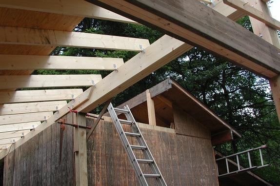

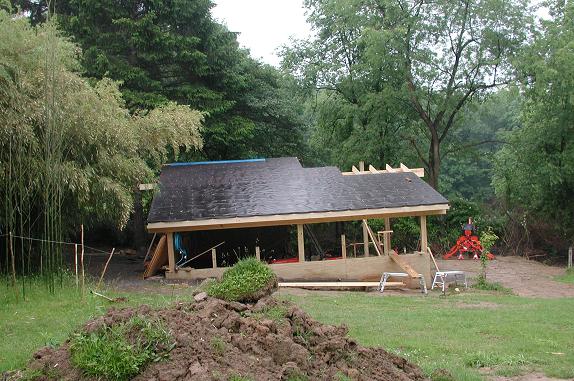

#107
The picture I couldn't get at the finish last nigh.
The roof now is continuous up to the roof line of the old shed.
What old shed? I like it when a plan comes together...
   / I feel like Spencer junior! #108
Bill,
Why not put the plexiglass sheets under the shingles all around? Is there an advantage to only placing under the top layer?
#109
<font color="blue"> Why not put the plexiglass sheets under the shingles all around? Is there an advantage to only placing under the top layer? </font>
I think the advantage would be that if you put the shingle on top, they would hump up rather than lay flat on the roof.
Also, you do want the plexiglas to to over the top of the shingles at the bottom end...so the transition from shingles on top on the sides, but under on the bottom might be difficult.
In a sense, doing it the way I did lets the plexiglas mimic the normal lay of a shingle...under what is above and over what is below.
Seems to work pretty good this way, but if you look close you are able to see the silicone rubber under the plexiglas.
But normall for a skylight, no one is ever close enough to tell.
