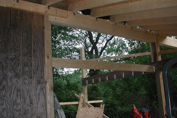

To maximize headroom in the loft, I am using joist hangers for the 2x8 floor joists at the outside end.
On the inside end, these floor joists will sit on top of that 2x12 that runs across the middle of the old wall.
This picture shows one floor joist sitting in place [not nailed yet] and the remaining joist hangers waiting for thier joists...

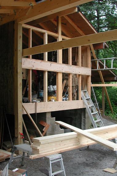

#122
Quit early this evening, about 6 PM. Instead of using that old plywood, I used a poly tarp...faster and easier to take back down in the morning.
I hope it does not get blown off if we get a thunderstorm this eveninng!

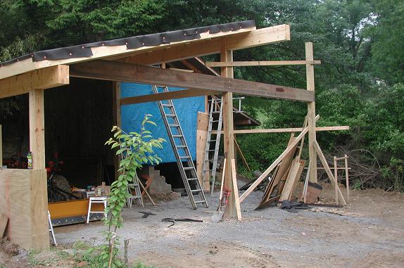

The tarp came off easy and surprisingly, I don't think we had any rain overnight...
I cut the floor joists to the right length and started putting them up. The first is in place in this photo.
