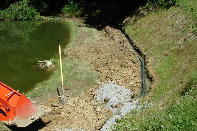

   / I feel like Spencer junior! #243
I put a 4" pipe across into the pond. Now water will flow which ever way it needs to to keep the water level in the pipe along the bottom of the bank even with pond level...

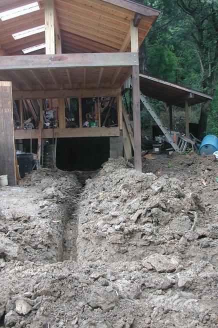

   / I feel like Spencer junior! #244
Back at the shed, I wanted to be sure that water that might seep into the old spring house foundation would have a sure way out...
So one more trench was called for...

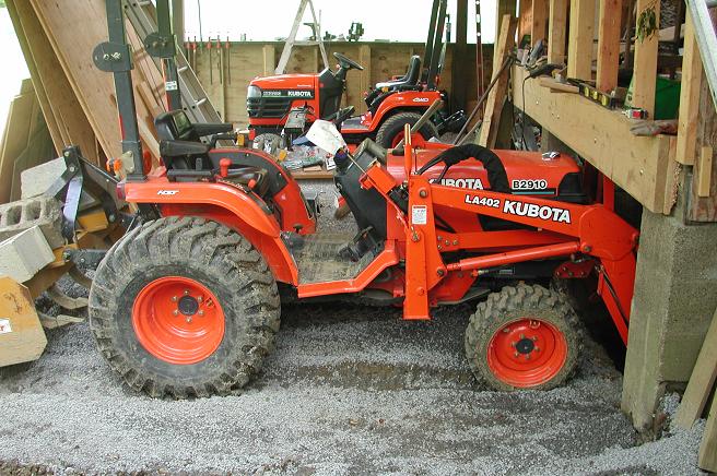

   / I feel like Spencer junior! #247
The B2910 was just perfect size for getting the bucket into the old spring house foundation, which I had to clean out. Was a real mess in there...old pump, mud filled catch basin, and so on...forgot to take a picture at the start...

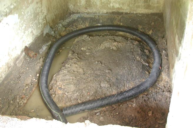

   / I feel like Spencer junior! #249
Drain pipe that runs into that new ditch...
I did not want to dig too close to the walls as there is no footer under them from what I can see...

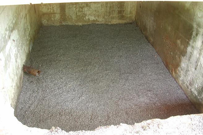

   / I feel like Spencer junior! #250
Much nicer in there with a crushed stone floor.
I will have to wait until I get a torch to cut off that steel pipe...wish it would have been cast iron!
