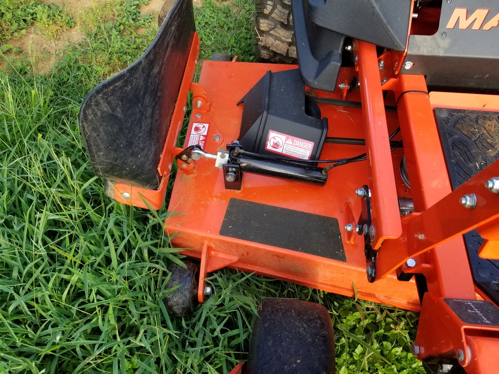

The first mod I did to my Bad Boy was add a shoot lift. It's always up in high grass but it's also handy near fences, trees and buildings. I just happened to have a couple of convertible top pumps and cylinders. I wired one set with an on-off-on switch so I can raise and lower the shoot at will from the seat. Oh yeah, I also added "step tape" to both sides of the deck.

Just a word of advice. Be careful when mowing with the safety chute raised, my son has a scar by his eye, and last year my daughter had a window taken out of her car by a mower that threw a stone.
At least where I am it is illegal for a dealer to repair a mower and return it to the owner if any safety devices are removed or not functioning properly. Also a good way to lose your bank account when it gets emptied by an ambulance chaser.
