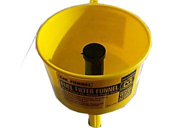

5. Use a Mr Funnel any time you are adding fuel from a can. funnel_fuel_filter5.jpg

How does this 'Mr. Funnel' filter water?
Not sure if this works the same, but a screen wire of fine gauge can allow fuel to pass but traps water. My Dad used one from the 1940s that worked that way so it is not new technology.
