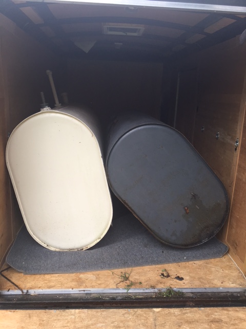

Purchased 2 Obround Tanks for my outdoor farm diesel and gas tanks. They aren't in bad shape, but certainly do need some cleaning up as well as mounting on a base of some sorts. Both were used indoors as heating oil tanks up until about a year ago. Both have caps on all holes on the top. I have yet to look inside and begin cleaning them up.
I do have some questions:
1. Neither have a bottom drain. Someone said to make sure that there is a drain at the bottom, and I can see the point. But... what can I do about it? If I get them all cleaned up, should I try to find a local welder and have him cut a hole and weld a drain pipe/outlet of some sort onto them? Any recommendations as to what type of drain/valve work best in this scenario?
2. I have yet to open them up and look inside. I suspect they will need cleaned out in some fashion. I've read about powerwashing them etc. Is that your recommendation as well? If I do this... how do I get all the water out before I add diesel?
3. I saw a video on YouTube in which the guy 'cleans them up' then coats them with Herculiner prior to final painting. Any thoughts about how well this would work? Does paint STICK to Herculiner well?
4. Concerning the top holes. I will need a least 3, but I don't know what sizes are required. Both have 3 holes. I would need one for the pump, one for fill, and one for a site glass. Am I missing anything? Also, how big do they need to be? Especially the 'FILL'? I'm not sure the size of the delivery nozzle, so I want to insure I have sizes that work. (I'll certainly contact the delivery service, but I'd like to know what size you've found best/required)

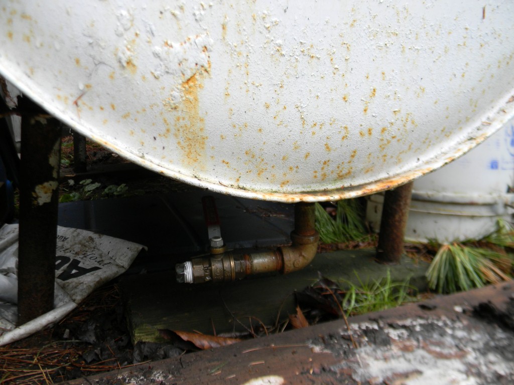

I would have a welder drill a hole and weld a threaded bung on the bottom so you can pipe a drain valve on it. I use a standard ball valve for a drain. Hard to believe neither has a drain hole. I have 3 tanks and all have one.

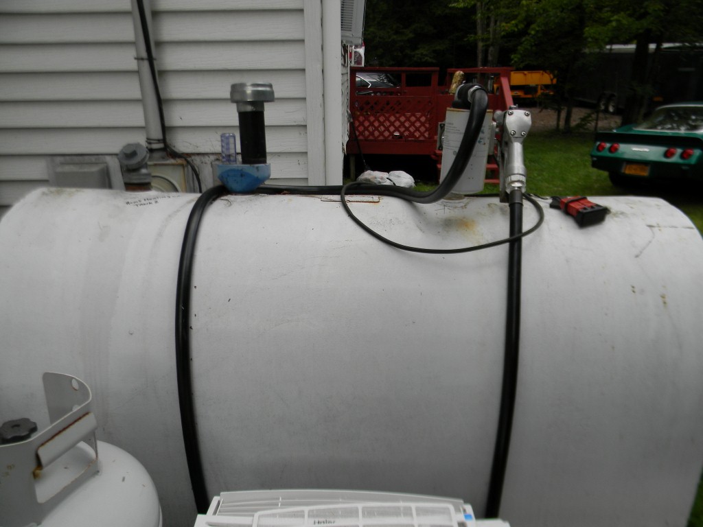

I use one of these combination fill alarm and gauge for one 2" hole. add a 2" nipple and put the vent cap on top. Some oil companies require this type that has a fill alarm.
Amazon.com: Oil Equipment Mfg 4523 KING Oil Tank Combination Fill Alarm And Tank Gauge: Home & Kitchen
My pump goes in another 2" hole.
Filler pipe with cap goes in the 3rd 2" hole. With this type cap the oil delivery co. can screw their nozzle right on.
2" Oil Speedfill Adapter 45 Degree: Female Thread - - Amazon.com
Amazon.com: Oil Equipment Mfg 31 SpeedFill Oil Tank Fill Cap: Home & Kitchen
You also need a vent cap and a couple 2" nipples.
Amazon.com: Oil Equipment Mfg 1439 Oil Tank Slip-On Vent Cap: Automotive
Or you can use the standard lockable flip style cap.
Amazon.com: Oil Equipment Mfg 4171 Oil Tank Hinged Fill Cap: Home Improvement

Yes, I have 3 - 2" holes on top. One on left is the fill. Center is the gauge/ alarm/ and vent (all three are in this style gauge). Right is the pump.
If you buy the locking flip style filler the delivery truck nozzle has a pipe extension that goes in the tank just like it would at the gas pump when you fill your car. If you opt for the style like mine, they unscrew their nozzle and screw their pump directly onto the pipe when the cap is removed.
My drain is only 1/2" which is the size of the threaded fitting that was on my tank. If you have to add that fitting I'd make it 1". I would have gone with 1" if I didn't have a drain. I also took a piece of 6" long 1/2" PVC and jammed it in the 1/2" nipple before I screwed it in the bottom of the tank. That PVC nipple sticks up inside the tank off the bottom about 4-5" so the drain doesn't get plugged with sediment if I need to drain it.

Those pics were very helpful. After seeing them, I checked my tanks.
Went and looked at the VERY bottom of mine, and I DO have drains, plugged and ready to go. That wasn't the location of a drain he had on another tank that I didn't take. It came out of the flat side at the bottom, so I thought that was the 'best' place for a drain. Mine are small, probably 1/2" as well.
I also have 3 - 2" holes in the top. So no Welder required to get me up and running.
