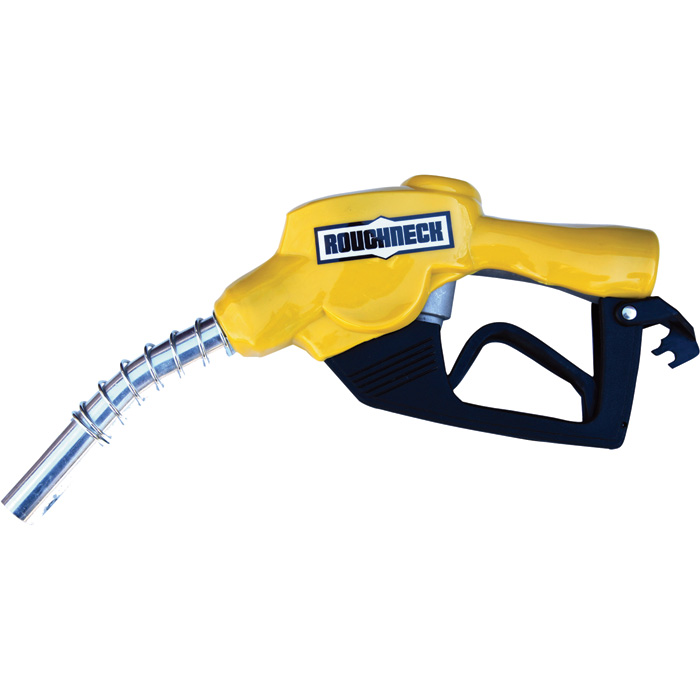

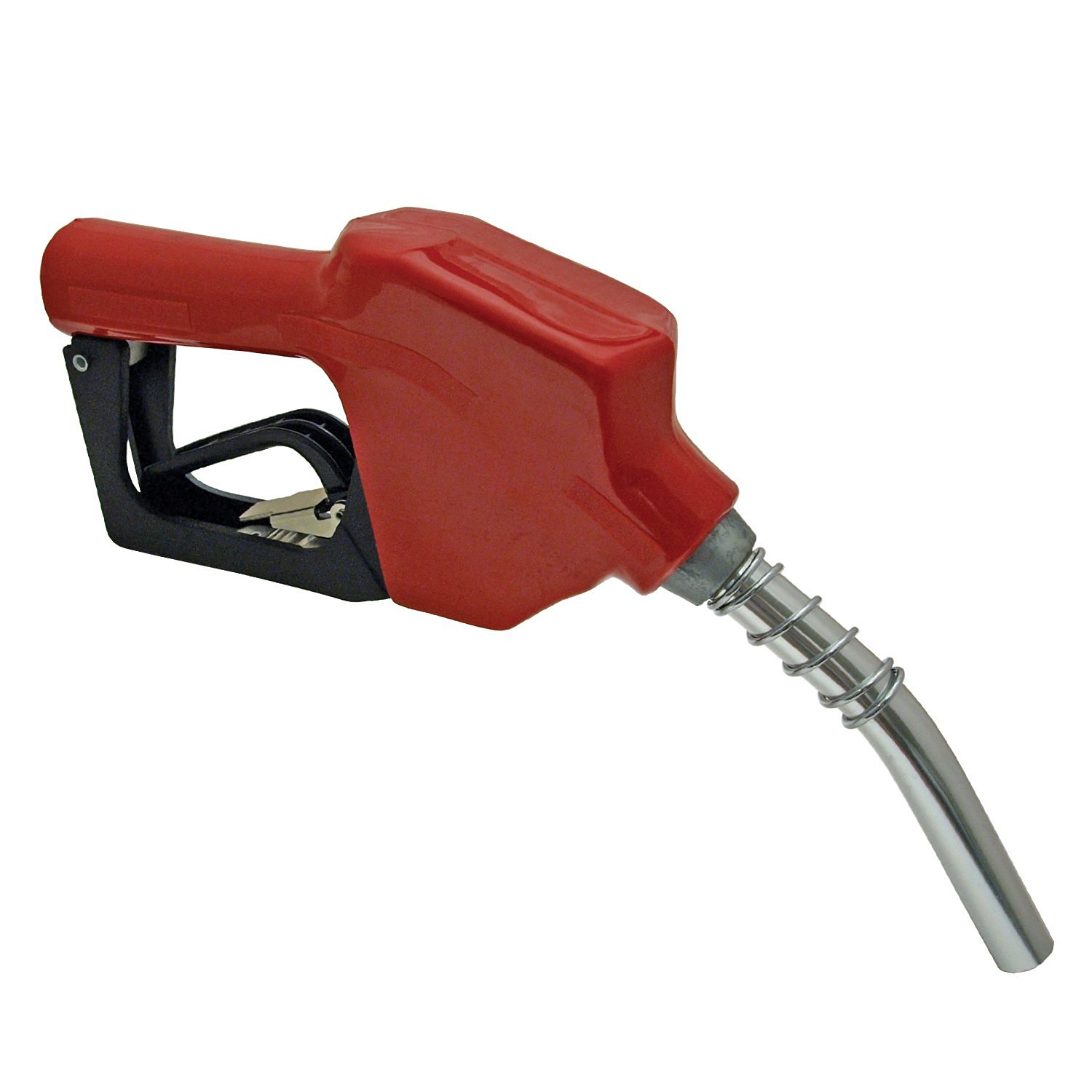

By the way, has anyone found a good way o prevent diesel going into a gas tank... Or vice versa? Nozzles are all the same on farm pumps, aren't they?
   / I have need for a farm diesel tank. ? Obround tank for outside farm fuel storage? #53
You can get different color nozzles for gas or diesel.
