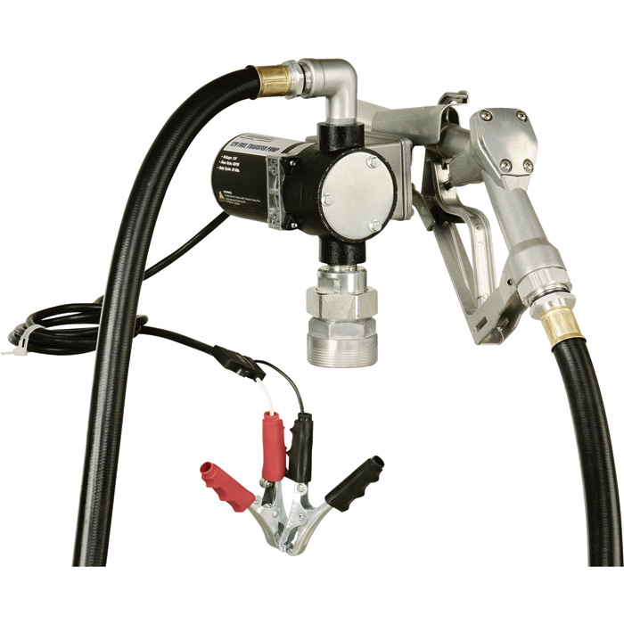

How are you using these DC pumps? Do you hook them to your Tractor's battery each time you pump?
That's how do it ... at least until I replace the accessory outlet on our Kubota.

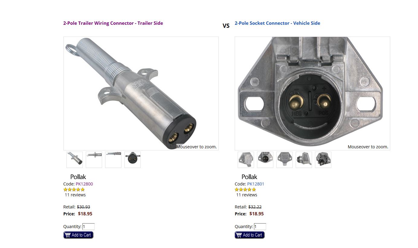

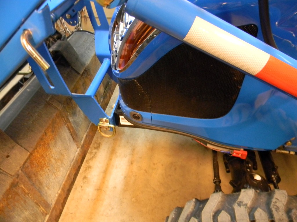

You bring up an interesting point, that I'd not thought about. I can wire these into a plug, then wire a plug receptacle into the tractor. That would allow me to simply plug in to the tractor and run the pump.
Yup ... makes hooking it up easy-peasy ... :thumbsup:
I just used an el cheapo cig accessory receptacle from Autozone ... unfortunately the rubber cap on it deteriorated and let it get wet and it rusted.
I got a very nice waterproof marine accessory plug from West Marine to replace it with, just haven't got around to doing it yet.

How are you using these DC pumps? Do you hook them to your Tractor's battery each time you pump? Do you have a battery in a box that you simply hook up and keep there, recharging it as needed?
This tank will be no where near electricity in all likelihood, for a while.
If you look at my tank in post 48 you will see a red plug on the pump cord. My pump came with a red and black clamps (like on jumper cables). I cut them off and put a plug on. My tractor has a matching plug I installed so I can plug in and pump my fuel. Or just use the red / black clamps that come with the pump and connect to your battery.

It seems like it would be a pain to open the hood and access the up front battery on mine every time I had to fill up. I run an extension cord to my 120v pump. I don't leave it plugged in all the time, just when I need it, though I leave the cord lie.
I also recommend on the out side of your pump that you add a standard plus a water block filters- with drains on the bottom of the clear bowls. You won't regret this decision ;)
