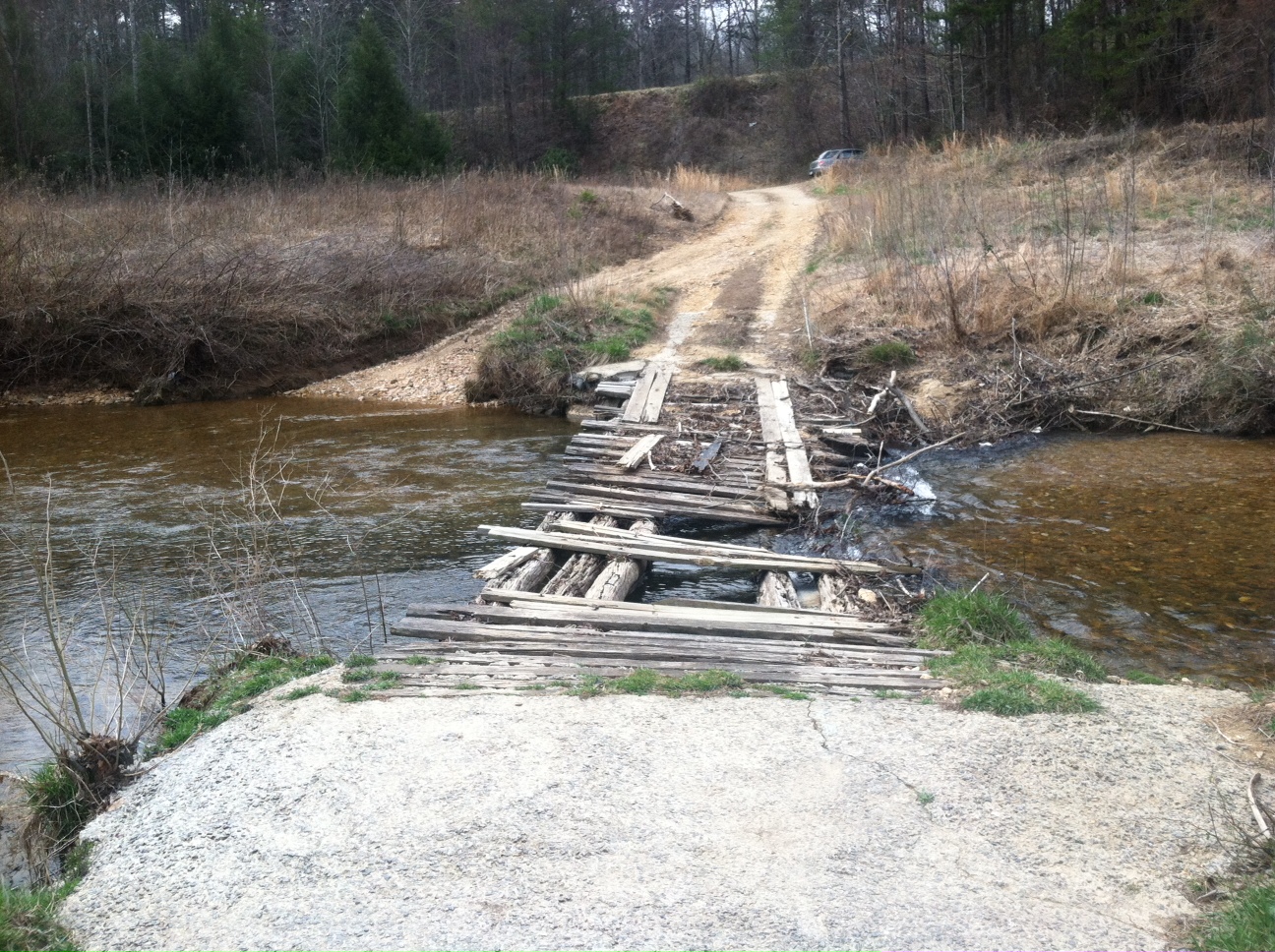

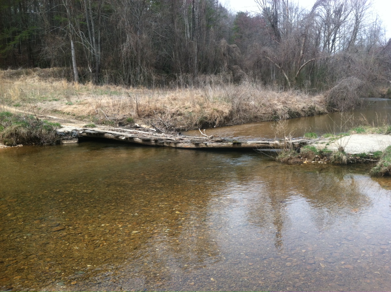

Update on the bridge project. Below are two shots of the original bridge built in 1946. These pictures were made just before we actually removed the bridge, now we just have a big hole in the river. In a couple of weeks the flatcar will be brought in to span the river. I will post pix as we move through the installation process.
   / I need a new BRIDGE!!! #49
Cool, thanks for the update!
   / I need a new BRIDGE!!! #50
Good to see what you've been talking about! That bridge looks like its seen its better days. Good luck, I can't wait to see the finished product!
