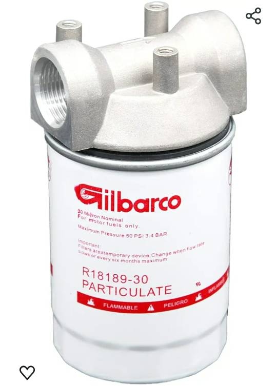

I use a 3/4" threaded TSC inline filter for my drum pump. The pump has a 3/4" female thread, piping ending in 3/4" male, filter, then 3/4" hose and nozzle.
   / I need fuel filter recommendations, for manual pump in barrel #3
Just a fuel filter screwed in where the hose attached then attach the hose to the other side of the filter. You may also want to put a water separator filter on as well.

I ordered one like the above.
