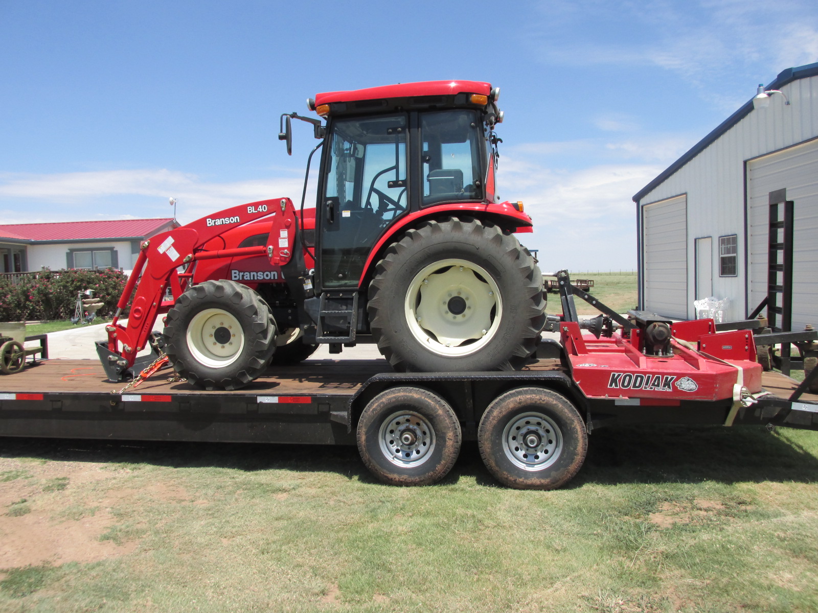

10k 20' (16'+4') deckover. Really like it... F250 pulls it just fine, tractor/loader/brush hog fit nicely. Pic is just after new decking this past summer.

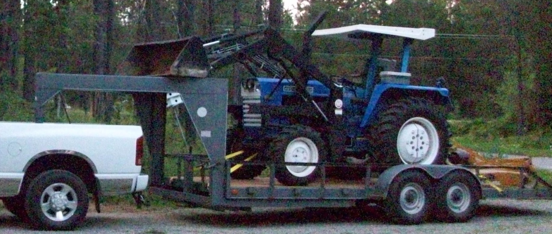

Sounds like you are looking for something like this- 20 foot, 10 k load tilt with rails.
Works well for my tractors but hauling cars there are times when its a (Dukes of Hazard ) to get out through the window. Also pulls really nice with the low center of gravity.
