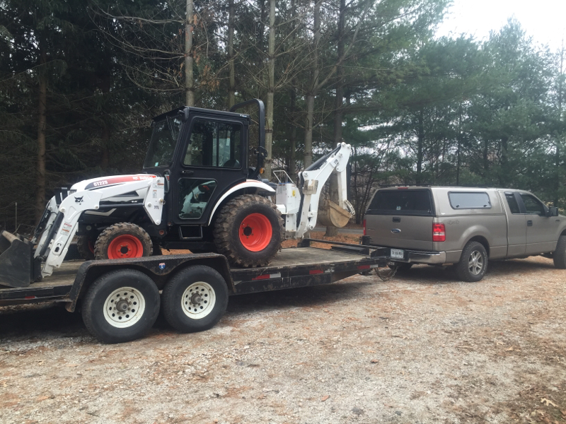

Well I had a chance to hall home the trailer my friend lent me a 14 k 20' bever tail and it sure does not hall like my 7 k utility. It feels loaded when it's empty. It must be very heavy, I loaded my tractor on a couple different ways and don't think that I will like it. It seems like the axels are to far back creating to much tongue weight for me. Glad I was able to try this before I buy.

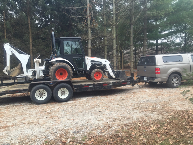

Another pic

Try loading the tractor backwards
   / I need help deciding on new trailer #35
Back it up some and put backhoe bucket on trailer, get some of the weight off of the tongue but not heavy in the rear. In other words distribute weight properly
   / I need help deciding on new trailer #36
Was thinking the same when I saw that pic. Back 'er up some, lower that boom and place the bucket on the beaver tail and strap it all down.
#37
I want to be able to hall with my bush hog on and take other attachments to. I have loaded it forwards backwards farther forward farther backward and every which way. I feel that this is just not the right trailer for this application. I can get the weight distributed more over the axles but then do not have the room to haul what I need to haul. It would probably be perfect if I was hauling something 11,000 pounds that fit right over the axles. The dovetail is nice for loading though because this trailer is much higher than my other. But it limits me as to where I put the machine with attachments on.
