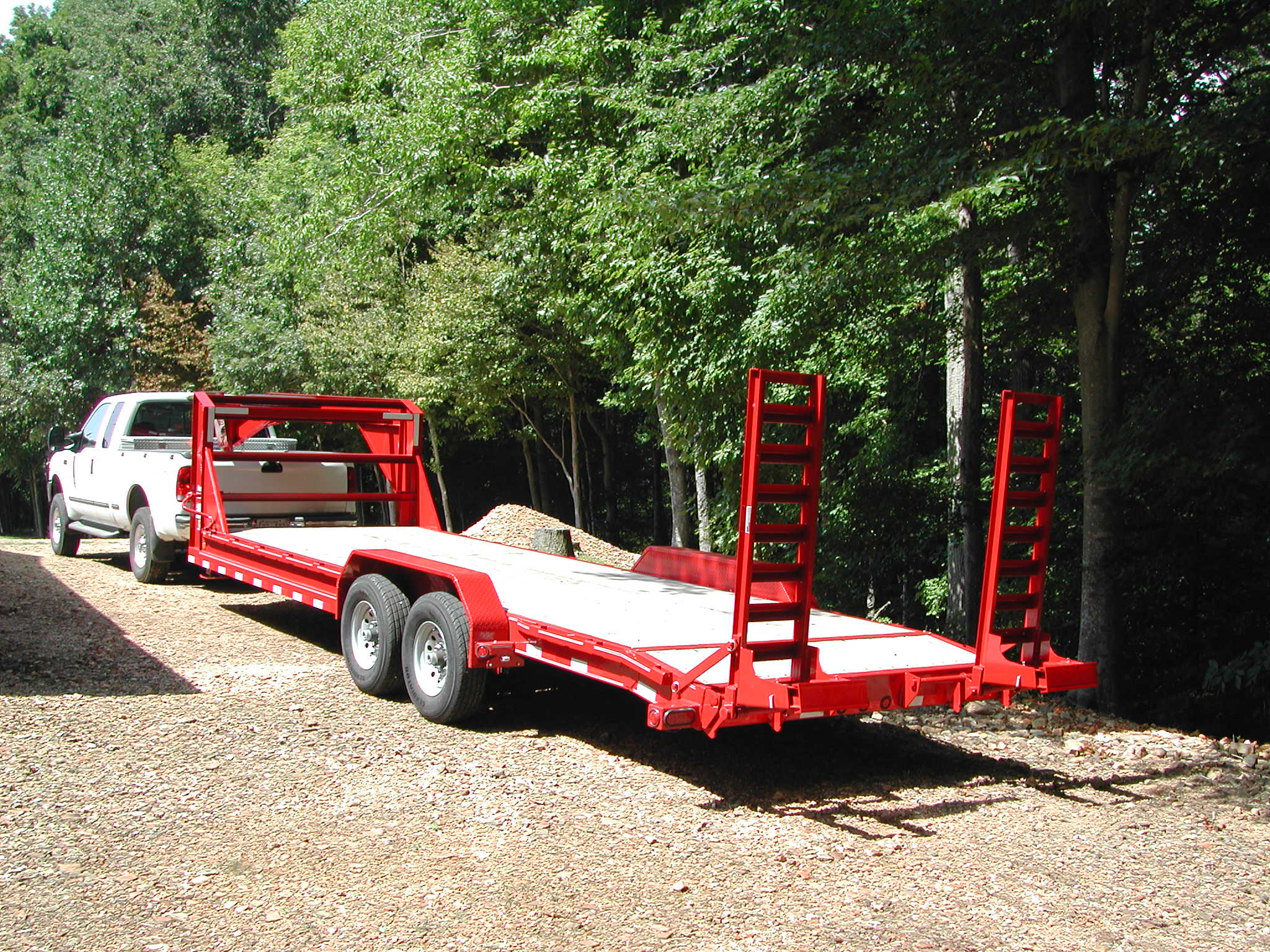

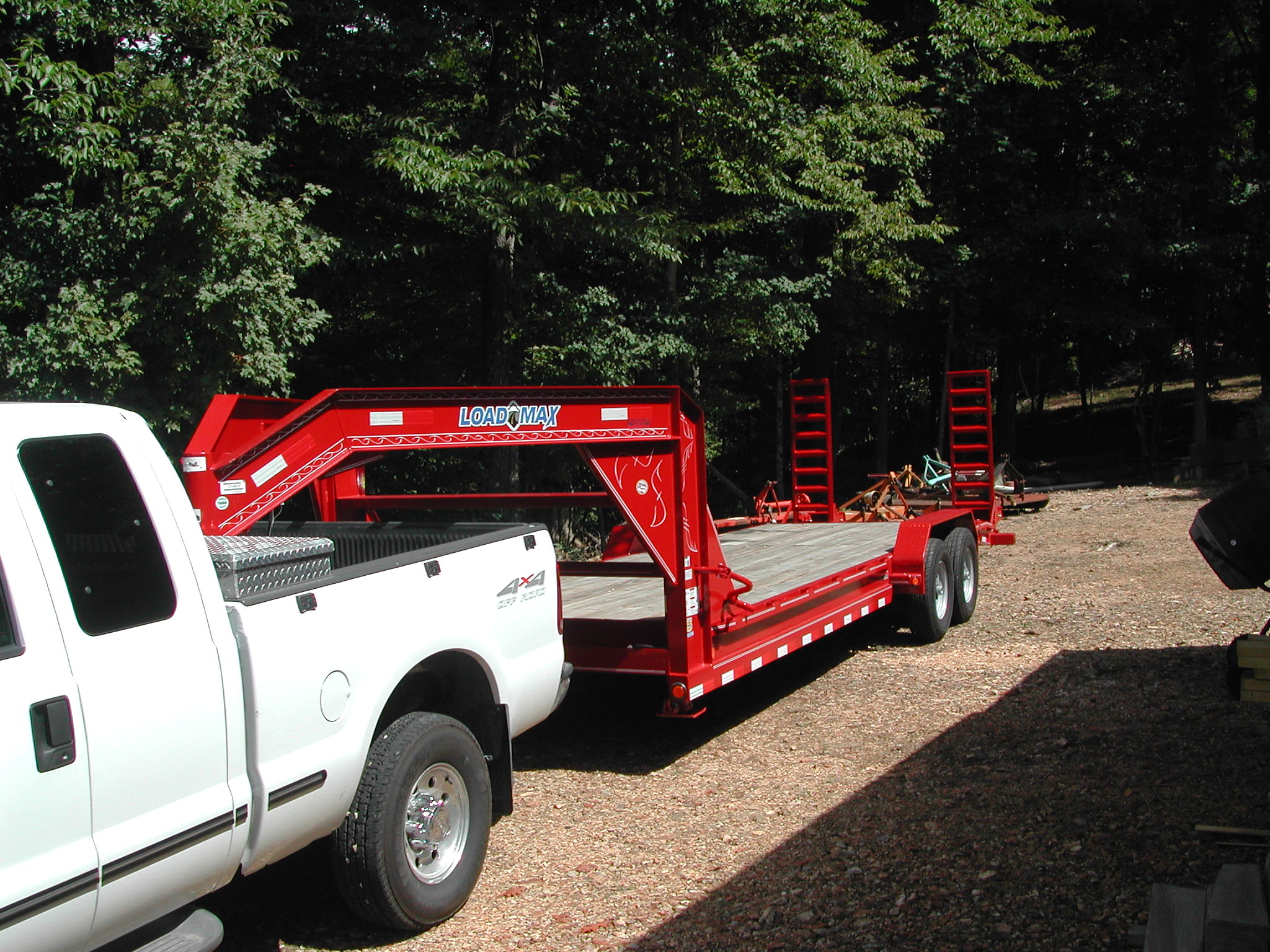

I purchased a new trailer late this summer after researching and looking at them at various places. I looked at BigTex, PJ, and various other makes and finally decided on my Load Max (Load Trail). I really liked the way it was put together and the features it had for the money. It's a 24' (22' flat, 2' dovetail) 14K GN car hauler type with 83" between the fenders that are also removeable. That worked very well when I had to haul a couple pallets of concrete blocks, the forklift had no problem placing the pallets where they needed to be. Would be very good for hauling cars as you can open the doors without problems - the tires are only a couple inches above the bed of the trailer. You could also drive a wide piece of equip. right over the tires if need be too.
The trailer is fully powder coated, has a one piece wiring harness, all LED lights, double-hinged spring-assist ramps w/adjustable feet, twin jacks. I haven't hauled my tractor on it yet but that's the main reason I bought it and I'm sure it will be just dandy. I hauled my tractor around commercially for about 6 years on a 20' 14K bumper pull. This will be the first GN I've ever hauled it with.
   / I need help deciding on new trailer #56

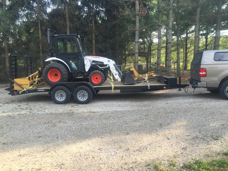

Here is my 20' flat deck with my tractor on it. With the implements on the front of the trailer i have to keep the tractor pulled to the back. WIthout the stuff on the front the tractor moves forward about a foot. (but notice it would still basically be rideing over the axles of the trailer)
Either way it generates about 800lbs tongue weight which i handle with a WD hitch.

I like that 20 ' flat deck what is the axel rating. That looks like a 2/3-1/3 axel split. I'm thinking I would prefer more like 60/40 for less tongue weight. What do you think?
