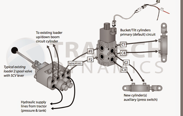

I talked to the parts guy and it is solenoid operated.
Give them call.
Should look something like this.
Flash. Flash
Sorry about that.
I called to verify and they told me wrong.
The one valve I posted is a lever selector valve .
This is supposed to be the correct valve. SKU: #220934 at $110
http://www.baileynet.com/product/9573
I pulled the pic from another web site.

Do you want a 3rd function valve or a diverter selector valve?
The 3rd valve will only provide full force, and is installed in series with the flow. Could be installed anywhere you have space for it.
The selector valve will let you use the curl function or the FEL to control the grapple and the ability to feather the hyds.

I am looking to mount a Fisher snow plow on my loader and want to be able to angle it and run all the loader functions when needed.
   / I need some information on a Third Function Remote #28
Ahhh... so the third function valve is either all on or all off. correct? I'm planning a grapple addition so I guess the diverter valve will be the way to go.
   / I need some information on a Third Function Remote #29
Yes. that is correct, however you could add an adjustable needle valve and tailor the flow to your needs.
Your engine rpm will also dictate how much flow the hyd has. Half speed, half flow, and so on.
The diverter is less expensive.
   / I need some information on a Third Function Remote #30
Thanks JJ. It seems that both ways have their drawbacks. The diverter draws from one of the function ports of the loader valve, temporarily disabling it. The third function valve is either all on or all off but I would still have full use of the loader controls. I guess i'm leaning more toward the seperate valve. It seems that if I buy the package from EA, they offer a little off. I'm still doing the numbers and trying to pick out which grapple I really want.
