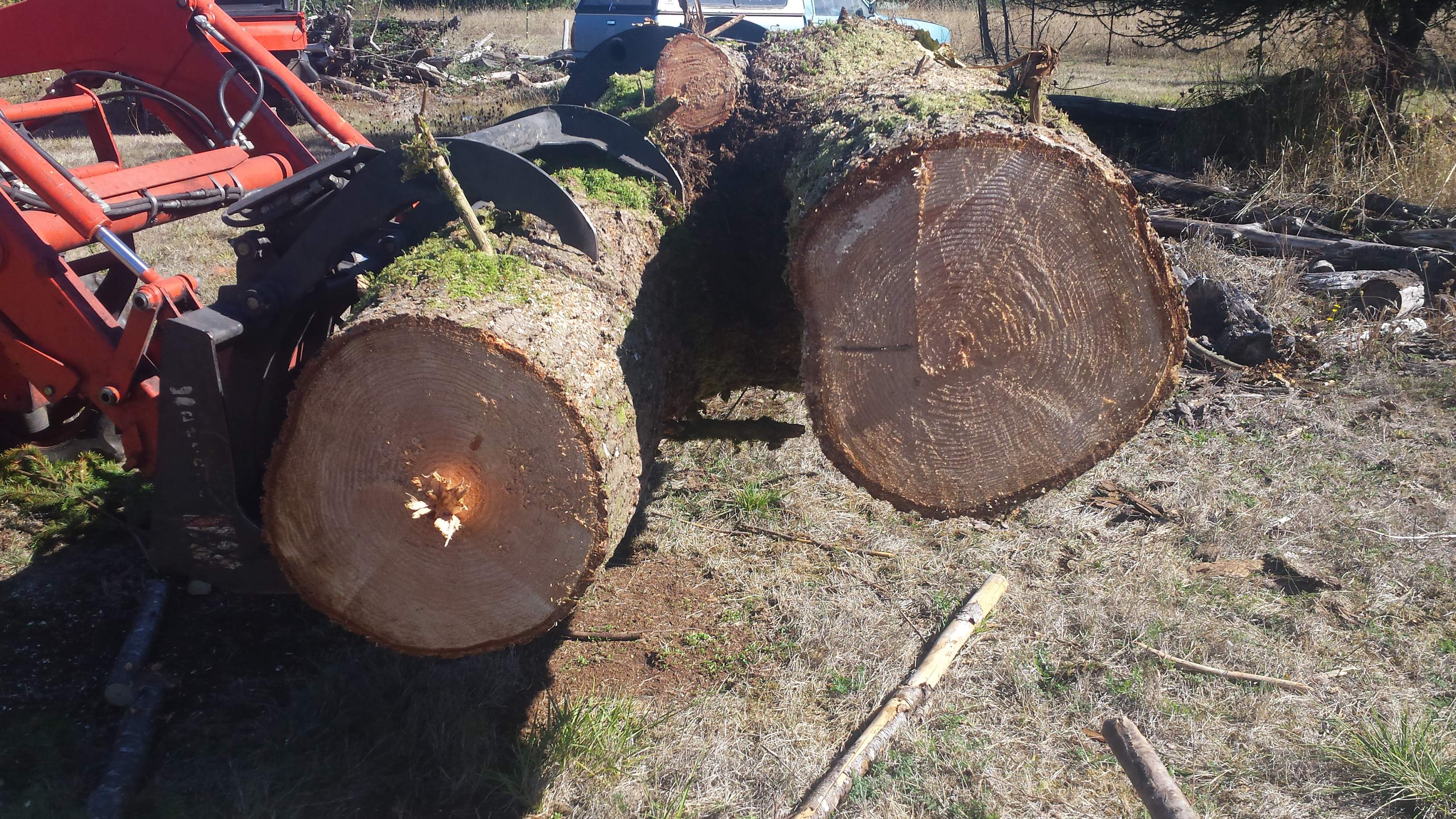

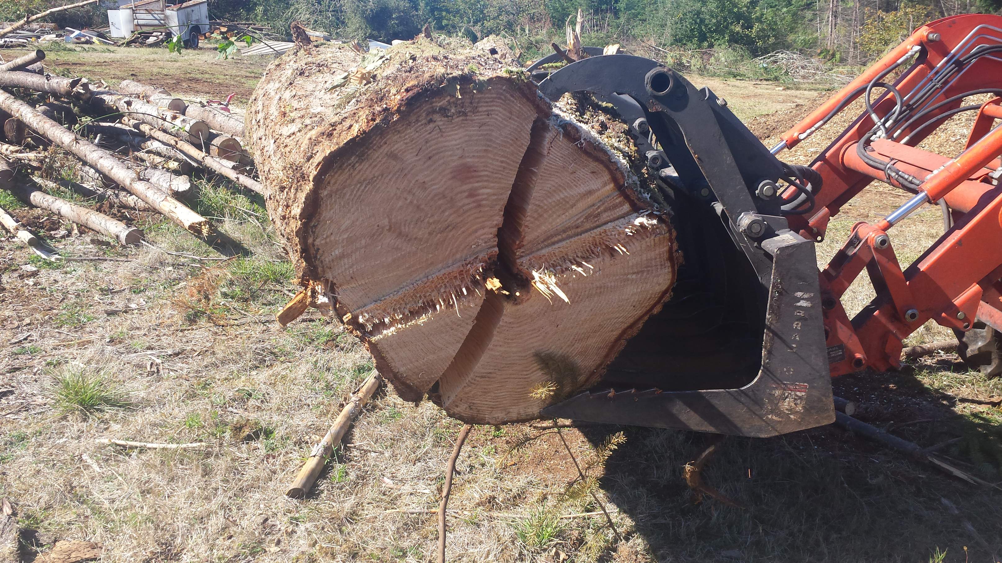

John - that's the exact setup I have on my B3300 and I've been really impressed. From a couple days ago:
   / I need some information on a Third Function Remote #37
Here is a wood chunk from the other day, having dual clamps is nice.
David Kb7uns
