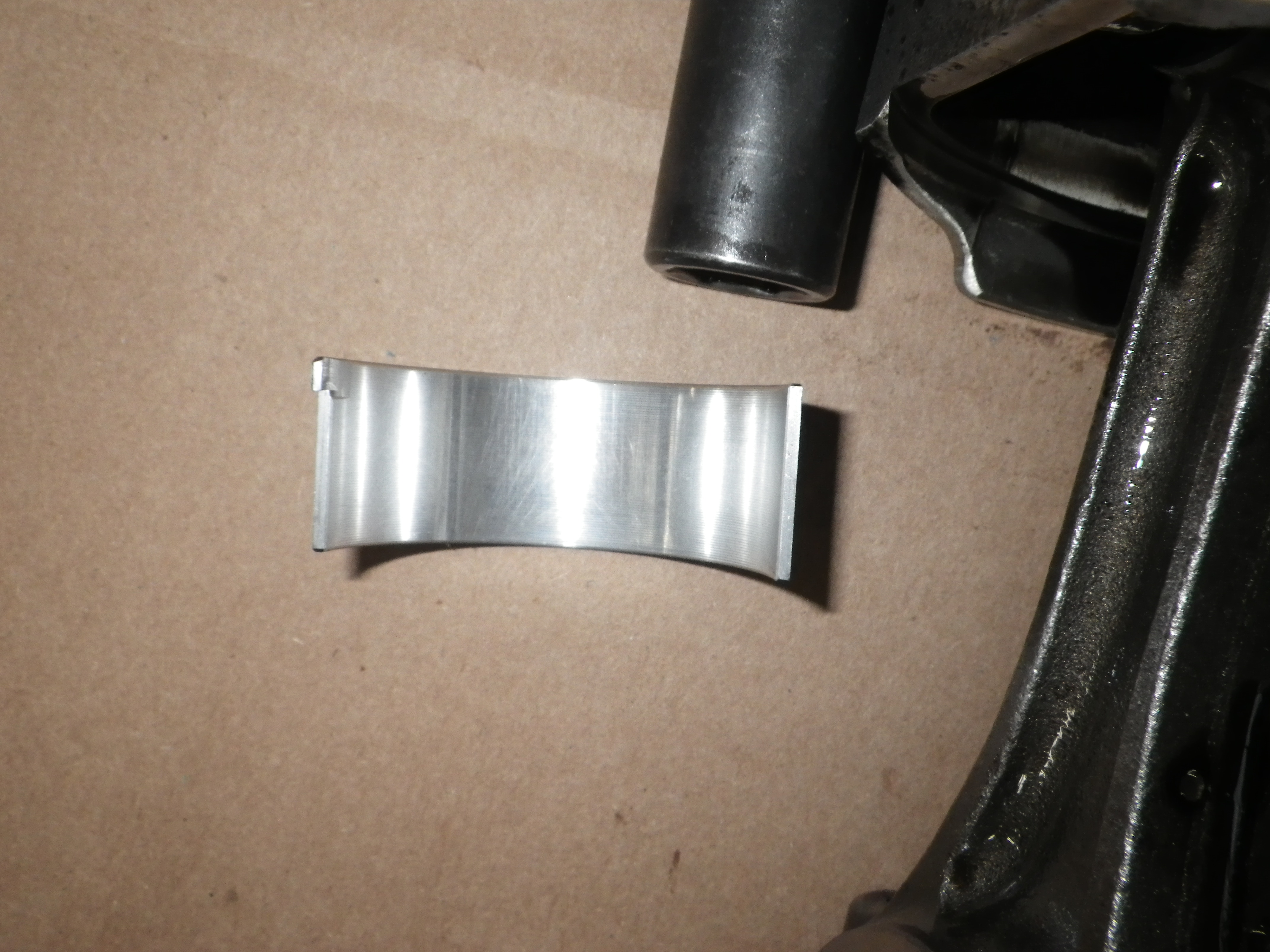

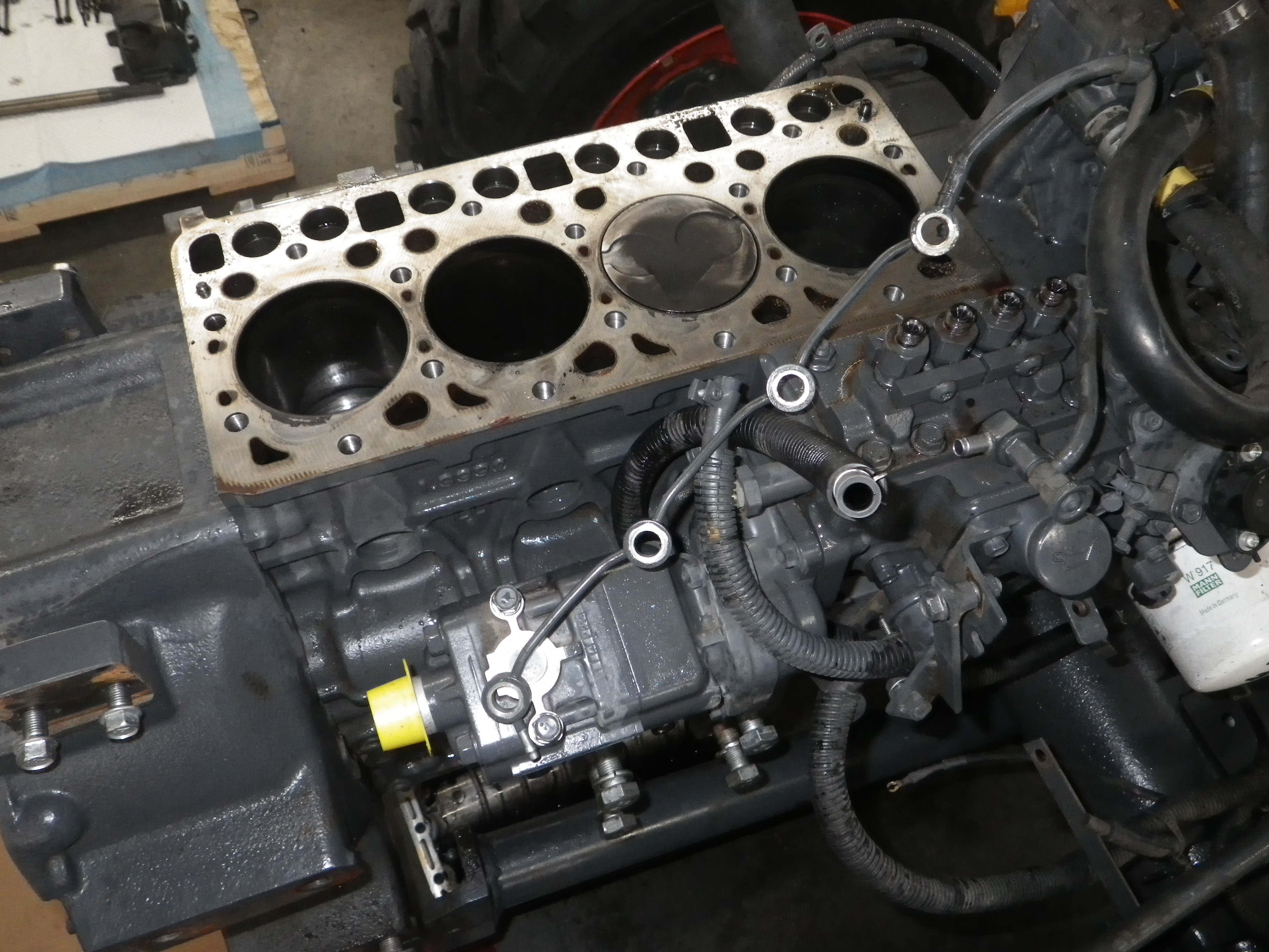

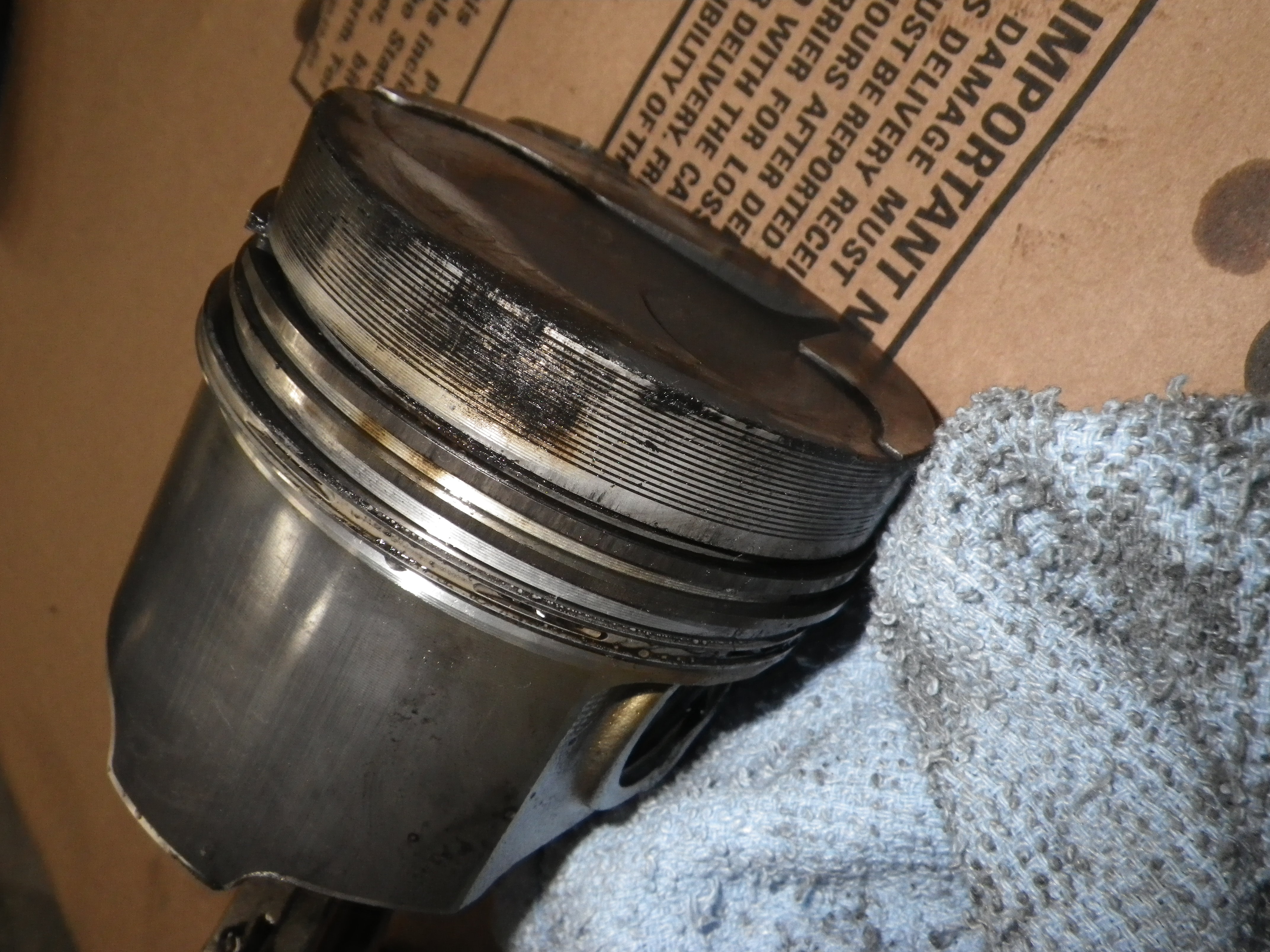

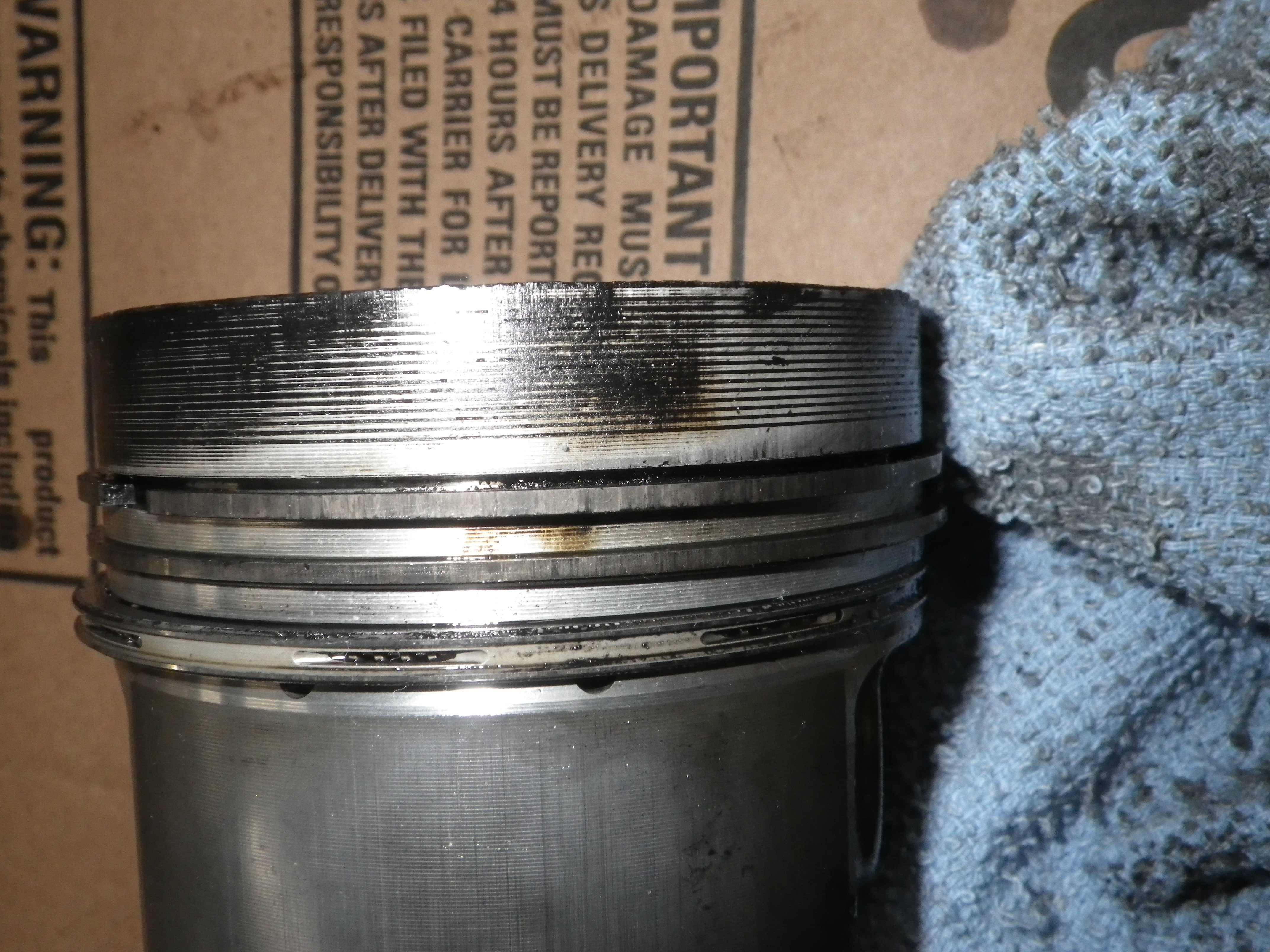

So my FWD shaft is bent and when I spin it the runout is about 1/16" which is quite a bit. I want to say maybe I bent it splitting the tractor but I have to say I was so careful it came straight apart very smoothly I just don't see how I could have bent the thing.
Motor has 2 cylinders with 8% leakdown and 2 with 40% leakdown so my plan changes. Pulled the head and the pan to find pistons are junk with the top ring land worn badly.
This is what happens when you over fuel and boost an engine not designed for it. The wastegate is set at 6.5 pounds (factory).
I noticed about 2 years ago the engine isn't silky smooth like it was when new, it kind of has a touch of a misfire. I was right. Glad I took it all the way down while it was apart for the seal fix.
Looks like I'll replace 4 pistons, rings and remove the turbo then sell it in the Spring because the power will be so bad. Rod bearings look like new.

Wow really did wear the ring lands badly,
wonder if Kubota uses steel ring land inserts for the Turbo spec pistons?
