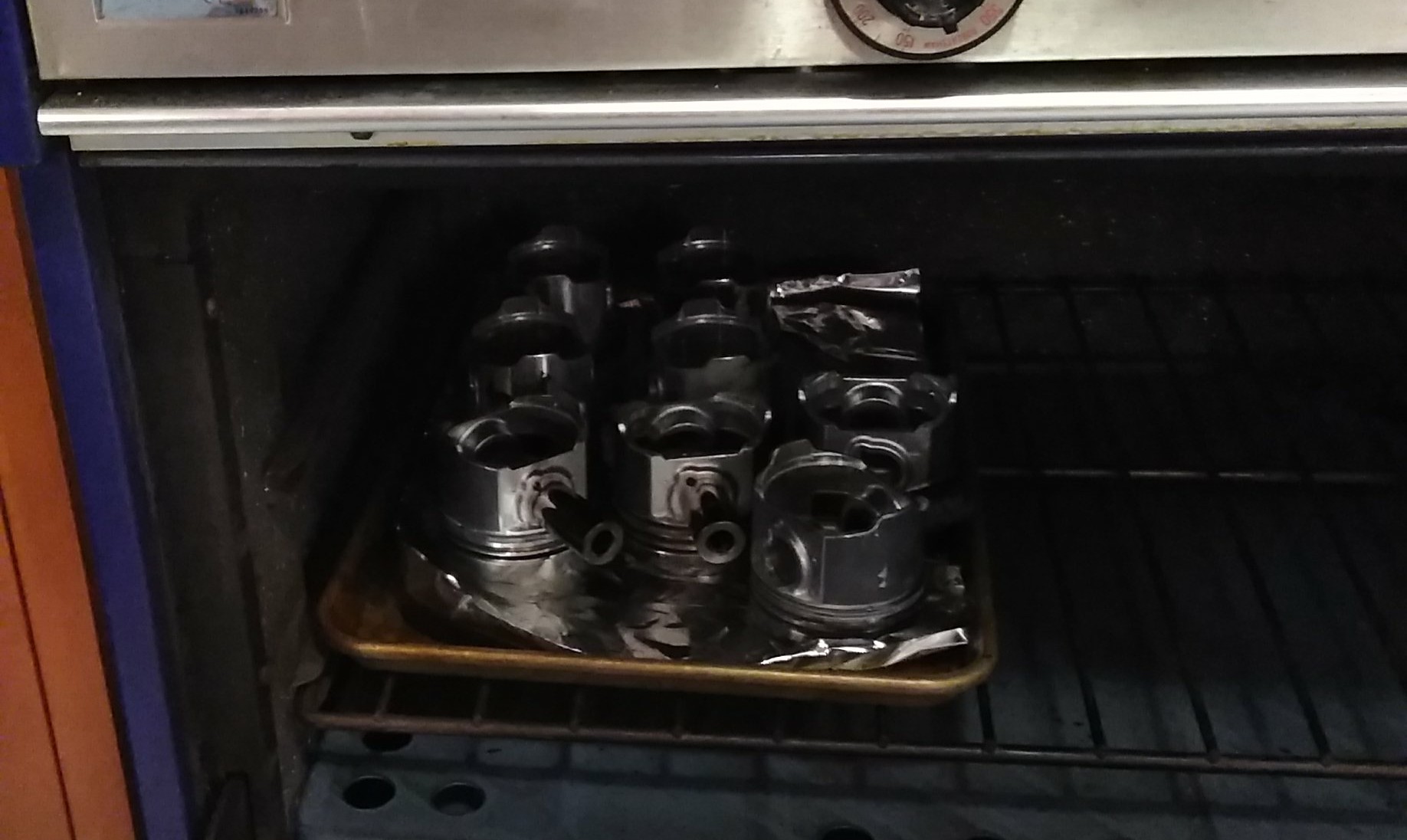

I've been tearing engines apart since I was 15 in the shop where I still work out of. I have most all of the measuring tools.
Also oversized pistons won't fit in to a stock bore.
If you read back through you'll see where I spent considerable time measuring these new aftermarket pistons because I don't trust them.
I called the supplier and they are made in India, they said they would refund my money after they look through some pictures. I don't care about the money it's the time I spent fixing it once.
I haven't taken time to clean or heat one in the oven to see if it expands too much.
Obviously I'll post results when I find time. I'm still trying to dry my clothes out after last night's open station snowblower experience!:smurf:

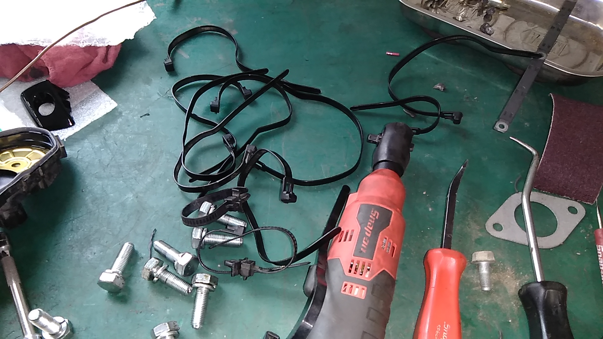

I just realized, this morning, why Kubota uses reusable zip ties. Heated all pistons to 350f, they all measure the same, nothing makes sense.
