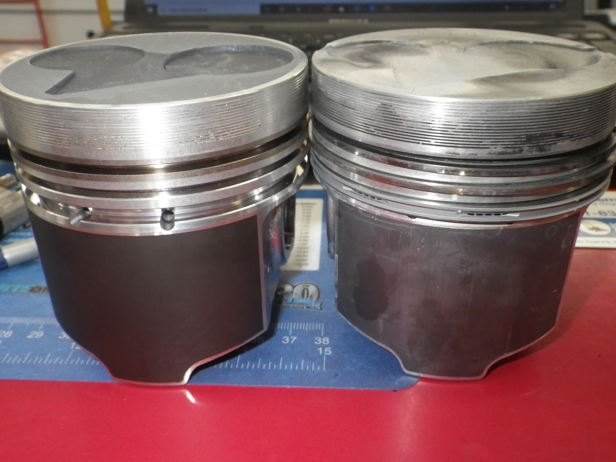

Finally called a Kubota engine dealer who knew exactly what I am up against, they tell me that Kubota uses a heat treated piston on the V2003T engine.
Comes in a complete kit with gaskets for $1300 bux. I said sign me up and out came the credit card again.

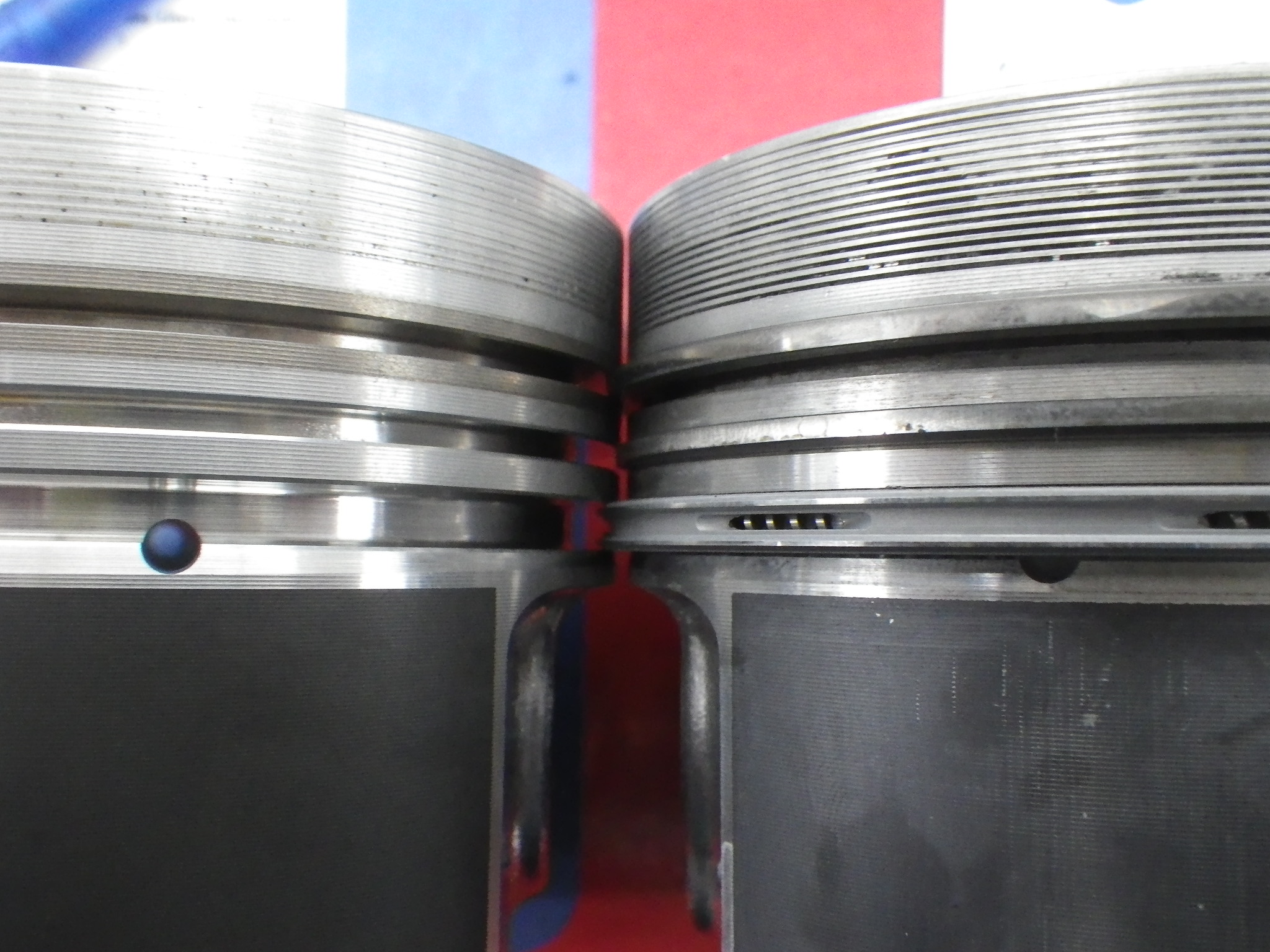

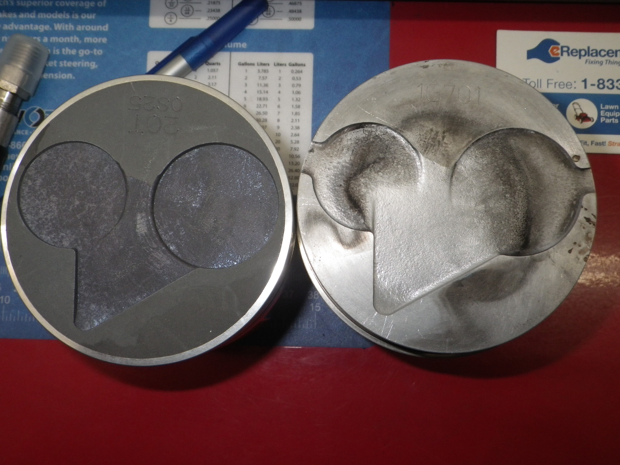

Did they explain what the heat treatment was for? Strength, dimensional stability, etc...
Does the T in V2003T mean its for a Turbo application? Did they say if it will have the steel top ring lands you desired?
One would think the other piston supplier would pull their pistons for this application or change accordingly.
Hope these are the solution for your troubles.
   / I Still Hate My Tractor II
#475

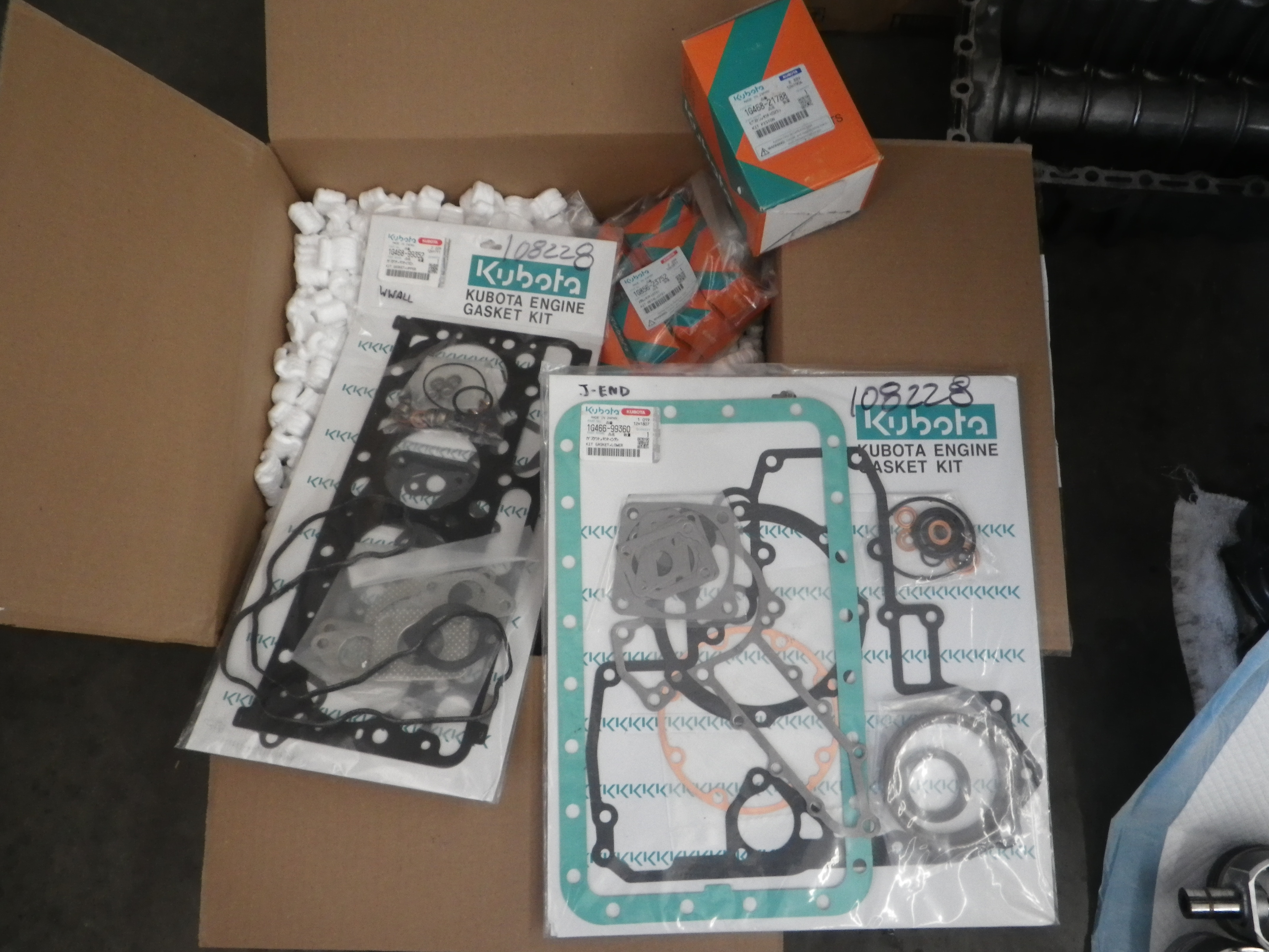

Kit came today, all pistons, Bearings, seals to rebuild this thing.
Turbo pistons have a different top and the upper ring land is steel or hardened whatever. IMGP0281.JPGIMGP0282.JPGIMGP0283.JPGIMGP0280.JPG
Looks like the turbo goes back on this lemon. I had no idea one can purchase the whole kit quite a stretch cheaper then buying just pistons and gaskets from a tractor dealer. What an eye opener.

Any chance you can post where you got the kit from?
#478
Kubota Engine Dealer for New or Remanufactured Engines & Engine Parts
I called one Kubota engine supplier in New Jersey they never returned my call. I've been Googling far too many hours trying to find info and these guys are on Ebay so I figured one call wouldn't hurt. Scott there knew exactly what I needed. I knew somebody made better pistons for this thing.
