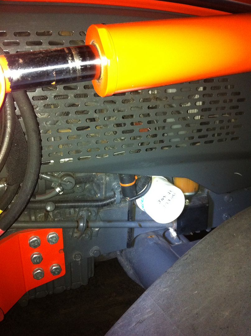

Tight fit for the oil filter/hood. Not sure what to do here. Looking at parts online shows L5740 same oil filter adapter. Wondering if the hoods are way different in this area; they are 1 part number off.
Any replies considered, except torch :)
How about a thin piece of soft foam rubber glued to the hood?

Looks like your filter does not stick out very far.
Wondering the difference, my oil cooler adds 2 inches exactly to the whole package.

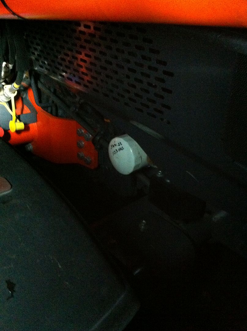

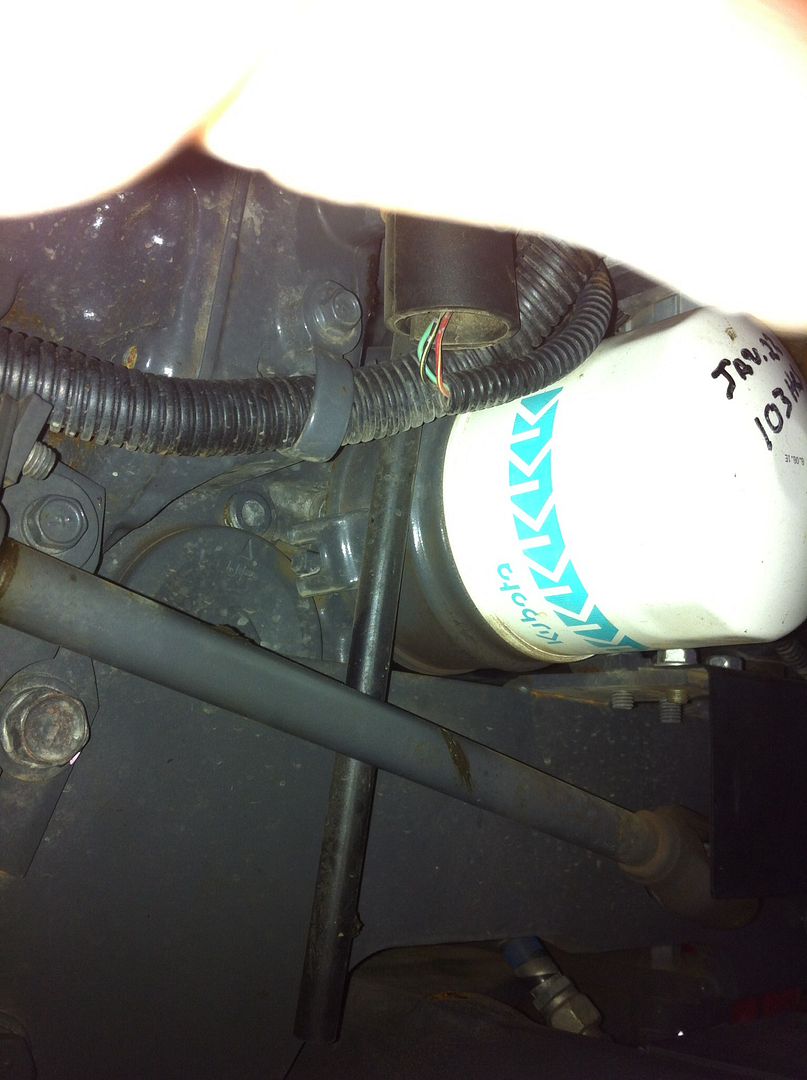

Fred I snapped a photo of the filter on the 5740. We had a storm here today so I was just to busy to get anything else done.

I will wait on hacking the side panel for sure; great advice. Sometimes it's a good idea to back things off and think about them. I wake up in the middle of the night and a new idea pops into my head pertaining to a problem area. Thanks for the side panel shots, they helped a bunch.
My side panel will get pushed out 1.75 inches with the cooler setup, foam won't work.
