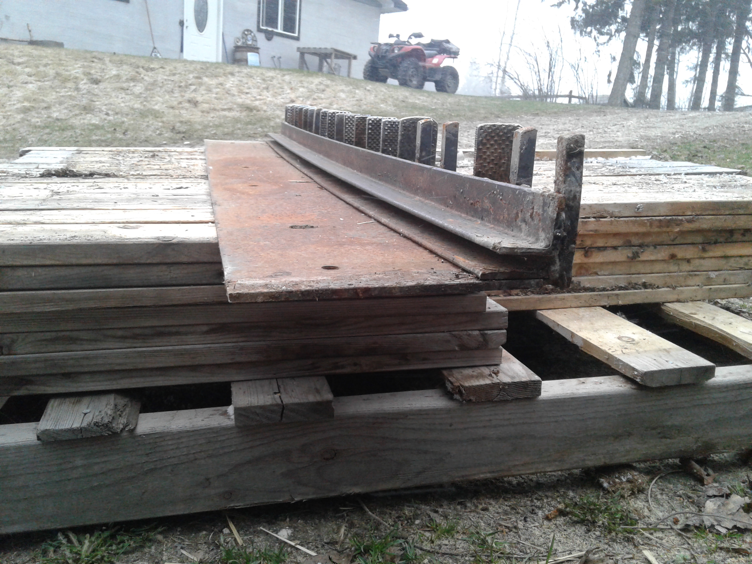

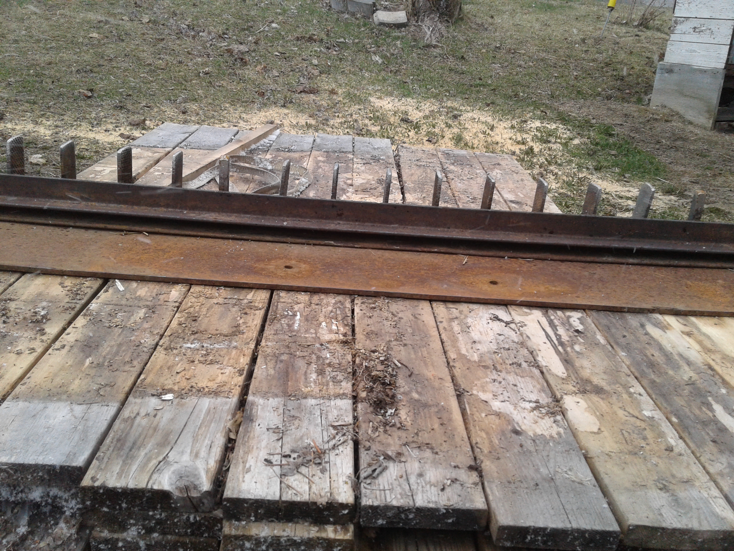

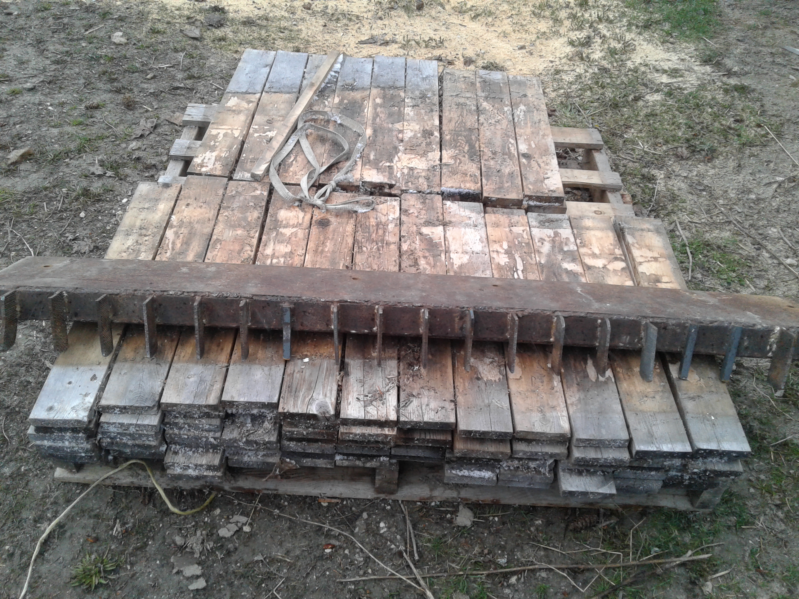

I built one a couple years ago as we end up with lots of ice on the drive and parking area even in the horse pen . Just used metal i had around as I wasn't sure it would work and didn't want to spend a pile of money. I used old ferrier rasps some were a little more brittle and snapped, i replaced those with 3/8 " stock those wore a little quicker tho. It just slips over the cutting edge and 4 3/8 " bolts to hold it in place. I just put a little pressure and back blade .
